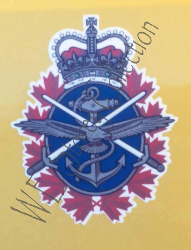

I have a friend 3d designing and printing me a GMC M135 2.5 Ton truck as used by the Canadian Army in the 1950's. I am attaching a photo of the colour scheme I would like to use but am having difficulty with the insignia on the door due to the angle.
Does anyone have any input as to what this insignia looks like as it seems to be very similar to the one used after unification?
Thanks in advance.

Neil, the M135CDN was used by the Canadian military for three decades so the vehicle type has carried a myriad of markings during its lifetime. The markings on the door of the vehicle in the photograph you provided is the Canadian Forces tri-service badge. This was a decal that was produced in various sizes to apply to the doors of vehicles that were generally considered to be used for non-tactical purposes, although they were certainly used on some of the SMP fleet, which I suspect were vehicles held by schools.
I always recommend using a photograph as the basis for any vehicle markings but at the same time knowing what the markings represent and the era they were used is also key as I have mentioned, the topic is very broad.

Re the tri-service decals, I remember that the sigs trucks had them, where the average militia and reg force trucks, with their 20 coats of cam paint, did not. I also recall seeing the decals on some of the deuces in Borden, which as Ed says, would be more administrative or training as opposed to field force.
