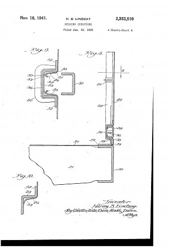

And a further search even yielded Mr. Lindsay's patent US 2263510 A!
1941- H. B. LINDSAY HOUSING STRUCTURE 4 Sheets-Sheet l Filed Jan. 26, 1938 Nov. 18, 1941: https://www.google.com/patents/US2263510
It contains interesting notes on its construction and drawings.
Hope this is of interest,

I guess you're right as Harvey B Lyndsay writes in his patent application: "The invention has application to a wide range of housing structures including refrigerator structures especially of the transport type, and passenger and freight car bodies." (my bold). Lindsay's other patents are also related to refrigeration, or rather, insulation.
PS: it seems Google's algorithms aren't so smart as we all think, as they would show far fewer compound curved Lindsay bodies - that was the beauty of the Lindsay Structure body, subject of our discussion here
