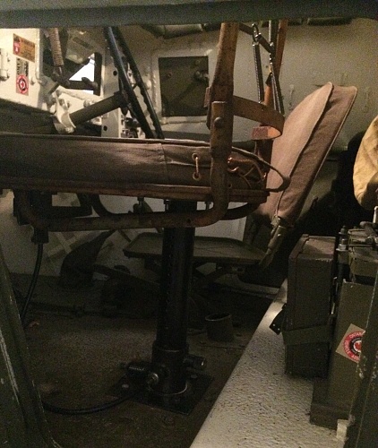

Guys,
Finally saw the light and turned the seat base and raising/lowering mechanism over to Andy to dismantle and rebuild. Here's what it now looks like. I did get a NOS spring from LWD, the pile of rust is all that remains of the original spring. Decided to rebuild a conventional CMP seat since the correct seat seems to be "unobtanium". Should I ever find the real thing it would be an easy swap.
Peter

Guys,
Andy performed to his usual high standard and fabricated the lower portion of the Gunners seat which allows the seat to raise/lower and rotate. Unable to find the correct seat I have substituted a conventional CMP seat which is the same as the Driver's seat. Now for sandblasting, paint and some new seat cushions.
Definitely makes the crew compartment feel tight. Peter

Default Gunners seat
Rick/David,
My understanding of the Observers/Gunners seat is that it went through several evolutions during the development of the the Lynx. The seat that you have Rick is the first version and the second drawing is of the later version. I was able to replicate the raising/lower mechanism, but the seat base pan and back was too much of a challenge. I elected to use the Driver's seat which uses a conventional CMP seat mounted on a unique raising/lowering mechanism as a model for my Observers/Gunners seat.
Peter

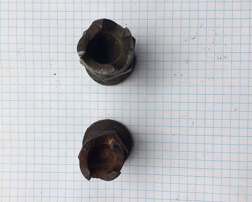

Guys,
Had a great weekend at the Aquino show at the Ontario Tank Museum, networking with the folks from the OMVA and participating in some of the field events.
Found that I still have an issue with a front end shimmy at speed over rough ground.
This took a back seat when I heard a disturbing sound when parking the Lynx at home. Poking around I found that the double drive pulley that is bolted to the end of the crankshaft had come loose and allowed the fan blades to brush up against the radiator. Fortunately no damage to the radiator other than removing some paint.
Now to find a better way to secure the ratchet bolt.
Peter

  #863
Old 24-09-21, 03:04
Posts: 7,592
They didn't have it back then, but we have it now: Loctite.
  #864
Old 24-09-21, 10:11
Robin Craig's Avatar
Posts: 2,161
Dear Peter,
Despite being at the same event you and I have not talked since.
Watching you in the arena while we were waiting to come in, the death wobble in the front end was only too visible to myself both times you came around. I can only imagine what it was like to handle. I wondered if tire pressures and or the tire size itself or construction had any part to play.
I ask this as the Supacat ATMP tends to be driven too fast off road by users. There is no suspension, so the tires give a bounce which can be violent if the right speed is achieved, operators have to be mindful of that.
I agree with Rob Love, Loctite, I use that $%^& on everything (appropriate strengths of course)
Robin Craig

I use the same 1050x16 tires and every now and then I get that wobble. Then it goes away. Haven’t really found out why but the only thing that was different is that it was soon after I used a tire shine to clean up the tires. Maybe sun on one side. Still a mystery to me as it comes and goes.
  #866
Old 24-09-21, 17:50
Posts: 4,162
Glad no real damage was done to the radiator. I echo what Rob says about Loctite. That should keep the bolts from backing off. I think your other alternative will be constant pretrip inspection of them to make sure everything is tight before hand.
As for the wobble. Do your steering knuckles use the New Departure pivot bearing with shims? Going by some of your pictures the basic steering knuckles look very similar to the CMP ones. Is there any side to side play on the wheels if you jack up the front of Lynx? When I rebuilt my truck I was sure to follow the step by step instructions in he manual for getting these setup with the shims.

Guys,
Thanks for all the comments and suggestions, I can definitely use them.
Dry fitted the ratchet bolt and didn't like how tight the bolt sides were to the dished end of the double pulley. Not enough room to use a socket without shaving it paper thin. The bolt head was 1 3/8".
I rooted around my meager but growing parts bin and found a ratchet bolt which was 1 1/8" across, the threaded portion was identical to the first one.
After a good cleanup it will be installed with some medium locktight.
Once the back end is buttoned up the focus will shift to the front end and the shimmy problem. I suspect this will be more challenging.
Peter
