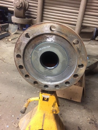

Jordan Baker posted this photo of the modern inner axle seal on his C15A.
Posted here so we can see what an inner axle seal looks like
