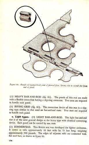

Hello,
Here is what I have (taken from TM 5-255 "Aviation Engineers" April 1944)
ID:	136944 Click image for larger version
https://i.imgur.com/8QClZke.jpg | https://i.imgur.com/5LFtP0g.jpg
Hope it helps,
Patrice.

Will need to post pictures of the ends on my mats which are slotted and offset in height to ease connection.....Got mine from Robin in Kingston.
Thanks Patrice that manual TM 5-255 is a good clue for more research.....

Old 29-01-24, 23:04
Posts: 5,222
Default Un gros Merci Patrice
...found the publication and was able to download.....
Bob C
PS...lots of bed time reading.....but...... the USA pattern does not address how to tie them end to end which must be a later version or other country..... maybe UK????
with the help our resident engineer .......Grant will design something!!!!!!!
