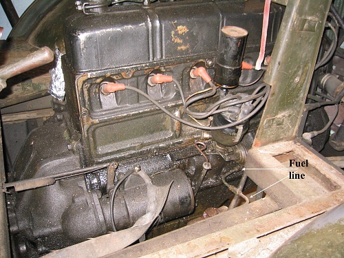

Phil, any chance on some pictures of where the fuel line was run in your C8a from the fuel filter to the fuel pump
Hi Jordan
Would you believe out 5000+ photos from the HUP restoration I don't have a good photo of the fuel line routing. It is just one of those hard things to get a clear shot. Was hoping I'd taken some shots with the fuel system mounted to the chassis before I lowered the body back in position but apparently that's something I missed. So here are the two best shots I could find.
My HUP has a solid line from the chassis to the fuel pump but I think it should be a rubber flex line. Memory is telling me there is a service bulletin about changing the fuel line will have to look through them and see if I can find it.

Phil, thanks for the extra pictures. I totally understand about not having certain pictures.

Hi Jordan
With the flex of the cab 13 anbd tyhe CMP frame flex lines are good insurance.
Doesn't matter what angle and how many pictures you take you will always find a spot you missed....
From what I have of what is left that is deemed possibly original the selection valve had three flex line in and out ..... and some of the frame filters had flex lines,,,,, and there was always a flex line entering the fuel pump with the hard line clipped to the frame and on to the filter. So you are only critical at the pump just replace the short piece. the out put of the pump can be hard line as it is clipped to the water/radiator elbow .....and therefore moves with the engine block.
One line strangely enough that is subjected to engine torque yet has no rubber joints is the steel steam line from the rear of the block to the radiator neck or tank.......
