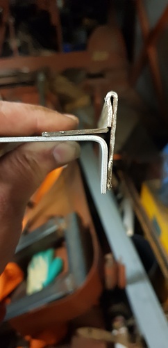

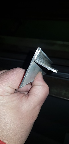

It's been a while , since my last post ( could be a line from an AAA meeting)
And did some reorganizing, finally decided to move my HUM body from one place far from home to a new place 10min from home so that I have more time to work on it under supervision of a expert chassis builder.
Earlier I told you about bending the omega profiles for the roof supports.
In the meantime they have been assembled and now newly placed and they look absolute bang on
23755089_1543382175710600_696340208705496801_n.jpg   23794887_1543382219043929_3386398736645960914_n.jpg   23843487_1543382125710605_9059343336839545975_n.jpg

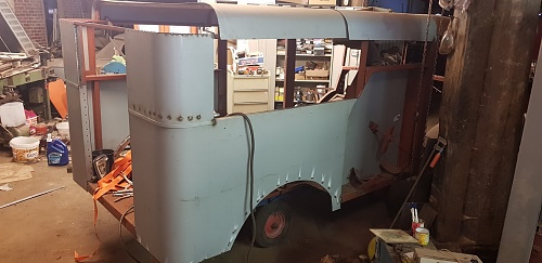

Main progress on the body.
Side panels are added to the frame and we are now working on the roof and specially the hatch opening.
I managed to reproduce the hatch structure and we are now in the progress of adding the hatch frame to the roof.

Wink Body and frame mounted

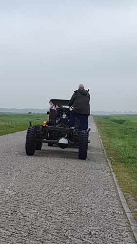

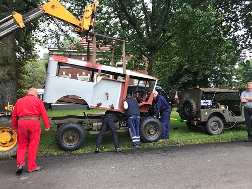

This weekend was showtime we mounted the Body and Frame after years of seperation.
What seemed to be an easy fix turned out to be a little more tricky than we thought, the handbrake lever was in the way and so was the shifter lever.
We had to dismount the handbrake and tilt the body over the shifter lever..glad we had the right equipment.
The tow to the location of the body was also memorable
I have added some pics , enjoy

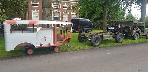

Some more on the mounting of the body
The grand old lady is now back in the Garage with only inches to spare

  #113
Old 13-09-21, 14:59
Location: Clinton Ontario
Posts: 413
Default body on
Congratulations Pieter for mounting the body. Now the fun part of restoration starts , going ahead and seeing the vehicle become whole and complete.
Gord

Originally Posted by 8threcce View Post
Please see the pictures of the hatch lever that is located outside the hatch and inside the slide rail (a simple U profile)
You can see that the ball part has extensive wear and is flat on one side.
All levers on the hatch I have are having this flat spot which indicates to me that these ball didn't roll but just slide .....is this correct or should they indeed roll which seems obvious to me ...did any of you ever made new levers ?? I'm wondering with what I should replace this ball, seems to me that it's hard to make or to obtain as a ready made part......any suggestions welcome
Congratulations on getting the body back on!! It's a big step and all 'uphill' from there.
Going back to the sliding roof hatch in this earlier post, this is where I am now, remaking the tubes and levers. You had asked whether the bronze ends should roll noting the flat worn side. I think they should roll but were probably very quick to rust solid being where they were. Did you ever sort out for sure if they were meant to roll? I can't get mine to move no matter what and will have to drill them out and replace the rivet/axle if so.

Old 13-09-21, 16:45
Posts: 14,815
Hi Pieter, congrats on the important milestone of the "marriage" of body and chassis.
I love the fact that it was done on the side of the road - just like the RCEME would have done!
Bruce
I have an early 1942 HUP that has the rollers with the flat spots. I think the original roller was bronze and quickly stops turning I had a good friend turn me up some brass rollers for replacements. The truck was finished about three years ago and is always in a dry well ventilated building. I just went and checked to see how free the rollers were and I think its a design flaw. There isn't much "leverage" on the roller to make it want to move and they will probably end up with flat spots any way
Gord

Default After 14 years the HUP is found road worthy
Dear MLU friends,
I am aware that some of you are not on the FB MLU site, so I am posting this message on here.
There are still some small details to address (where the devil is), but after 14 years, my HUP restoration finally concluded last Friday. I have obtained the Dutch registration and roadworthiness certification.
When I reviewed my documents, I realized that I had purchased my HUP in 2011 without fully knowing what I got myself into.
It is with deep admiration for this forum and the MLU community that I want to express a warm thank you to all of you who have supported me along the way. The list of people that I hope to call friends by now is too long to mention individually, but you all contributed to motivate me to continue the build in good and bad times... and boy, it was tough sometimes.
The MLU community is very much alive, as I noticed again last June in Normandy at the vehicle meet. I thank you all for letting me be a part of it.
Many many thanks for all you have done
Pieter Bergman
