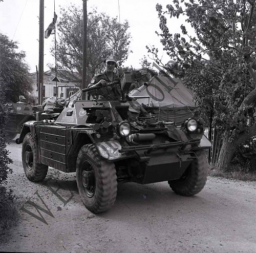

David, context is key when analyzing a photograph and the colour photograph shows a Ferret which has recently arrived in Cyprus still sporting its Canadian markings. The white, I am leaning towards yellow Lazy Ds, are what was painted on the squadron vehicles for UN service as seen in this photograph.

Hello and thank you Ed for the photo...I didn't have that one...

Hey Ed maybe your photo is more clear...can you make out the cfr number on that ferret? Thank you.

I have the negative and unfortunately with the driver's head in the way and the small size of the numbers, it is just not possible to read the CFR.

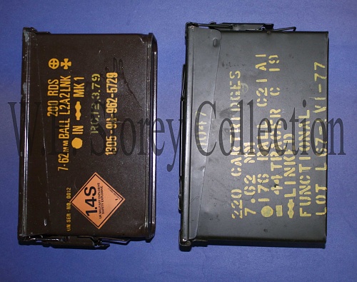

When I got 589
it was pretty much empty inside....over the years I've collected parts and filled it up....I know the ammo boxes are U.S. ....I may paint them chocolate brown....wish I had the jump seats....but the ammo bins were a modification that started in 1965....it's not easy to get one back completely original...photos of inside are very very hard to find..just working with what I have for now...I love all the info...thank you all.

The first thing I would suggest is deciding which year you wish to represent as that will dictate the various modifications and vehicle markings. Just looking at the photograph you provided I spotted a few things that I would suggest changing. The camouflage net is not required for UN service and the ammunition box on the back fender should be replaced with a British water Jerrycan. Your ammunition boxes should be British H84s which are slightly smaller and constructed differently from US M1 or M19A1 cans. I also see British water bottles in your Ferret which were not used by the Canadian Army.
Name:	Compasison - M19A1 and H84 Mk I Ammunition Boxes - Stencilled markings [1] copy.jpg
The markings on my H84 Mk I are later than those used in 1965, but the can design did not change and this is a comparison image with a Canadian marked M19A1 can.

Thank s Ed for all that info and photos...yes the camo net I just had..and there is where I used it...same with the u.s. ammo boxes....if you noticed I do have a pair of sand channels...very few photos show Canadian ferrets with them...but I do have 2 photos from Egypt...the .303 ammo box on the rear I had....with the m series side lights..you can't put on a water can....some were installed higher up...out of the way...very hard to track down fire extinguishers and brackets...I have all 3 ansuls...but they are 1970s....in old photos...looks like they changed them like to what ever the could get at the time....would love to find or have reproduced some roadrunner decals...no great photos for that...

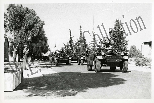

I'm out! Egypt and Cyprus were two different missions, mixing and matching fittings and markings to suit a personal taste is not accuracy.
Name:	Ferret Drive Past - RCD Cyprus copy.jpg
No camouflage nets or Roadrunner markings in this Cyprus photograph from 1965.

Thank you Ed for the photo...I'm wanting to restore 589 as it was in Cyprus...1960s....just doing the best I can and learning from you guys up north...best to you..David
