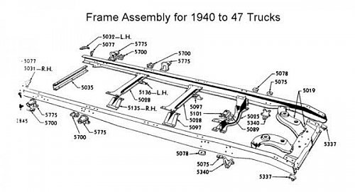

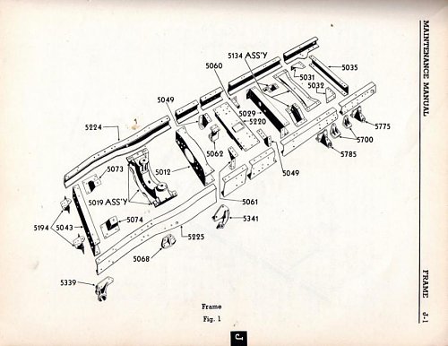

I think the gearbox mount on the M/H is similar to the Ford CMP where the back of the gearbox is bolted to it.
I believe you're right Cliff, and I'm pretty sure the engine crossmember is similar too. Perhaps these crossmembers were associated with 4WD conversion, for increased frame rigidity. However I'm not familiar with the commercial chassis range so it's possible they were used more widely. The CMP chassis frame was standardized throughout the range, and as Keith says it shared no commonality with the commercial chassis frame.
ID:	66347 Click image for larger version

Sent you some chassis layout drawings and photos Cliff.
You are correct Keith. It uses a standard Ford civvy chassis but with extra cross members for the transfer case and mods to strengthen the top of the transmission xmember to compensate for a section removed on that xmember to allow clearance for the front prop shaft. The chassis rails are double channel for most of their length. Great rust breeders.
