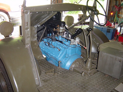

I found these photos of the V8 I got from Brian Asbury. It needed a lot of work but those are the manifolds that went into the restored truck, Clearly the left is different from the right. It was a cab 12 by the way.

Yes still have the parts and available for the same price to MLU members.... you only had the RH side exhaust manifold which is clearly the larger size and stored in the barn with the spare head...... our cab 12 Ford would have had the wider frame.... the F8 frame was really anemic ....so was the C8 converted civilian frame.
As far as I know ..... we have never willingly scrapped any usable CMP parts.....some bad frames were disassembled and bad sections scrapped but everything else has been stored and awaiting someone in need...... even questionable rims deemed unsafe for the road have been marked with a "Y" fro yard use and retired t help move hulks around the property. Far easier to move the hulk close to the barn ....close to all the tools than hard wrenching in the field. People have been nice to me when I needed parts and I try to reciprocate.

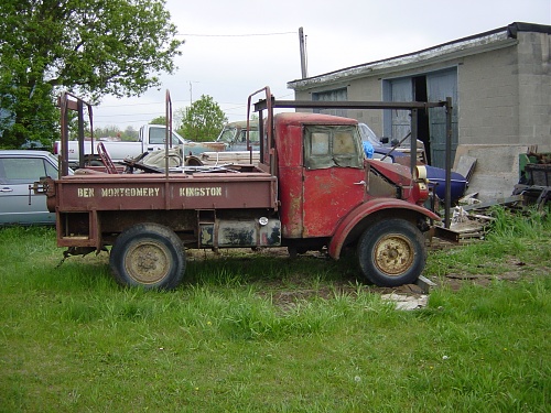

Default "My" Nov '41 F8
Hi Bob
Actually that engine worked very well after several stuck valves were freed up - no really major work necessary. Just for old times sake - photo of "my" truck as purchased from Paul Singleton - and as finished before I sold it - couldn't get really decent tires!
