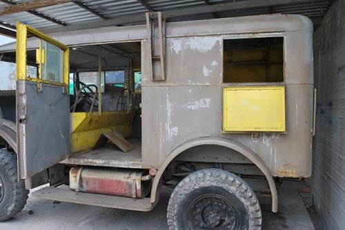

At February 12 we took delivery of a veteran C8A HUW truck, after a lot of months of negotiations and waiting. Thanks to our french friend Philippe, all went well, and our dreams came true!
The adventure to the magic world of HUP's had just began!
Some photos of the first days in Greece.

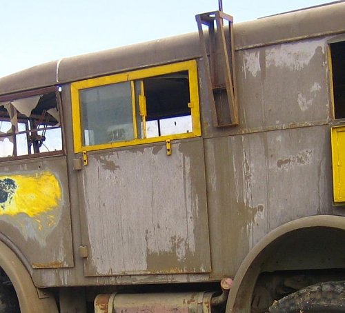

The truck is in reasonable condition, but there is a lot of work ahead for everybody. We have desided to go on a ground up restoration, to give a new life to her.
From this point I'd like to thank Hanno Spoelstra and Allen Tooes, a former HUW owner, for their help.

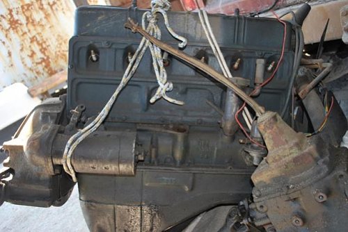

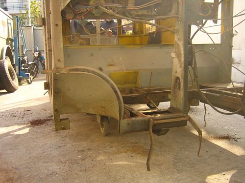

Today, we removed the nose and upload the engine. All went well according to schedule!

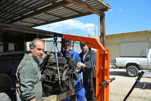

Nikos (L) and Fanis(R) removing the nose, the radiator, a help of a hydraulic jack , the crane.
We decided not to remove the cub, before uploading the engine. Made a mistake?

We planned to pul out the engine in two stages with the help of a small but very strong crane.
Finally, we got it! The 235 engine was out in the open air!
Third foto : Nikos(L), Kostas(M, Haridimos) and Fanis(R).

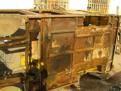

The chassis revealed in a tired and rusty shape, but the good thing is that there are no cracks or other lethal damages..
Next phase is to sandblast the chassis and other parts in the comming days, as long as we have the weather on our side. Three weeks without any rain...
ID:	45464Click image for larger version
Name:	DOOR_19 _25-11-2011 rsz.jpg
ID:	45465Click image for larger version
ID:	45466Click image for larger version

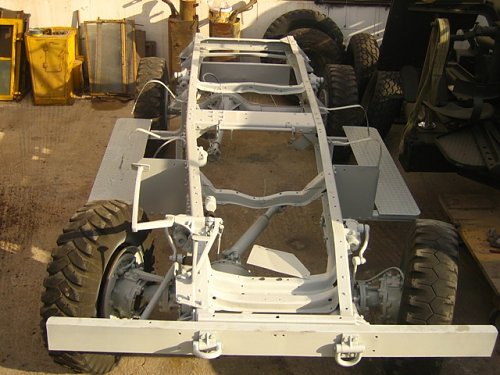

Chassis sandblasted and primed yesterday.
Before and after:
Name:  CHASSIS_ 18B _rsz.jpg
Size:  105.0 KBClick image for larger version
Name:	CHASSIS_ 19_06-12-2011 rsz.jpg
Well...I know what you will comment..: That I need a good set of tyres!
1940 BSA M20
Old 07-12-11, 17:15
Posts: 3,923
Default Your progress is driving me carzy

A little update on the works:
Before and after:
ID:	47248Click image for larger version
ID:	47249Click image for larger version
ID:	47250Click image for larger version
More pics to come tomorrow!
Today is Balentine's Day, and my wife is gonna kill me if I stay longer above the PC pad!
1940 BSA M20
