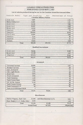

Old 04-08-20, 08:56
Posts: 14,848
Default Canadian production figures
Seems to be just Ford USA figures, not the whole WW2 production figures.
Just adding CMPs, MCPs, Carriers, commercial trucks and cars alone built by Ford Canada would add 600,000 vehicles (almost every one with a Ford V8 engine), not including the various other contributions to the war effort.
Here are the Canadian production figures as recorded in Bill Gregg’s book:
ID:	115281 Click image for larger version
