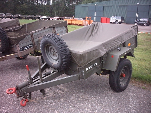

Can anyone identify this trailer? Looks a bit like a British 10-cwt trailer to me.

I was looking at some pictures of Belgian army trailers earlier this week, which are offered for sale at a reasonable price. I think Hanno posted a picture of one on the forum before, but I can't seem to find it now. Anyway, these trailers seem to be based on the British 10cwt design, or maybe even based on actual British trailers. In case these Belgian trailers are modified British trailers, than you could consider using the wheels, springs and axle you salvaged to turn one of those trailers back to ww2 spec.

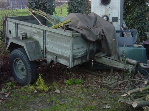

I just found one of these trailers for sale at http://www.military1.be/ where it is captioned "Levacq 1953". This might give you a clue re. the manufacturer and year of delivery.

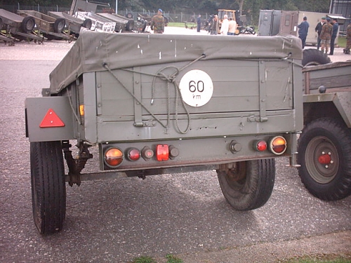

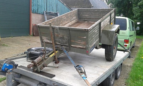

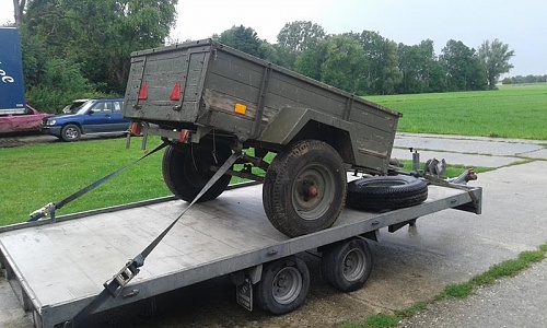

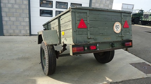

Turns out there are two types of Levacq trailer. One much like the British 10-cwt...
ID:	122188 Click image for larger version
ID:	122189 Click image for larger version
ID:	122190 Click image for larger version

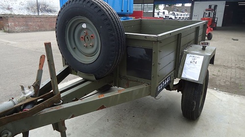

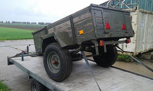

Old 28-05-21, 14:28
Posts: 14,852

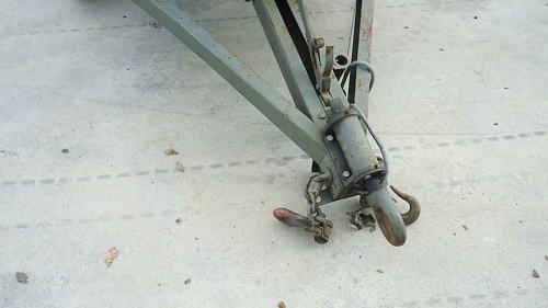

... and a 1-ton one, basically the same configuration but beefed up slightly. Note the side bars added to the draw bar, for example.
Not sure if this is actually a slightly scaled up version of the one above, or just a later version which was beefed up. I do know the tow bar is slightly wider and higher than the British 10-cwt version.

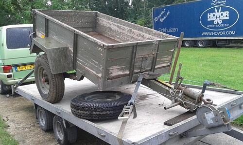

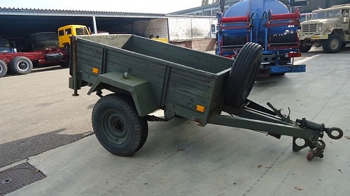

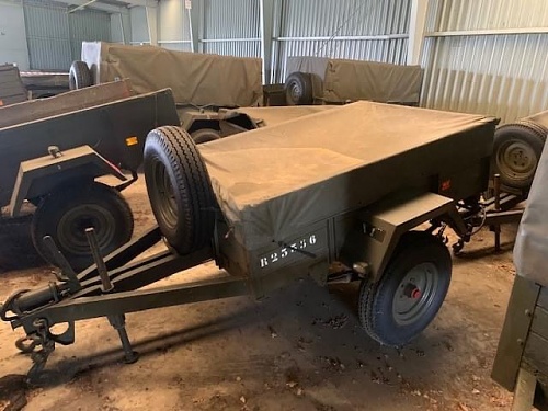

Old 15-10-24, 22:27
Posts: 14,852

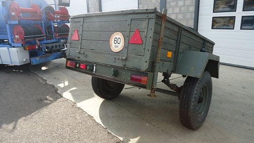

Interesting to see these Belgian Levacq trailers popping up in an Army surplus sale (https://www.facebook.com/share/p/uyw...ibextid=WC7FNe)
These are an enlarged postwar copy based on the wartime British 10-cwt trailer, capable of carrying 1 ton.
