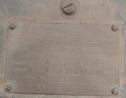

Hi Tony,
Yes the numbers are 385 not 355. Just got word from the chap who owns it. Said between his eyes and the etching on the data plate it was hard to read.
Another point of interest on this list would be to also post the location, even town name only, where these old girls are. I know 016 is Coonamble and mine 518 and Moody’s 275 are located in Coonabarabran. Just a thought.

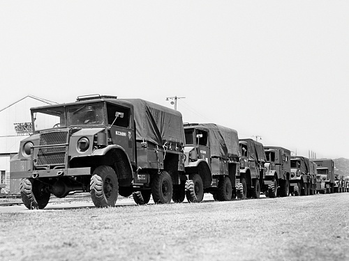

Nice line-up of C8AX's, and other CMP trucks:

Nice image Hanno. I wonder if NZ24990 is a survivor?
Is the 4th one a radio shack?
  #131
Old 23-12-19, 10:41
Posts: 3,679
Interesting to see the different tyre mounting variation on the first vehicle compared to the rest in the lineup.
  #132
Old 23-12-19, 23:23
The front one is set up for longer tyre life on road, the other two for running in mud. Reality is" put those wheels on those trucks...............at the double!"
  #133
Old 24-12-19, 06:35
What are the markings on the door? Not the NZ number, but beside it. I might be inclined to believe it says "TF"
It location looks very well like it could be GM NZ at Petone, might these be newly assembled trucks for delivery?
Lynn, yes the 4th one is a W/T truck. It looks further down the line are Wheeled Armoured Carriers.
Mark Arnott mentioned "NZ Army loading up for the voyage to Korea..." Source: Wellington Evening post.

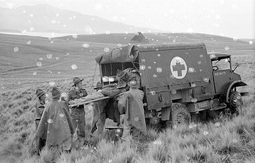

I was reading this thread when i learnt there was a C8AX ambulance with a slightly lengthened body. I have been aware of this very poor photo showing an RNZAF ambulance at Jacquinot Bay in 1944. I alway thought the body looked a bit long for 8/15cwt but not long enough for 30cwt.
fullsizeoutput_189f by tankienz, on Flickr
Then a few nights ago I found this photo on the RNZAF Museum website showing RNZAF units departing Green Island for Jacquinot Bay. This led me to search this site. So proof at least one served overseas.
PR6736.t5ea48e08.m600.xAnfr-P3H by tankienz, on Flickr
  #136
Old 01-05-20, 11:05
C8AX Ambulance (NZ), UC1*
Join Date: Aug 2006
Posts: 388
Default Great pics!
These last two posts help fill the gaps in written accounts as only pics can do!
The pics of C8AX ambulances prove that they were landed on the Solomon Islands captured by 3 NZ Division.
Until now I had only seen a pic of ambulances on Guadalcanal which in 1943 was the forward base from where the amphibious assaults were mounted.
The war histories of the army medical units state they removed the red crosses as the Japanese would target them!
The line up of vehicles going to Korea with K Force is interesting as one contingent with 163 Battery RNZA was aboard an old inter-island ferry named Wahine which ran aground on an island to the north of Australia in 1950.
All the men were rescued by a tanker nearby but all the vehicles and 25 pdrs went down with the ship.
A gunner was decorated for diving into the holds to disable the guns a point of honour as the guns are their colours!
(Another inter-island ferry called Wahine foundered in Wellington Harbour in 1968 with serious loss of life)
Rob

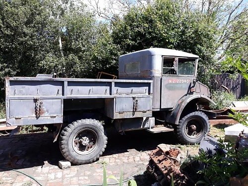

https://www.gumtree.com.au/s-ad/shep...itz/1277925967
Here's a funny one posing as an F15 (it might be an F15A chassis, it has 8 stud wheels?), but it does at least have a new C8AX plate for us so the list is now:

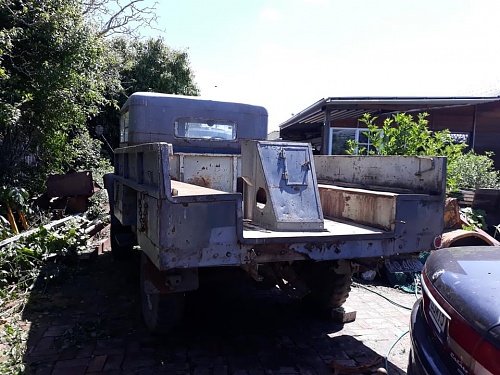

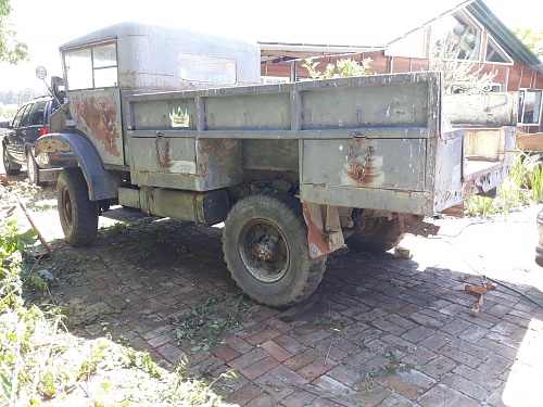

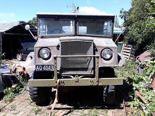

I have been contacted by a member who has 2 new vehicles for the list. Pictures to follow!

Default C8AX s/n XH8448-259
Cross reference from Heads Up: C8AX in New Zealand:
Serial number reads as XH8448-259. Seems we haven't seen this one on here before.

One more for the list, via Roger Wilson:
NZ Army Field ambulance with extended rear deck and ugly inner panels to allow two stretchers to be carried , to aid in the restoration I have removed them.
For Keith Webb and Hanno Chassis Model C15441 , Chassis Serial XH8448-075 , Engine FP3852611 , Order no 2394 ,manufactured 5, 3, 43
NZ22945 Ambulance 4 Stretcher 4x4 Chevrolet C8AX at one time issued to a unit in the Northern Military District. It is now owned by Roger.
