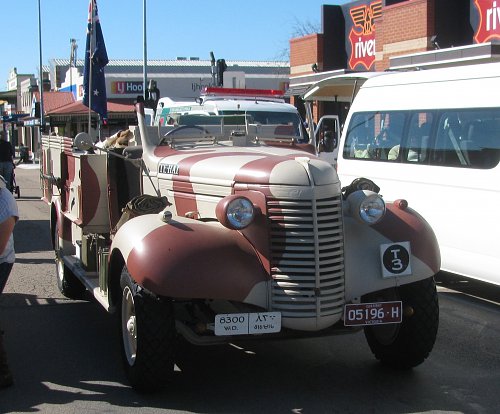

Originally Posted by Andrew H. View Post
Well, another ANZAC day has passed without our truck being finished, or at least being mobile. But I am happy to report that there was some real progress today, as the reconditioned motor has at last arrived from the engine reconditioning shop! Yay!!! We only had to wait 4 years! But to be fair, until now the lack of an engine has not been holding us up, as there were so many other things we could do on the truck. But now we are looking forward to installing the engine, getting everything aligned properly and sorting out the fuel pump, carburetor, distributor and starter-motor, which we expect to take a few weeks. Also pleased to report that, after a lot of rummaging we eventually found the original oil slinger and installed it in the reconditioned gearbox.
I took my replica 1940 WB Chev to Paynesville and Bairnsdale Anzac day parades today and whilst it went well, I will have to replace the clutch throw-out bearing and recondition the gear box, a job I have been putting off for a couple of years now. Still it was well worth the exercise. Great day with large crowds.
Name:	Anzac Day 2016 030.jpg
'Lest We Forget'.
Regards Rick.

Hi Rick,
Truck looks great! What size tyres have you got?
Andrew
  #135
Old 27-04-16, 03:29
Hi Rick,
Andrew
Hi Andrew, The tyres on my WB are a strange size. They are 9.50x16 sand pattern tyres which I found fully wrapped up and stored in a blokes shed a few years ago. I have never seen this size anywhere else but they fell onto the wheels like they were made for the rims.
This photo give a better view of the tread etc.
Regards Rick.

  #137
Old 27-04-16, 09:11
You are right Mike K. It was Vic's and I inherited it after Vic's death. Seems I did him a favour in 1995 and as a result, he was able to take part in "Back to the Track" to Darwin to celebrate the end of WWII and he never forgot.
Regards Rick.
