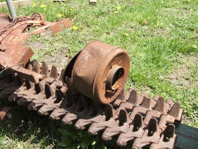

Rob sent me some photo's of the bits, it was nice to see a cardboard box filled with linkages and some strange peices, i will post it up and we can play "guess the component" game there are some very questionable track pins in there too.
On the rear deck pannel there appears to be some sort of square frame made from right angle ? and one exhaust sheild is solid where as the other is the mesh type ?
and the box of bits.
i can see track pins, part of a steering linkage, and a service cover plate from the bottom of the hull (but which one ?)
what are the rest folks ?

it may be wishfull thinking but the long peice looks like a fuel dipstick.....pretty rare i believe, like i say wishfull thinking

It is part of the gas tank strap the egg shaped pieces on the right are fuel drain patches for the hull floor and the square piece on the left is a fuel tank hold down bracket.

The square angled piece on the sheet metal deck is the bracket to hold the jack block. The exhuast covers are supposed to be like that. One is solid since the tarp sits on it a bit. Underneath the sheet metal is asbestos. The other is just open mesh style since no tarp.

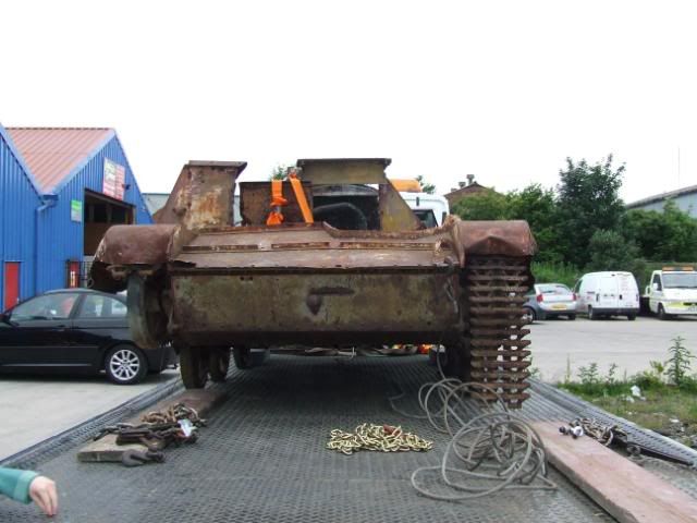

right job done !! i feel drained with the stress, we had a drop of 12" between the container and the recovery truck so we had to relocate...... managed to pull her out what a S*** Heap was mentioned by many, they just cant see what i can, found some bits more worse than i expected but also found 99% of the linkages in workable condition so happy days ! the cover off the cam plate has disintergrated and is knackered so i will try my best to peice the bits back together and make a pattern for those that want them. managed to free up 90% of the seized track with a couple of "Wollops" with the hammer, going to strip them into sections and stack them up.
a few pics to follow in due course, but a cup of tea is in order about now

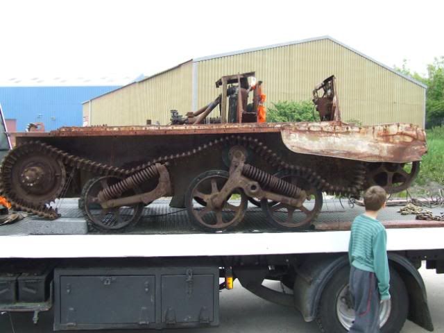

some pics of it in the UK, got to unload into my garage (the easy part really) ian comes back later after work with the truck.
started to break the track into section, these two sections were from the bottom of the track (against the ground) which has not been moved for seven years !! one broke up really easy but the other one....nearest to the wall looks to be in a bad way.
seem pretty straight though

Old 05-06-09, 10:43
Default Richard
Soak your track in oil, while your working on other parts of it. go back to it later, and with a pair of pry bars poked into consecutive tooth holes, try working the links on the pins. Once you have them all moving, put the track away to drain. I used hydraulic oil, and it worked a treat for me.
P.S. You look very young.

hahahahaha not bad for 65 !! just kidding no that is my eldest son 9 years old, i started early saying i am only 29 myself brought my old man around who was strangly teary when he saw the carrier became very nostalgic but his words were true
"this machine was in service the same time as your grandad / my dad, was in service driving the same type of machine" wonder where he would have been when this one was born in 1942 (still training in Inneskillen i reckon)
I sprayed some ptfe between the links and but a shaped bar on the floor, i then used the hammer to pursuade the more stubbord links to move which worked.
i have heard AT fluid is great for eating rust, i was going to make a bath of the stuff to sit the sections of track into. looking at some of the pins the track may well need re pinned dont know, but that stage is a while away yet anyway.
will attach a few more pics to this post when i upload them.
first time the carrier has touched UK soil is my garage floor, used the tilt and slide straight in....
This is my mothers garage which she does not use, and it still has my block and tackle etc etc from my rally x days. my garage is now a machine shop for working on the components / engine etc etc

Congratulations, glad to see that you have the old girl safe and sound on British soil, We will watch your progress over the coming months with interest, I am sure that if you need any help with your project that you will find it here, welcome to the carrier owners club,
Regards Ron

I would get those heat shields off there, and bag them up. You dont want any of your family breathing that asbestos.

Indeed i noticed that it was starting to break up on one pannel so will get it covered up asap, was considering getting rid and using a ceramic repro, not sure yet though.
Rich

i took the heat sheilds off, they were really badly broken up, i went a bit ott and wore a mask and full paper suit. anyway they are off and bagged up. suit and gloves have been burnt.
i took the heads off the engine to have a look see, poored some AT fluid down the pots and ran it in around the valves etc etc, took the carb off which is full of stones and grit / plus its pretty much seized up solid.
basically just removing bits to get access and sprayed more penetrating oil than any man should in one day, just putting it on now to help when i need the parts off without snapping the bits.
the box of loose bits consits of shot track pins and the cover plates, plus some linkage peices which are going for a soak in the ultrasonic bath.
one of the rear bogie wheels has a section of the rim snapped out its about 3mm deep and 4cm long. once i have removed majority of the weight i will pull all the wheels and susp units my theory being at this point it will be easier to move on the jacks i have (2.5 tonne jacks)
found a few goodies lying in the hull stuff like the rear convoy lamp etc etc
sat in the back of the hull staring with a big smile on my face for like two hours ! bit overwhelmed but in a good way, this girl is going to need some work, but so far other than everything being damned heavey and seized up she looks easier than the plethera of minis i have done over the years.
