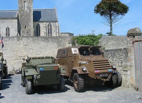

Join Date: Apr 2011
Location: Cherry Valley, ON
Posts: 554
Default Normandy 2004
Guys,
Got some more great pictures from Barry Churcher taken on the Normandy run in 2004 of Barry's C15TA and Dirk Leegwater's Lynx. Must of been a fantastic experience.
Of note are the Ontario plates on the Lynx. The Leegwater's Lynx is an early mark with rounded armour on the fuel tanks and different storage layout.
Enjoy, I did, Peter

  #633
Old 01-09-18, 06:08
Nice photos, thanks for them. Something does not look right to me. I don't think the fuel tank covers are right for that type of cabin top. If they are the right ones then the cabin top with no roof is incorrect. The cabin top with the padded cushions around the top does not go with round tanks. This one has 3 hinges on the rear hatch which is an early Mark identifier, but round tanks were only on the first early Mark with the vertical radiator, not the horizontal one it has, and would have had a full length engine cover. I know that modifications were done as they came down the line so who actually knows what is right and what is not.
My lynx is a change over model which was modified during its build from vertical to horizontal radiator louvers and the shorter engine cover. You can see in many places where the have welded up holes and oxy cut other areas to fit the horizontal louvers and short engine cover. It has the same hinged covers on the lubrication points as Dirks which also points out that is is an early hull.
Having said that, I don't mean to be a rivet counter as I am so glad to see one on the road and Dirk has certainly helped me out with hard to get parts for mine.

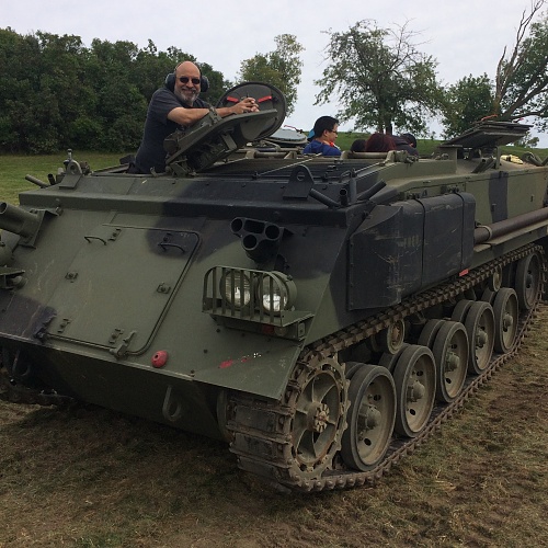

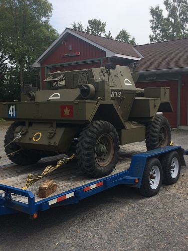

Trailered the Lynx to CFB Kingston to support the Base's Family Fun day. Got to drive the Lynx around for a bit, but the true heroes of the event were Ryan Harriman's FV432 and Paul Hudson's Kaiser M35 that hauled hoards of "civilians" over a hilly course overlooking Fort Henry. Dave Muralt is at the controls of the FV432 in the attached picture, the blouse for the RCDs in the Italian campaign is also Dave's.
Peter

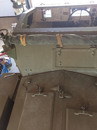

In anticipation of finally getting new tires this winter I acquired an additional set of wheels. Now sandblasted, primed, painted and waiting. Still hoping to find a good set of Dunlop Trak Grips, if not new NDTs.
Made a pattern for the canvas top using heavy clear plastic, now to see if my friendly tent and awning manufacturer can make one with the heavy canvas that came from a deuce and a half.

Jeff Church was able to stitch together a nicely fitting cover for the Lynx using my pattern. Also sewed in the stiffeners and riveted the webbing together. Used the Lynx 11 in the CWM for the pattern for the webbing. Now to try and find a pattern for the crash pads C19SR 111213 that surround the crew compartment - only need 20 !!!
Peter

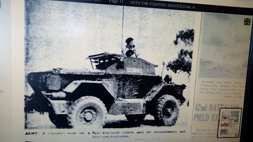

I'm always on the search for period pictures of Lynxes in service. I recently came across this picture of an early Lynx. It must of been a painful moment for both the operator and the Lynx itself. Judging by the background I think it was taken in either Australia or New Zealand.
If anyone knows anything about this picture and the circumstances, it would be great to learn what took place.

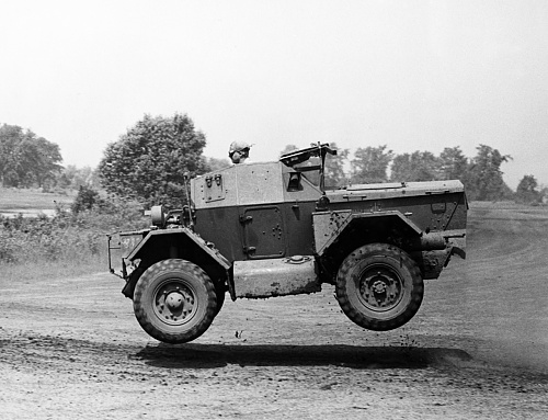

Here's one more pic of a low flying Lynx. I am sure this was done only for publicity.
I think that if a regular driver treated his vehicle like this, he would be standing in front of the CO for explaining his misbehaviour.

I think I have seen that photo before somewhere, the context of which was that it was one of a series taken by Ford of a Lynx being put through its paces by an employee on Ford’s Proving Grounds, somewhere in Ontario. Note the complete lack of markings on the Lynx.
  #648
Old 04-11-18, 17:42
Posts: 14,951
Hi David,
Indeed, hence my remark about publicity.

"With four wheels off the ground, test drivers like Lawrence Perrault, give the scout car a thorough "dress rehearsal" for the war effort overseas. Scout cars were usually tested for about 75 miles before final inspection. The photo dates from 1942; the site - Ojibway Park."
There were fifty-six test drivers of the Ford Canada Department 159 listed in the June 1944 edition of the Ford Times.
Lawrence Perrault
Has been attached to Dept. 159 since 1936 and is now test driver and repairman. His brother Sydney works in Dept. 37.

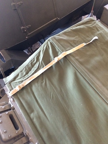

  #660
Old 23-11-18, 03:46
Join Date: Apr 2011
Posts: 554
Default Small stuff
Guys,
While I would not suggest this stuff for heavy service applications, it certainly works for cosmetic repairs. The Lynx has two of it's original gun rests that had weathered dramatically since 1944. I applied several coats of this stuff and it has restored them to the point that I put them back in service.
Peter
