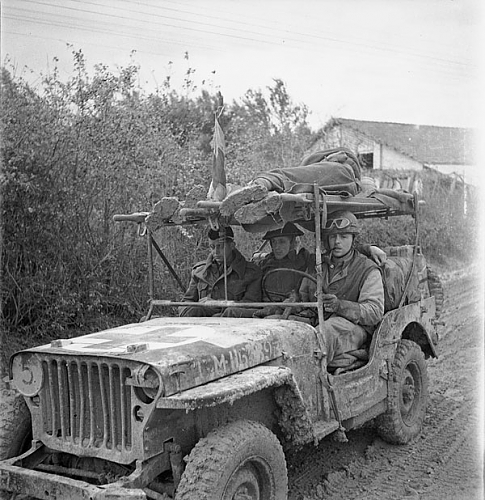

Let's keep this thread alive by adding some pictures. I hope the CDLV Jeep experts will feed us with their detailed knowledge.
Single headlight with brush guard, but I cannot see lifting rings on the front bumper - CDLV 505 contract Jeep?
A jeep ambulance of the Royal Canadian Army Medical Corps (R.C.A.M.C.) bringing in two wounded Canadian soldiers on the Moro River front south of San Leonardo di Ortona, Italy, 10 December 1943
Credit: Lieut. Frederick G. Whitcombe / Canada. Dept. of National Defence / Library and Archives Canada / PA-180097

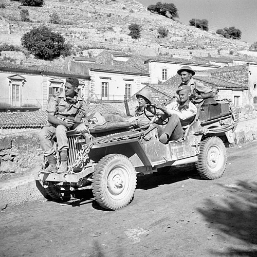

Old 05-01-07, 22:59
Another one with single headlight with brush guard - are those chains fitted to lifting rings on the front bumper?
Canadian war correspondents in a jeep, Modica, Italy, 13 July 1943
(L-R): Peter Stursberg, Canadian Broadcasting Corporation; Ross Munro, Canadian Press; Captain Dave MacLellan, Public Relations Officer; Lieutenant Al Fraser, Canadian Army Film and Photo Unit.
Credit: Capt. Frank Royal / Canada. Dept. of National Defence / Library and Archives Canada / PA-204808

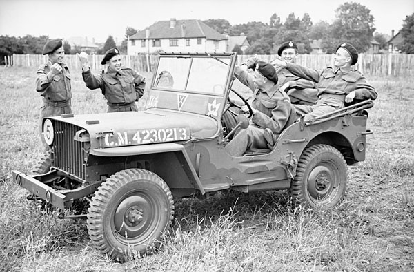

Old 06-01-07, 17:55
wim sikkelbein's Avatar
wim sikkelbein wim sikkelbein is offline
Location: rijssen, holland
Posts: 181
Default cdlv 242 jeep
public archives of canada
Troopers of the Three Rivers Regiment in a jeep, England, 22 July 1942
PA-213504 MIKAN No.: 3599654
cdlv 242 with mickey mouse camouflage
Name:	a213504-v6 jeep three rivers england 22 july 1942.jpg
In flanders fields the poppies blow.
Between the crosses row on row.

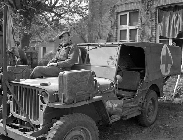

Old 06-01-07, 18:13
Posts: 181
Default strange medic jeep
Private F.J. Dunn resting on his ambulance jeep while evacuating casualties south of Bad Zwischenahn, Germany, 29 April 1945
PA-205395 MIKAN No.: 3586347
how about this one
Name:	a205395-v6 medical jeep bad zwischenahn germany 29 april 1945.jpg
Old 07-01-07, 20:31
M38CDNBill's Avatar
M38CDNBill M38CDNBill is offline
Location: Trois-Rivieres, CANADA
Posts: 156
Nice picture Win. However, I don't recognize the unit marking under the windshield driver side. The Three Rivers Regt was in the 1st Armoured Brigade (independent) and this markings is not the good one. Somebody has an answer?
Also, what is the signification of the inverse triangle with the "X" under the windshield? Is it possible to know what are the colors of this marking?
Guy aka M38CDNBill
1945 Willys MB
1942 Chevrolet G7107
Old 08-01-07, 00:37
M38CDNBill's Avatar
Posts: 156
After few researchs, I guess that marking is the previous sign (until the Dieppe raid or before 1943) of the 1st Armoured Brigade. I checked out a picture of the Dieppe raid and on the front of a 14th Armoured Regt tank (Calgary Regt), I saw the same sign and during the WWII, the Three Rivers Regt was in the same brigade.
Does somebody can confirm this affirmation?
Guy aka M38CDNBill
1945 Willys MB

Old 08-01-07, 12:44
Mark W. Tonner's Avatar
Senior Forum Member
Posts: 3,027
Post Re: photo - Troopers of the Three Rivers Regiment in a jeep, England, 22 July 1942
The Arm of Service marking and the Brigade Formation sign that appear on the jeep in Wim's photo are correct for the time that the photo was taken (July 42).

sign writing in progress: "Unidentified soldier stencilling numbers on the hood of a jeep, England, 21 December 1943"
  #58
Old 01-05-07, 02:39
One more pic, in colour even. Source: canadiansoldiers.com.
Markings and unit, according to John McGillivray:
-Division sign (yellow maple leaf on a blue background) indicates that it belongs to the 2nd Canadian Infantry Division.
-The red over blue AoS with the number 42 - 4th Field Regiment Royal Canadian Artillery
- Tac Sign - the blue square with the bottom left (viewers right) corner in red - the second battery of the Regiment - 14th Field Battery.
