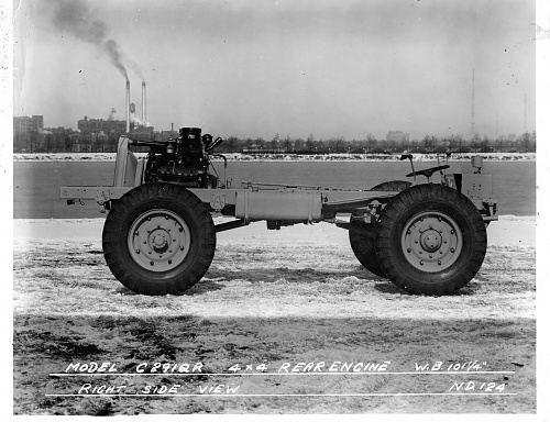

Default C291QR chassis used on Mark IV
Cross posting from Another Indian Pattern odd job: "C291QH 4x4 FAT for Royal Engineers" with three updated photos:
The Armoured Carrier, Wheeled, Indian Pattern Mk IV was based on the following chassis:
C291QR: rearranged driver’s position with centrally mounted near-vertical driver’s position
Legend:
C - Canadian design;
2 – 1942 model year
9 - 95-bhp engine
1 - wheelbase (101");
Q - four-wheel drive;
R - rear mounted engine.

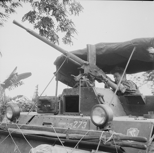

Default Japanese weapon
The lower image shows a carrier mounting a Japanese 13-mm Model 93 machine gun. Calibre was actually 13.2-mm (0.52 inch). Had a 30 round magazine. Fired Ball, AP or Tracer. Also issued in a dual or triple mount. If I remember correctly, the butt has a kink in it to offset it to one side, I think the left, so that the operator can see past the action & magazine to align with the offset front sight.
Interesting that the Dutch picked up Japanese equipment and put it to good use: there would have been plenty of Japanese weapons and ammunition available.

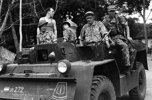

Old 11-02-21, 12:44
I came across this picture in the Dutch Army photo archive....no idea if it has been posted on the forum before, but better safe than sorry.
source: http://nimh-beeldbank.defensie.nl/nl...d/pantserwagen
Dutch East Indies 1947.
Found the updated link to this photo:
Objectnummer: 2002-413-1
Titel: Verblijf en optreden van Stoottroepen Infanterie IV (voorheen 5(9) RS) in Nederlands-Indië.
Militairen van de 2e Compagnie in een Armoured Carrier Wheeled (Indian Pattern) Mk IV tijdens een konvooitransport van Medan naar Belawan.
Datering 1947-01

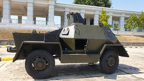

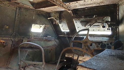

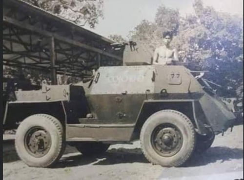

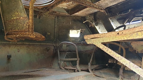

Default survivor in Naypyidaw, Myanmar/Burma
Here's a survivor in the Defense Services Museum, Naypyidaw, Myanmar/Burma. They have an Indian Pattern Armoured Truck, too.
Here is another photo of Wheeled Armoured Carrier 35-273 sporting the Japanese Model 93 machine gun:

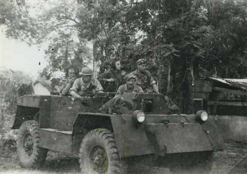

Default "Militairen roken in een tank"
More photos of a Wheeled Armoured Carrier in Netherlands Army service in the Netherlands East-Indies, ca. 1946.

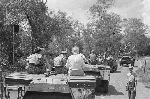

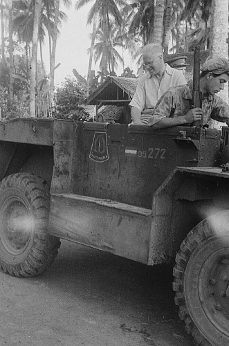

Default Reg.no. 35-271 and 35-272
There are two Wheeled Carriers, both of which have the typical Indian Army census numbers of which the /|\ has been supplanted by a Dutch flag. They are following a Universal Carrier and what may be a Humfox leading the column.
These photos show Dr. C.P.M. Romme, a Dutch politician (in the light shirt) sitting on a Wheeled Armoured Carrier, part of a column on the "death road" from Medan to Belawan, Indonesia.
Apparently there was not a high risk of attacks on that day, otherwise Romme would have travelled under armour.
Date: 2 February 1947
