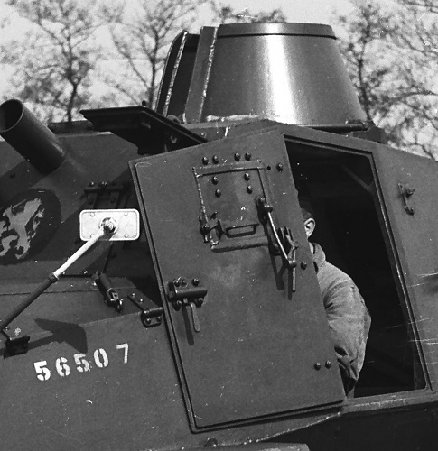

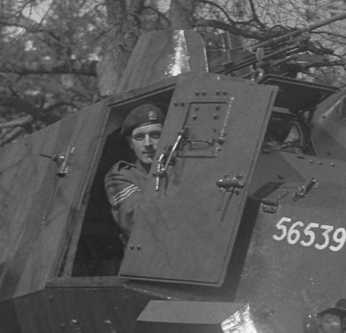

In post #2 it looks like the remains of a registration number CM 46??296 are visible, similar to the number on the Otter on the attached photo (from the book “XII Manitoba Dragoons a tribune” by B. Tascona, showing Otter used during training in the U.K. 1943).

Lastly I found on the right rear fender what I believe to be a postwar Dutch marking. The Netherlands flag in what I think was a black circle.
Jordan, you might even be able to find an orange lion marking under the red-white-blue dutch flag. The black circle with orange lion was the marking used just after the war (and during the war by the Irene Brigade), later in life Dutch army vehicles received a licence plate and red-white-blue flag in stead of the older style markings.
Attached are two Ward la France wreckers in different time periods. Early post-war with orange lion and later with licence plate and flag marking.
