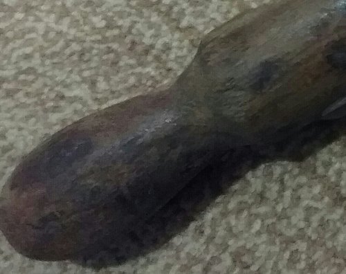

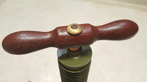

An interesting item has arrived.
But what do you think it is?

Perhaps a precision spring?

A fuel can?

Maybe a canvas stretcher, with wooden poles?

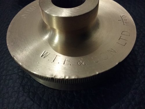

Last clue. Yes, it does say WTF.
W.T.F & SON LTD 1/1940

Hand pump for the recoil recuperator system?

Yes, fluid pump for filling the recuperator.

I'm fairly confident it will be fully operational.

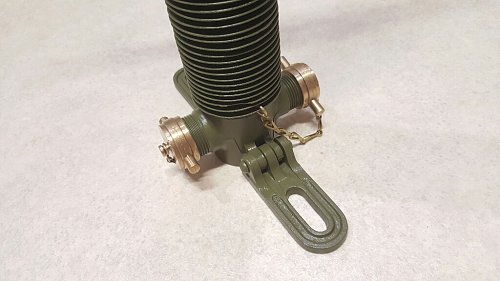

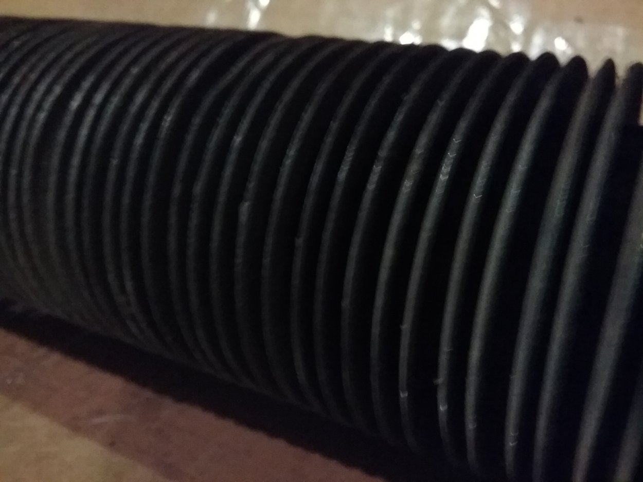

Certainly is a complex thing. I must ask why the many rings around the cylinder?
Are they to prevent damage to the cylinder wall, or some form of heat-sink?
Must say, I wouldn't have really expected the latter.

Tony, the rings are purely to prevent damage to the thin cylinder. It is just a transfer pump and doesn't work at too high a pressure.

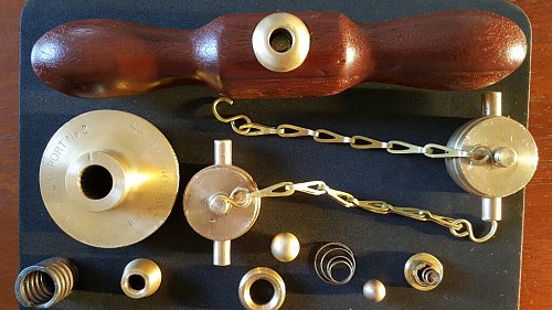

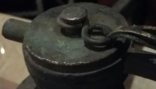

The fluid pump has been disassembled for cleaning.
Got some bits cleaned up already,
and a big one yet to be attempted.

I straightened a few of the vanes that had copped a minor whack over the years.
So far, I have been cleaning the parts indoors at night. I don't think I'll try that with the last piece. It's more of a wire brush & turpentine job.

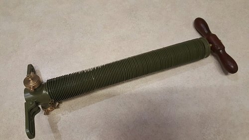

Default QF25PR Fluid Pump
Fluid pump is finished. Only need the hoses to complete.
