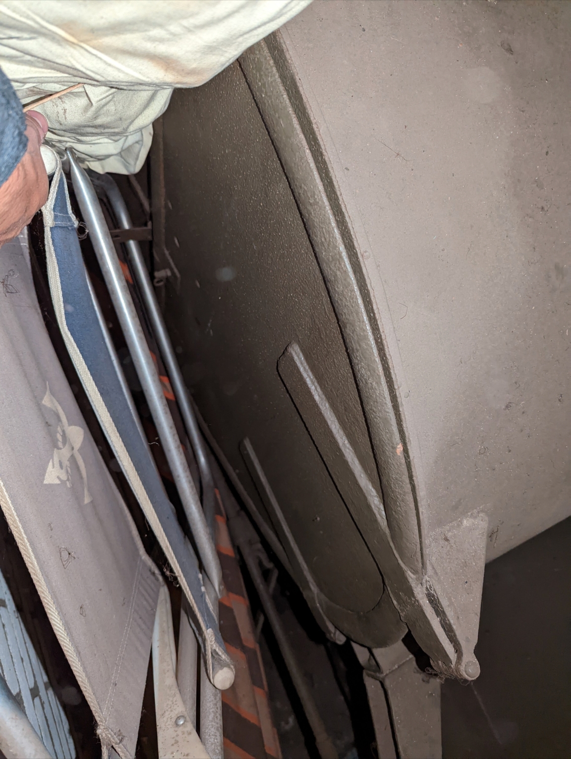

Here are a couple extra pictures I took of the truck. Interesting to note is that it's a British water tank. I've seen pictures of these on a Cab 11 Ford F15A, but not on a C15A Water Bowser Chassis. Does anyone have more info on this?

...And a couple more.
Also interesting to note that this truck is featured in Les Freathy's 'British Military Trucks Of World War Two'.

There has been discussion in the past about early CMP's fitted with British water tanks in the UK. Some show a slightly egg-shaped tank, but the truck in question seems to be fitted with the more common Bedford MW style tank. . I have no clear answer if this is a wartime combo, or if this was done during preservation. Maybe Owen knows more(?)

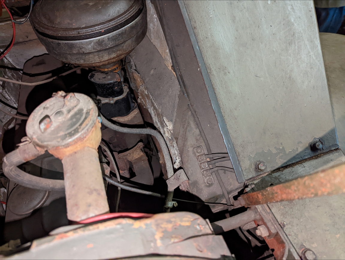

I do have two pictures from under the hood where, if I'm not mistaken, you can (just barely) see the vents from the outside.

Old 10-10-22, 23:59
Originally Posted by M.Morren View Post
The vents were there though if I recall correctly.
Hi Marty, yes, those are the vents indeed....and the pictures also show the Cab 12 brace behind the radiator. The vents came somewhere in the second half of 1940 during cab 11 production and were fitted to all cab 12's. My first assumption was that this truck was an early cab 11 (as it has a lot of early features) to which someone had fitted a 12cab nose and vents, but it seems I might be wrong here and it could well be a very early (nov/dec 1940?) cab12, with a mix of cab 11/12 features caused by the switch from one cab to the other and the parts on the production line being used up.
Old 11-10-22, 03:58
I neded to back-track, in two of the photos above I can see the ends of the stiffening brace just behind the radiator (one to each side of the radiator).
