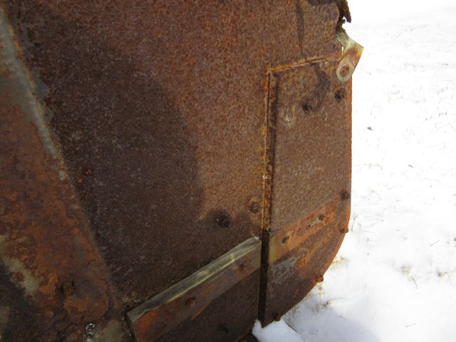

Here are two pictures of a #12 cab Chevrolet that has extra plates added to both sides of the floor. Every indication of wood spacers and paint remnants indicate that it is original. The added plates are on the outsides of the frame and to the rear of the under side of the cab floor plate. They are heavy and measure about 5/8 inch thickness. What could this possibly be for?

Bob and I have speculated that the added plates served to stiffen the floor plate against flex caused by the cab rear panel. I have no proof of this theory.

One of the few cab 12 modification that makes sense...... it does keep the rear corner of the cab from flexing...... and doors from sagging.
Early into the cab 11 it was advised to remove the doors when the roof was removed as the back wall had very little to hold it up by its own.
I retro fitted them on my cab 11 which Grant maintains is now a cab 11.5.... I used some of the cab 12 front sheet metal and fitted the extra cab 12 radiator cross bar..and will fit some Hammond reinforcements on the corners of the wooden frame work for the cab...... then Dynamatts inside the doors and Heatshield inside the engine cover..... and may use cab 12 mirror arms instead of rigid cab 11 arms...... Oh my rebuilt doors are reinforced cab 12 also..... with special sideways battery box a la cab 13.....
Mongrel it is......

Thanks for the response guys. The re-enforcing certainly does make perfect sense but, my gosh those are a huge piece of metal.
After working on the #11 cab and #12 cab trucks the nightmare of bad design and "what were they thinking" gives one an appreciation of the beauty and simplicity of the #13 cab design.

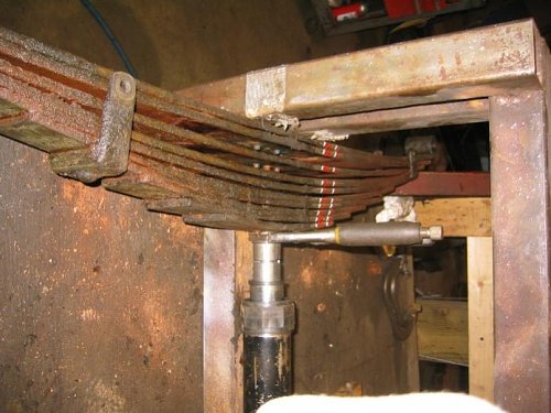

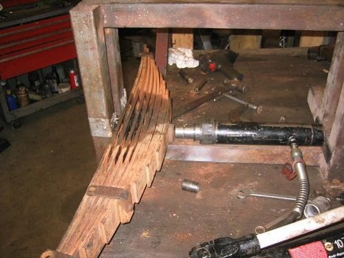

As pointed out the springs may be under a lot of tension if the center bolt has broken. Here are two photos of how I uncompressed and then reassembled the springs when I restored my HUP.
Name:	W 2-24 Beast Rebuild Camera 005.jpg
ID:	73033 Click image for larger version
Name:	W 2-24 Beast Rebuild Spring Uncompressed.jpg
The funny red and white lines on the springs were so I could be sure to get them assembled back together with all the leafs going back in the same order and not getting mixed from one spring to another.
Go light on painting the leafs too much paint will make it hard to get the bolts through the spring clips and as the paint wears from movement of the springs the leafs will tend to separate.
Also once you have the truck all assembled and have driven it 1000 miles remember to re-tighten the U-bolts, while you are doing that check all the body mount bolts as well. On my HUP I discovered stuff that was tight when first assembled was loose after driving.
Gord
The cab 12 C8 I bought back in 1981 , had those same plates under the floor corners . Mike
