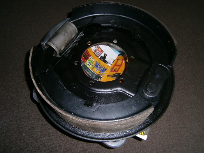

Brake backing plates have been blasted and painted. This one was assembled with the old cylinder, as a test only. All new hardware bought. Some of the original bolts & nuts were a bit chewed by rust. The 7/16 castle nuts which hold the brake backing plate to the rear axle were a shock as far as price goes. Originally quoted at more that $3.00 EACH!! Stated to be expensive due to their 'rarity'. Finally bought 24 of them at less than $1 each. Still outragously dear.

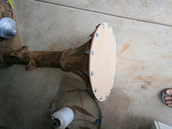

Shouldn't get any grit inside. I wrapped sensitive areas in 10 layers of gaffer tape (with rags beneath), and the larger openings are covered with plates of MDF I made yesterday morning.
Lets see if it does the job.

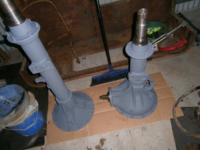

Al the rear axle parts are now painted. Weather threatened to rain but I got away with it . Paint will be allowed to dry for a week before I attempt reassembly. Trust me, the temperature the workshop gets up to will bake it well in next 7 days. Local carpet shop/s will be getting a visit from me next week, cap in hand, for something soft to lay the various parts onto for fitting together.
In one of the above photos you can see two lengths of pipe up against the wall. The bargain bin of local steel shop is a great place to find handy off-cuts, and these two sizes are perfect match for two main sizes of seals etc. These pipes will form part of the bearing installation tool (once cut to lengths required). All of the tool will be metal but shouldn't present a problem because there will be no impact transferred to the cups or seals. A threaded rod will slowly wind the seals & cups into place. At least thats the way Ford did it with their tool. The larger diameter pipe will also be used to make curved cradles with which to jack the whole thing once finished. Remainder of that tube would make a nice machine tool stand too!
