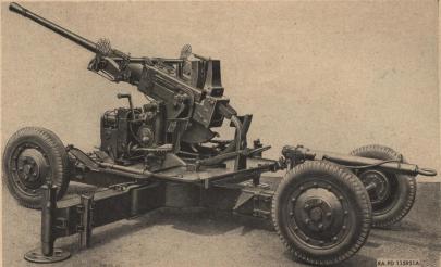

Default Bofors-School, lesson nr 1
Could someone correct the terms I have translated.
(Gun Mk I on carriage Mk II or III modernized with 1944 "Stiffkey-Stick" sights and protective shields)
1. Barrel
2. Flash eliminator
3. Recoil housing
4. Recuperator
5. Elevation quadrant
6. Counterbalance
7. Firing pedal
8. Foot rest
9. Barrel clamp pillar (for transport)
10. Barrel clamp
11. Chassis
12. Jacks (4 pcs)
13. Wheels
14. Outriggers (left and right)
15. Gun platform
16. Towing hook
17. Case ejector chute (upper)
18. Case ejector chute (lower)
19. Seat for gunlayer
20. Predictor (target calculator)
21. Autoloader
22. Breech casing
23. Fire selector (secure - single shot - full auto)
24. Recoil spring
25. Trunnion
26. Sights
27. Armoured shield

Richard Notton
Guest
Posts: n/a
Default Re: Bofors-School, lesson nr 1
Stellan, I'll have a go since no one else has; even though you have asked, it is not considered polite to correct the English of a non-native speaker when the meaning is understood but the grammar and word usage is perhaps unusual or incorrect.
Having spent many months in Sweden some years ago, we again find everyone spoke good English, thereby absolving us of any effort to learn another.
I do not have any official Bofors reference works to hand but I think the names are quite common.
2. Flash hider - possibly flash eliminator, "hider" is more of an American term.
4. Recoil tube - difficult to see, is this the recuperator?
5. Elevation arch - elevation quadrant (gear).
6. Equalizer - counterbalance (?)
7. Pedal-trigger - trigger pedal/firing pedal
9. Barrel fix bar (for transport) - Barrel clamp pillar.
10. Barrel lock - barrel clamp
11. Carriage main body - chassis
17. Rail for disposal of empty cartridges (upper part) - case ejection chute (upper)
18. Rail for disposal of empty cartridges (lower part) - case ejection chute (lower)
19. Chair for gunlayer - seat
23. Switch (secure - single shot - full auto) - firing selector
25. Main gunmount - trunnion
R.

The carriage
The carriages are of five main types
1) Rivetted short wheelbase. Jacks outside the wheels. Wheels still attached to carriage also when the gun is in battery position. Box shaped outriggers.
This type is found on:
a) Various European countries guns
b) British Mk I and Mk IA
c) US M 1 (British made - some 200 to USA from GB early 1942)
2) As above but welded. Only US carriage M 2 wich was standard during WW 2.
3) Welded long wheelbase. Jacks inside the wheels. Wheels removed when in battery position. GB carriage Mk II and Canadian Mk C 2. Round shaped outriggers.
The GB Mk III carriage is similar to Mk II but have only overrun brakes on front wheels.
4) Two wheel carriages for air transport. GB and US variants.
5) Self Propelled mounts on trucks and tanks.
Armoured protective shields were added to British carriages (both MK I and MK II) in 1944. US Army guns did not have shields during WW 2.
Of the Axis powers only Hungary added shields in 1944.
The Wheels
The wheels could by dimension and type of wheeldisc be divided in:
1) European type
2) British and Commonwealth type
3) US type
The Sights
There are several types of sights and those could help to identify nationality and time period.
1) Optical reflex mirror sights. By the British called "Polish" sights. These were attached to a predictor or target calculator attached to the right side of the breech.
The calculators were of three main types. Bofors, Goerz and Johasz-Gamma but the sights for these types looks basically the same.
2) Early pre-1943 GB "small spider-web" sights. The left sight (elevation)with cross-wires and the right (traverse) with three vertical wires. Called "Forward Area Sighting System".
3) GB 1943 "large spider-web" sights. Three crosswire rings for target speed 100 - 200 - 300 mph. Called "Cartwheel Foresight" or sometimes "Pancake sights". On the Australian version the right (traverse) sight is almoast rectangular.
4) The US standard "spider-web" sights are somewhat larger than the early GB type but smaller than the GB 1943 type.
5) GB 1944 Correctional Sight called "Stiffkey-Stick". This has a calculator attached above and somewhat right of the left (elevation) sight. This sight require a special sight operator in addition to the two gunlayers. The sight operator was standing on the platform between and behind the gunlayers.
6) US 1944 "Sight Computing" M 7 and M 7A1 is a US made "Stiffley-Stick" and operates in the same way.
7) The GB No 3 Predictor or "Kerrison-Predictor" is a box with two small binoculars. It was placed on a tripod (or post 1943 on a separate truck) and attached to the gun with an electrical cable. On the gun platform there were two electrical motors for laying the gun.
the Uniforms
Especially various headgears are helpful when it comes down to identify the nationality of a gun (but not where made).
So now it starts. You should be able to identify:
1) Carriage type
2) Wheels type
3) Sights type
4) Environment type
5) Nationality group
And these facts together gives an idea of where and when.
(Right answer could be found by the AWM number).
