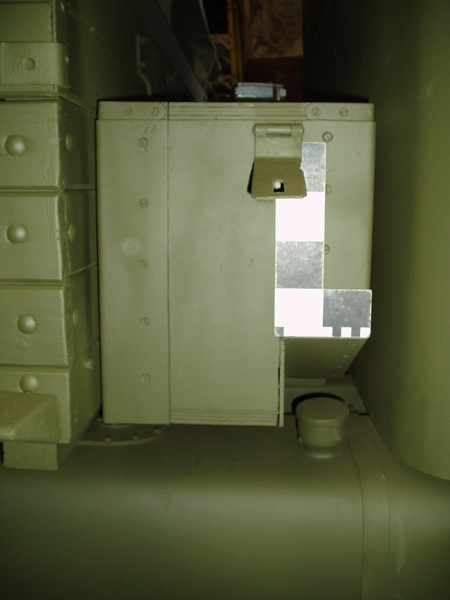

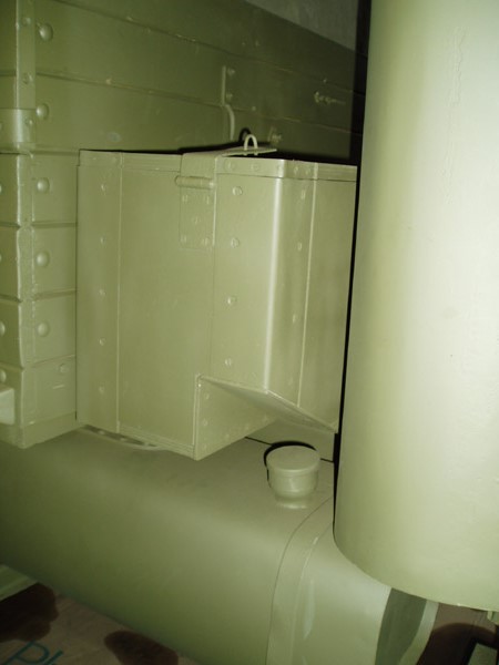

Some smith work by my friend.
Name:	C-15a (800x449).jpg
ID:	70641   Click image for larger version
Name:	C-15b (800x450).jpg
ID:	70642   Click image for larger version
