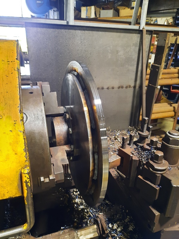

Times like these I need a bigger lathe

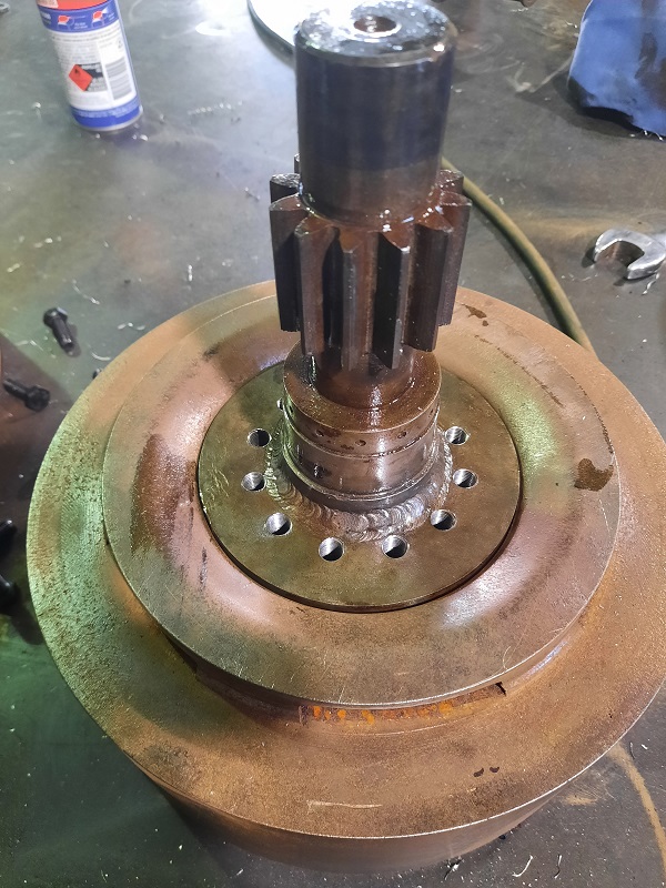

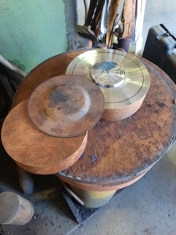

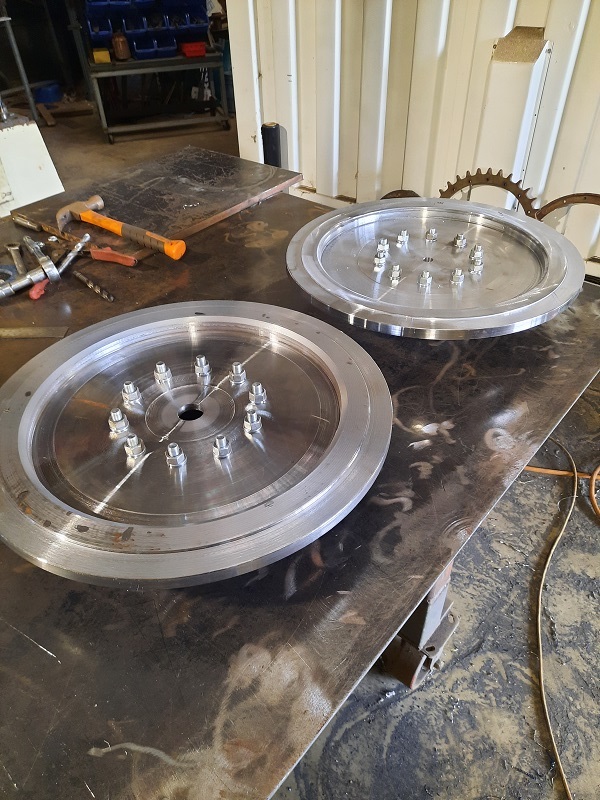

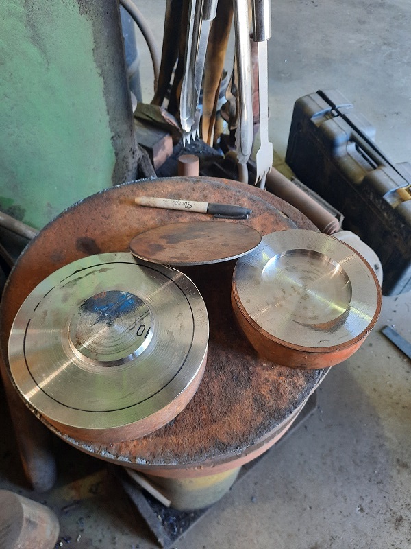

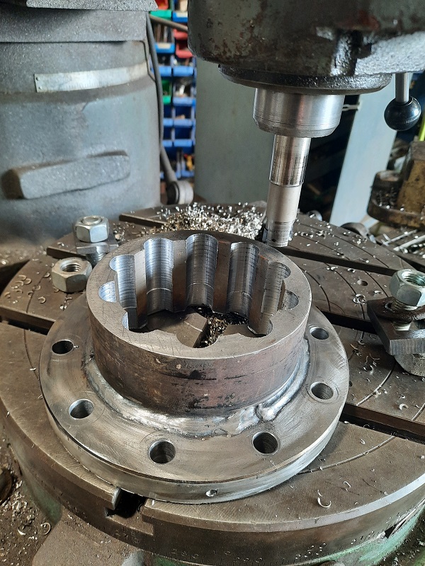

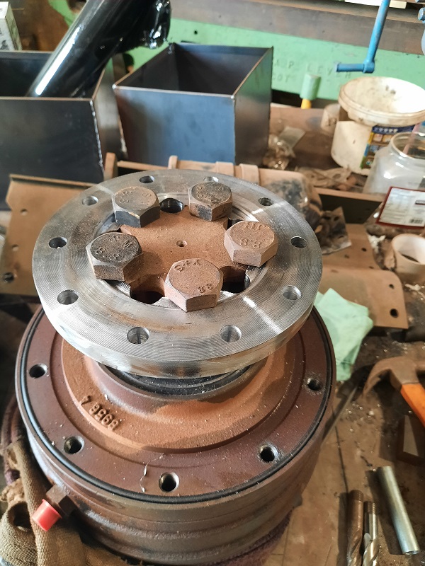

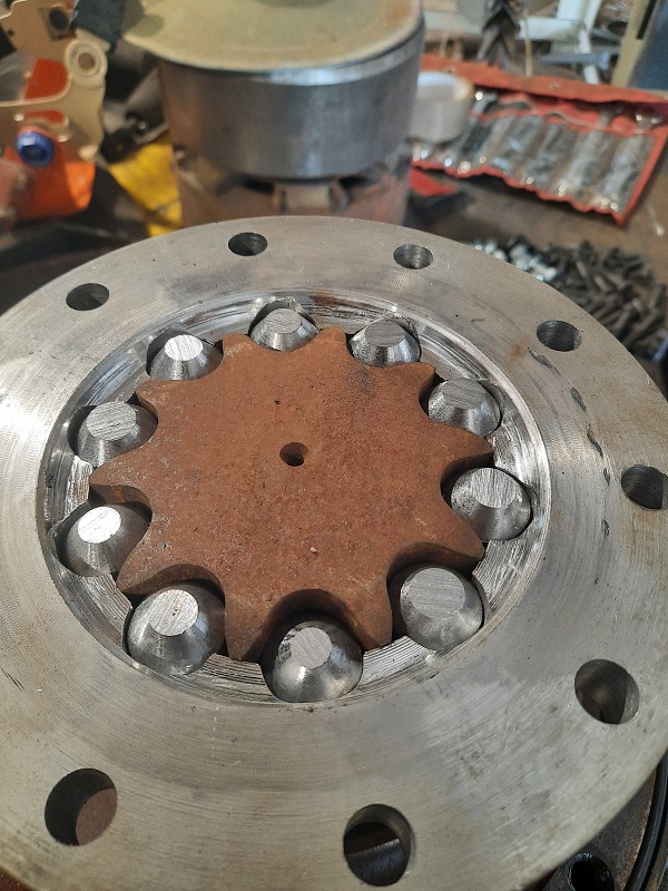

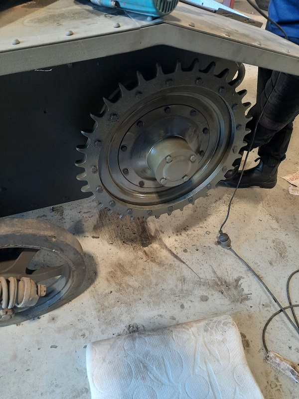

I machined up the collars to the dia of the sprockets and then milled the collars out to insert 20mm H/T bolts. The bolts were tapered in the lathe for some weld penetration.
20211024_102112.jpg   20211024_102147.jpg   20211024_102221.jpg   20211024_141027.jpg   20211024_141112.jpg
  #1144
Old 25-10-21, 10:56
colin jones's Avatar
Posts: 1,810
I did the welding over about 4-5 hrs as to not let too much heat go down into the final drive. As it is like a spline with all the bolts in there, the weld is really only there to stop the the whole thing sliding off. That is something that can never happen. Even though it is now all welded on there, it does not stop any maintenance that needs to be done to the final drive spline if it ever needed to be removed or replaced as it is held in place internally. I felt it was the safer and easier option of mounting the sprocket plates.
20211024_153411.jpg   20211025_113428.jpg   20211025_113450.jpg   20211025_162219.jpg   20211025_162228.jpg

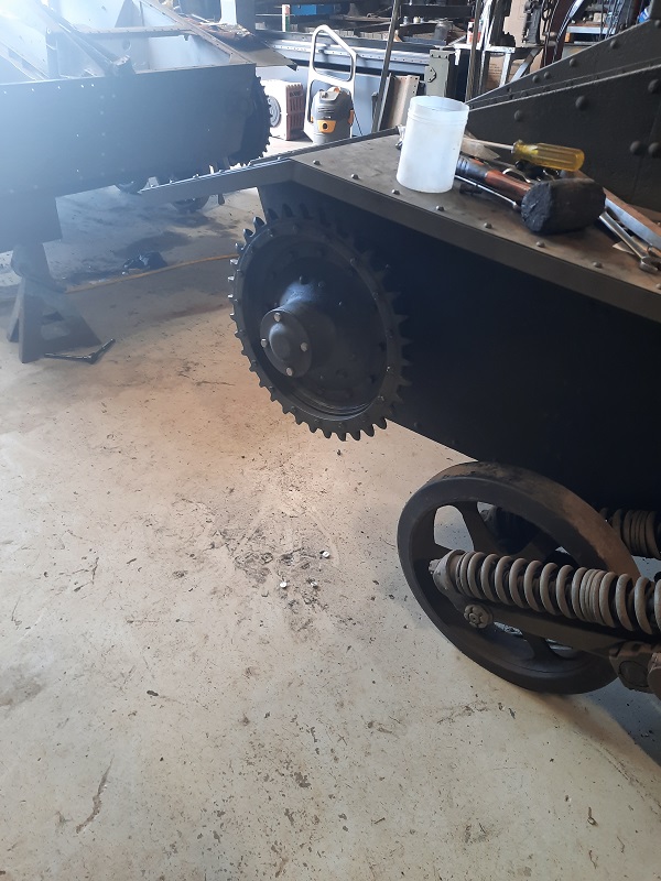

After a couple of days machining, welding and all the rest that goes with it, it was time to paint the parts and fitment.

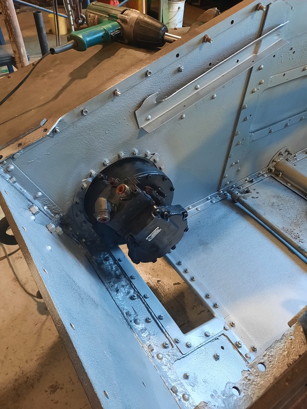

That's it for the final drives on this tank, I will be fitting the drive train to the other one next which will keep them on about par. Of course as this tank will be full hydraulic drive, it will still be operated by the original tillers which I was ever so fortunate to have both sets for each tank. All of the hydraulics will not be in any view with out lifting covers so they will both look identical but this one will drive so much easier. If I hade the trans for this one as well, I most definitely had used it.

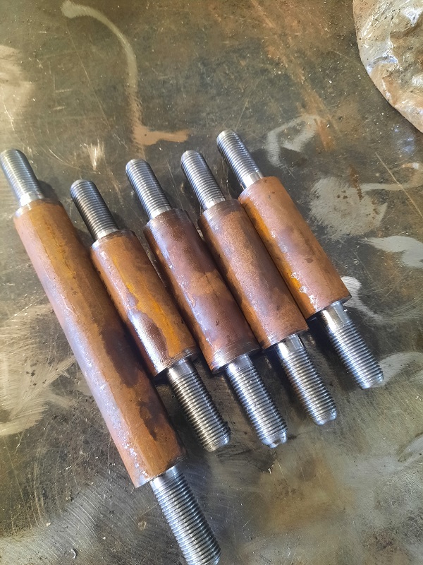

I also put the engine and trans back in and made up some clevis's and rod for the clutch which I might say works well. I just need to make 2 brake rods and the accelerator linkage and it will be ready for the final drives.

Done a few jobs today I've been moving from bench to bench . A couple of brackets that fits to the side next to the driver and also the last two rods and clevis's for the brakes. A very tight area they have to fit in but that is the last of the rods and clevis's that I need to make for Bowerbird. The engine will come out tomorrow for the last time and I will check and double check everything before it goes back in and the final drives fitted to it.

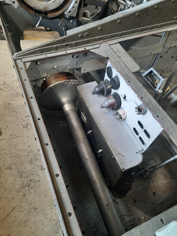

Everything that I can fit to the drivetrain has now been done and I trial fitted the axle and tube which has not ever been together like this since I made the gearbox. A bit of modification was required to some holes to get all the bolts in but I'm happy with the result. Went over all the bolts as once in place it is extremely difficult to get access to certain areas and now is the time to do it. Tomorrow will be drilling and tapping holes in the side as there is a few broken and it is easier to fix now before the drive goes back in, There is a few other jobs inside the hull that I will complete first which means I will remove the turret off Bower Bird as well. It just makes sense rather than leaning, bending and crouching.

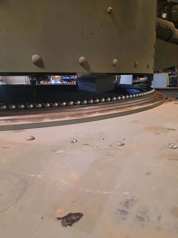

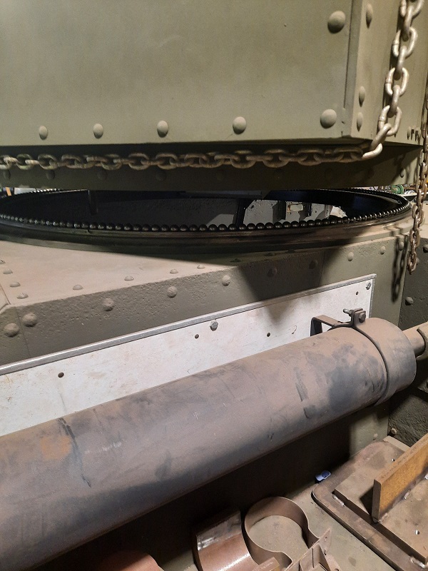

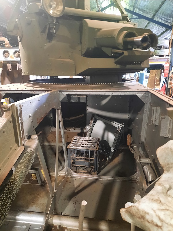

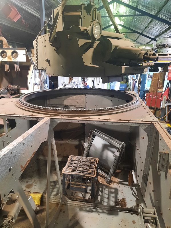

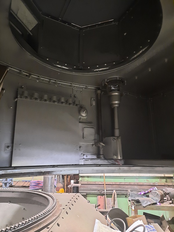

I got the turret off and checked the bearings which are all very good and just a couple of photos of the inside of the turret.
20211102_084317.jpg   20211102_084328.jpg   20211102_084340.jpg   20211102_084604.jpg   20211102_084732.jpg

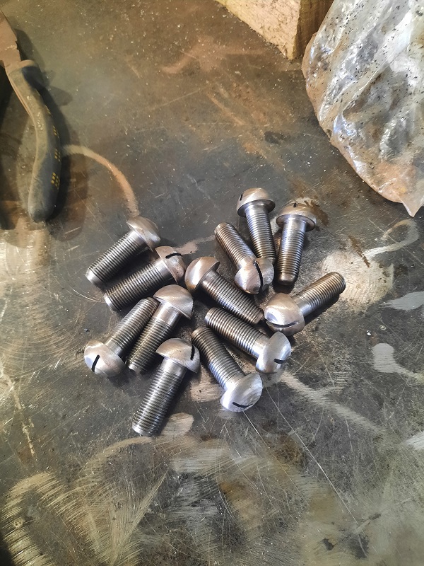

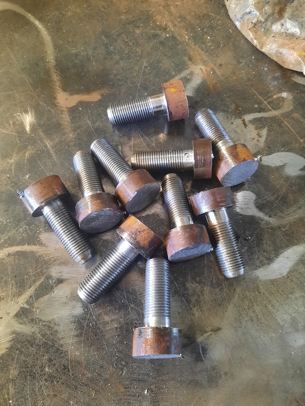

I decided to do a job that's been bugging me for quite some time. It's the round head bolts that hold the towing/ lashing points on the front of the tanks. I had some normal 1/2"bolts in there but I thought it was time to correct them and finish the front considering that's where I am basically working on.

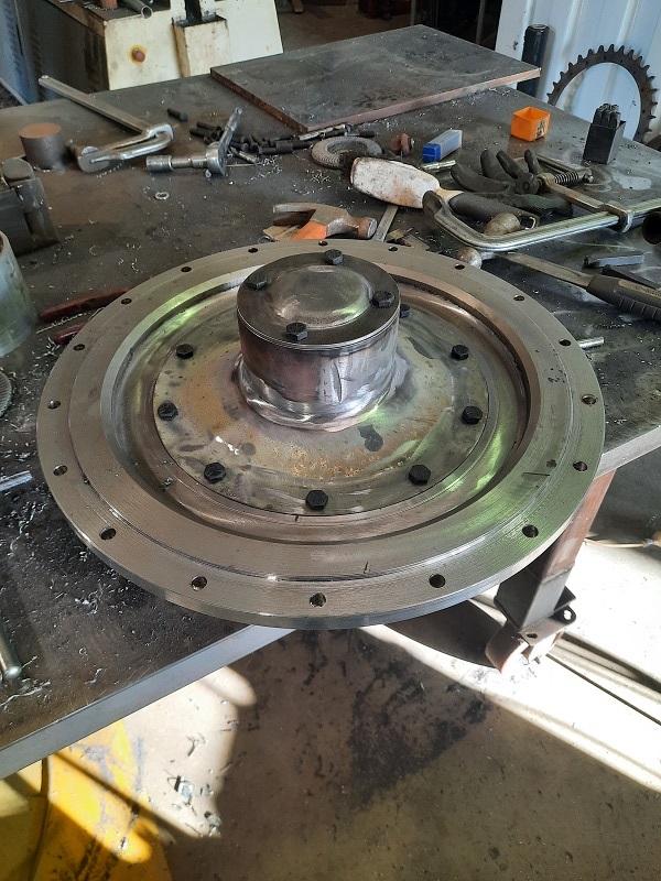

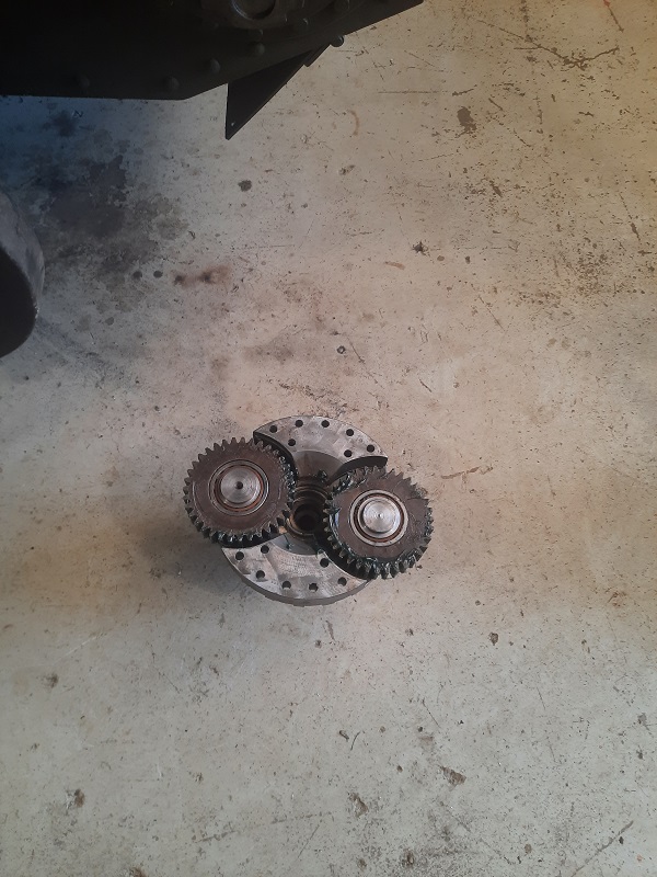

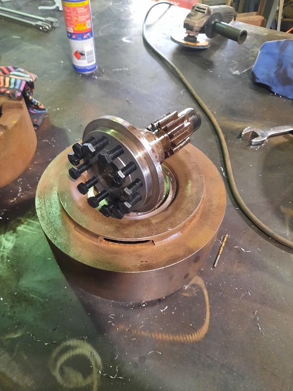

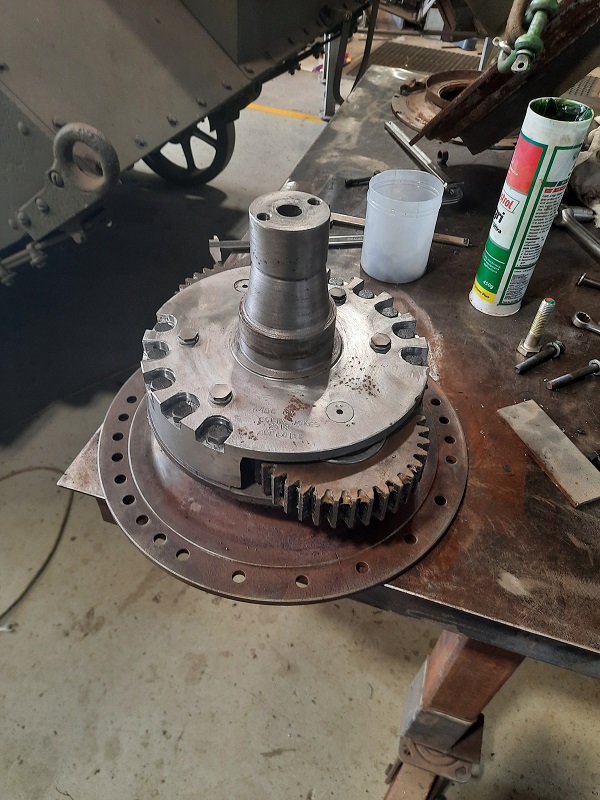

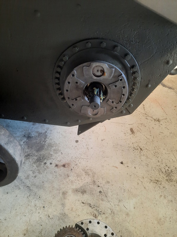

After making the round head bolts, I wanted to just put the drivers side final drive on as it was ready to do and I thought it would have been about an hour or so to do How totally wrong I was Much, much frustration. It is a very heavy and awkward component and I had to line it up perfectly horizontal, slide it over the spigot end, line up the two planetary gears and keep sliding until it slid onto the spigot bearing so it all meshed perfectly.
After a full day of on, off, on, off and not sure if I was doing any damage by forcing it on, I decided to continue this morning and disassemble the final drive and reinstall it piece by piece.
I remember removing it in one piece but that was 4 years ago and there was nothing to line up. I have to assume they did that in the field during the war as there just is no way of lining everything up unless you were really lucky. Anyway, it is now done and the other side will not be any where near as hard as this side.
20211106_095509.jpg   20211106_115010.jpg   20211106_115844.jpg   20211106_132757.jpg   20211106_132803.jpg

I'm sure the mechs had plenty of specialized tools and jigs to make their job better as I have already made a few things to make my job easier. I am really happy that they are going back together as well as they are.

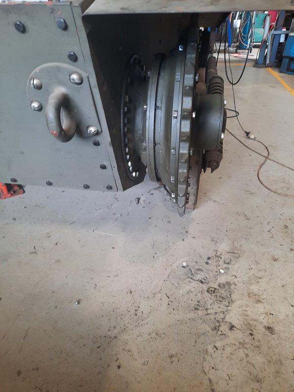

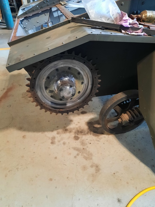

Just completed fitting the other final drive. After putting it on I found it was too tight for some reason, so I removed it and disassembled tha one as well. I am glad I did as I found I never machined the bearing cup quite deep enough so back on the lathe it went and 3.2mm came out. I also countersunk the bolts that hold the planetary gear hub as a precautionary measure.
20211107_112948.jpg   20211107_114105.jpg   20211108_122826.jpg   20211108_122831.jpg

They are now both up to speed and ready for the tracks. I will probably wait and have them running to test the drive train and steering brakes. That light is getting quite bright at the tunnels end now.🤗
