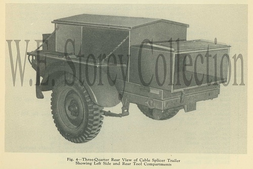

You can see the socket mounted in this image of the cable splicer trailer.
Name:	Fig. 4- Three-Quarter rear View of Cable Splicer Trailer Showing Left Side and Rear Tool Compart.jpg
