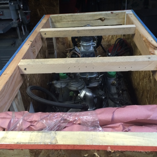

I was able to pick-up a built flathead motor from a fellow in Quebec and was able to arrange shipping from Quebec to Alberta. He packed it very carefully and it arrived unscathed. I was more than happy with the motor, it should be be a real intresting combination.

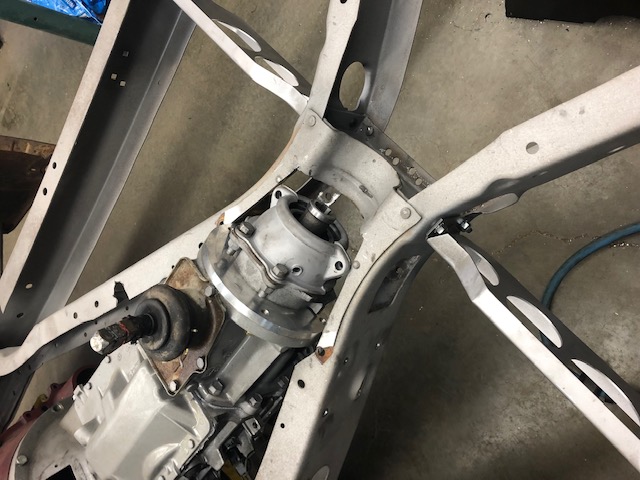

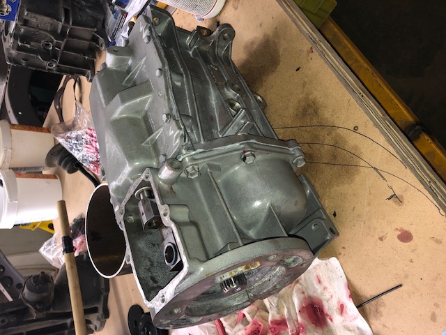

I followed the directions on the HAMB link adapting a T5 to the torque tube, it was a lot of work finding the 2 transmissions first, then I had to find a new transmission case as the one I was planning to use was damaged. I did find a NOS case on Ebay that worked. It was my first time taking on a manual transmission rebuild but crossing my fingers I put all the pieces in correctly.

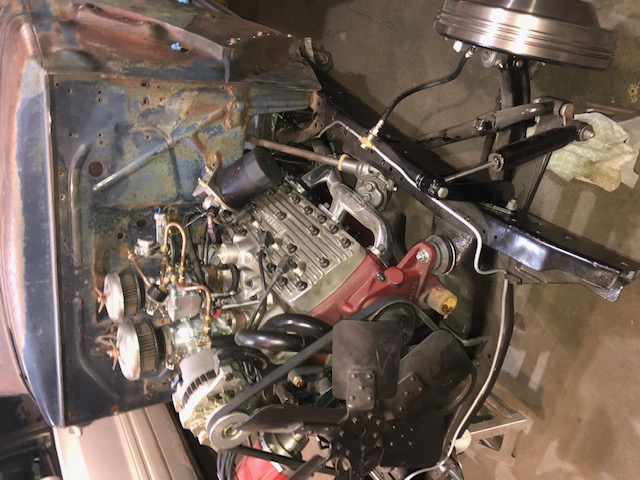

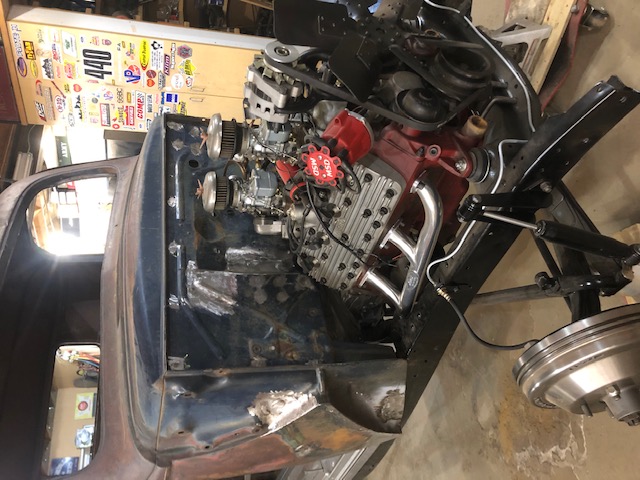

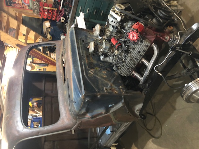

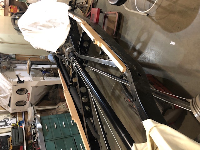

I am going to update this thread. Progress has been made. 2020 was a year of working on the frame, fitting the motor, trans and torque tube.

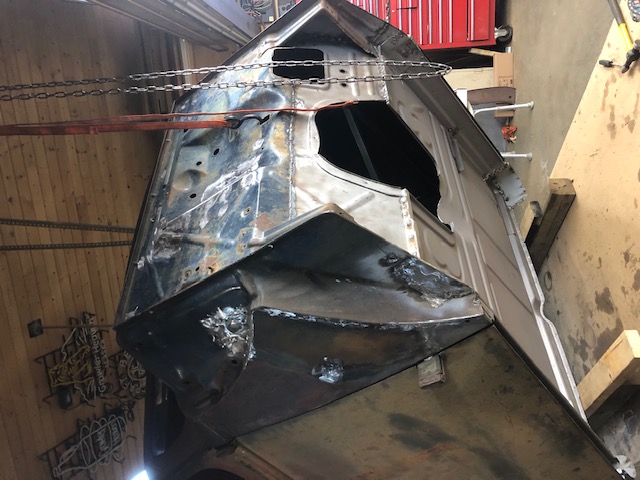

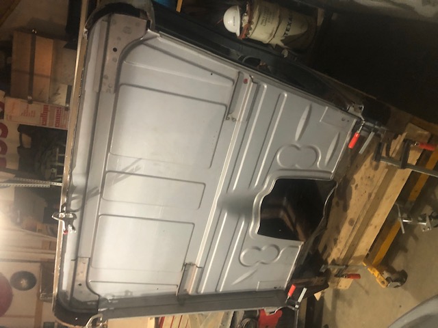

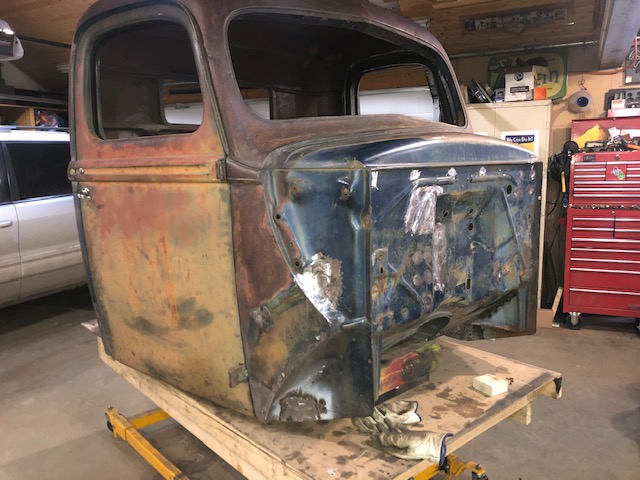

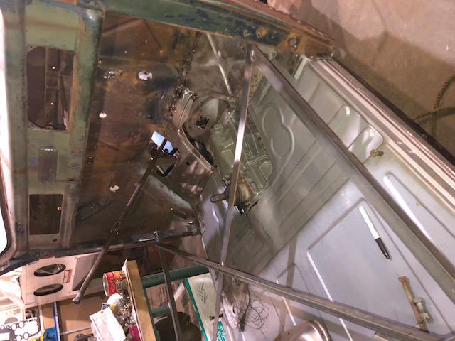

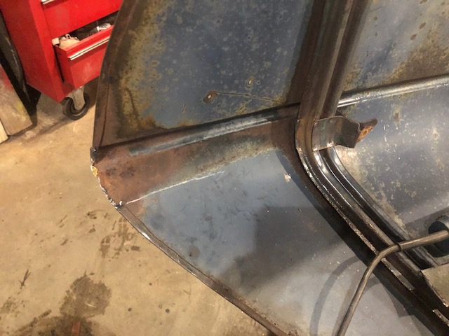

Started the cab, mounting to the frame and rust repair. A new floor was installed getting rid of all the rusted metal. Repair of the bulkhead, lots of welding and grinding.
786C8682-EEF2-4510-9658-193B1AFE19A9.jpeg   0EA60FFB-F285-4426-91C6-FEAE71EDB803.jpeg   9CB8410D-8A74-4F12-80F7-4D44A67C84B9.jpeg   65E08735-22FF-41E4-AD58-5C84FE0AA6F9.jpeg   96D75CFC-39C7-4EDB-A57E-B0DB95665540.jpeg

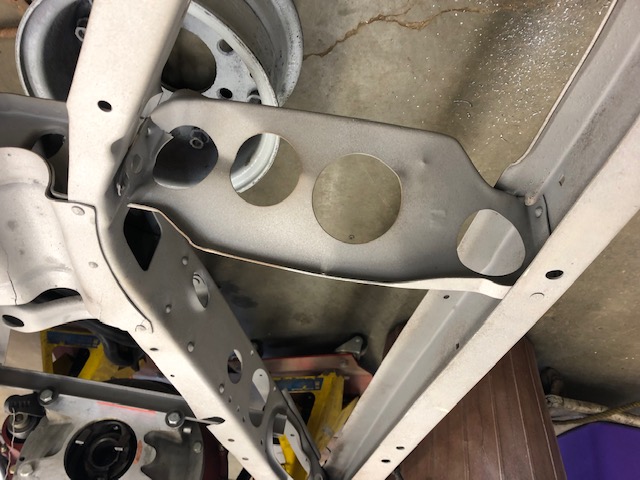

The frame is all stock Ford, old Henry must have had some good engineers onboard to determine the holes in the frame. When you really think that’s these frames are 80 plus years old now and still relatively not out of touch with current truck frames the engineering has passed the test of time. The aftermarket supply for these 40 fords is amazing, some of the reproduction parts are dead on, the floor came from George Moir out at Stony Plain, you will be familiar with him. He had a complete floor the toe boards came from another cab that i picked up, the cab corners were hard to get but a guy in Montreal made reproductions, I had to fabricated the inner cab corners myself and the donor cab gave up specific pieces for repair.

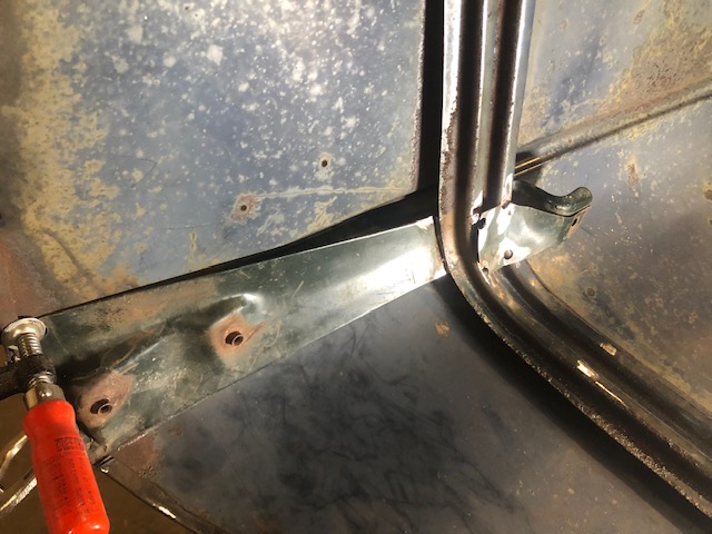

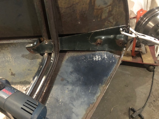

The attachment support brackets for the hood hinges were all bent up on the original hood, from the donor cab I separated the support brackets that were in excellent shape and transferred over to the hood restoring the proper geometry for the hood hinges,

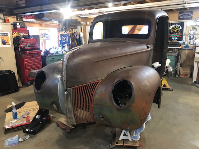

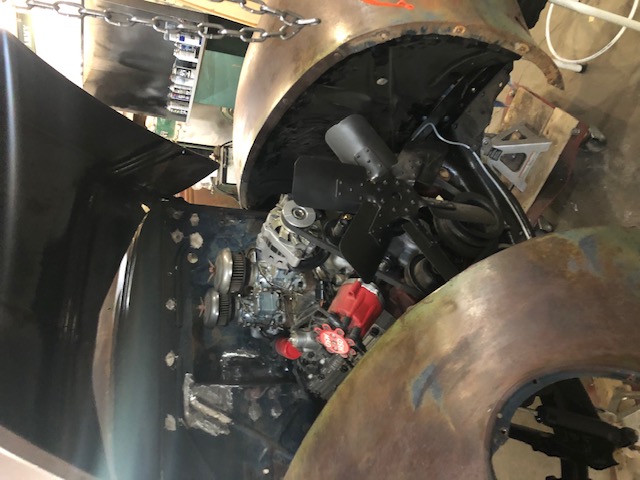

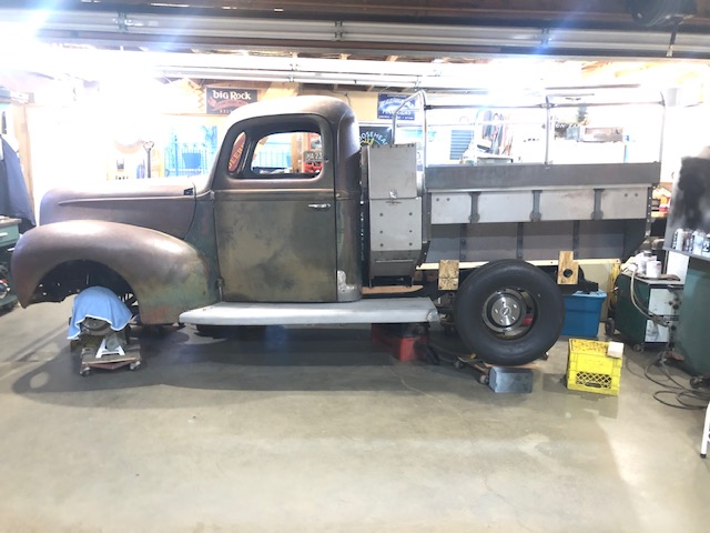

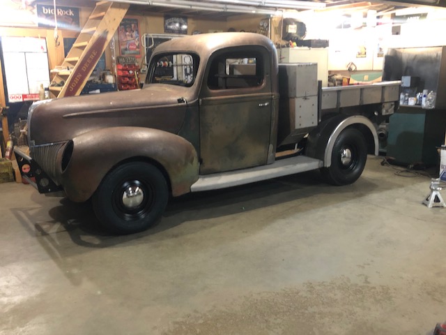

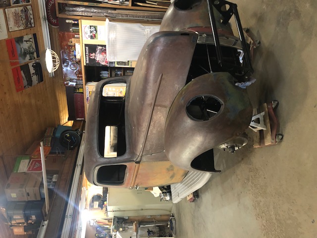

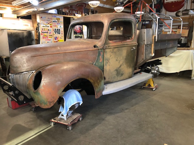

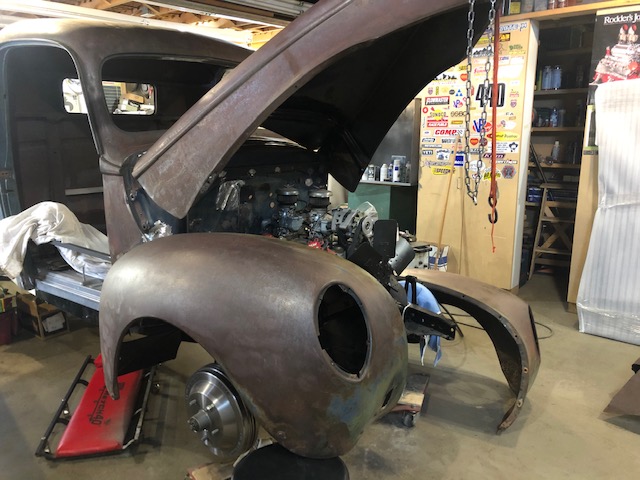

Put the cab back on the frame and mounted the front sheet metal, lining up all the fenders on these trucks is a pain. The front fenders float on a yoke at the front and all parts need to line up loosely and then tightened.
CD1EC684-633B-4E72-A1D7-FD0762F81DDF.jpeg   BB84ABDA-390A-4BA8-9E83-EF67C4D48BEF.jpeg   BED38E1E-C78A-436C-A5DA-5B36A3CC84F7.jpeg   CB885A46-13EA-4970-B1AB-62BD27B580EC.jpeg   E21AF9F7-B2DB-4DC4-9CBC-AF3D1AF00F4B.jpeg
  #76
Old 11-01-21, 06:15
James Y James Y is offline
Join Date: Aug 2013
Location: Edmonton, Alberta, CDN
Posts: 123

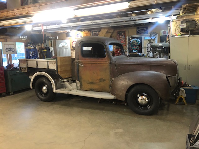

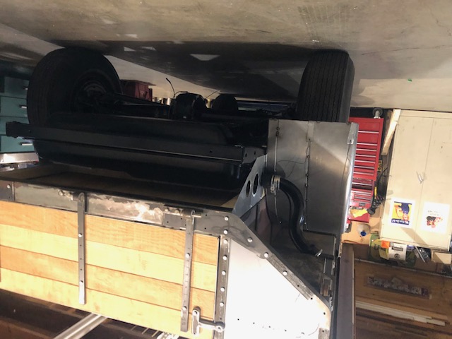

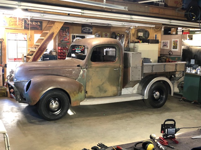

Added the 800wt, box and tool boxes and running boards.

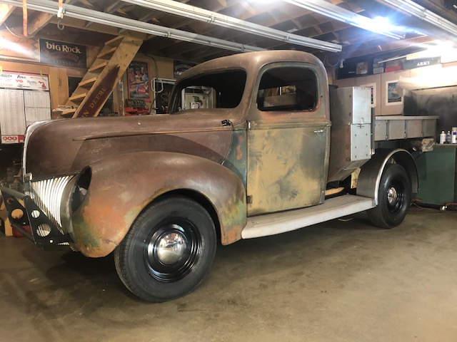

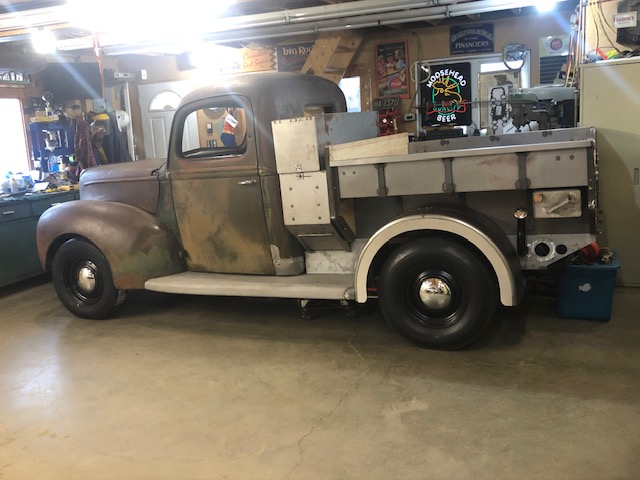

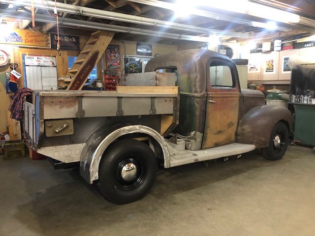

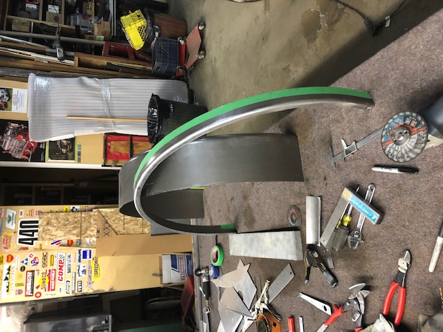

Still figuring out the paint, I would like to leave the original rusted look, just trying to figure out ho to deal with all the new metal.

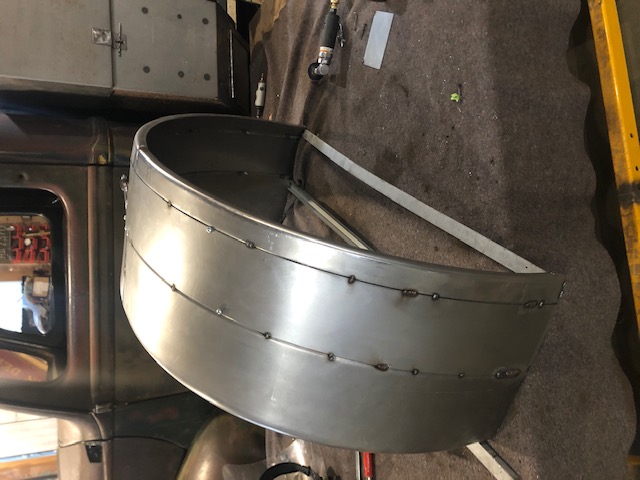

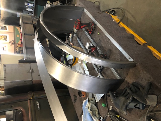

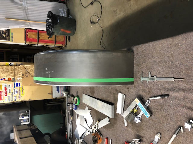

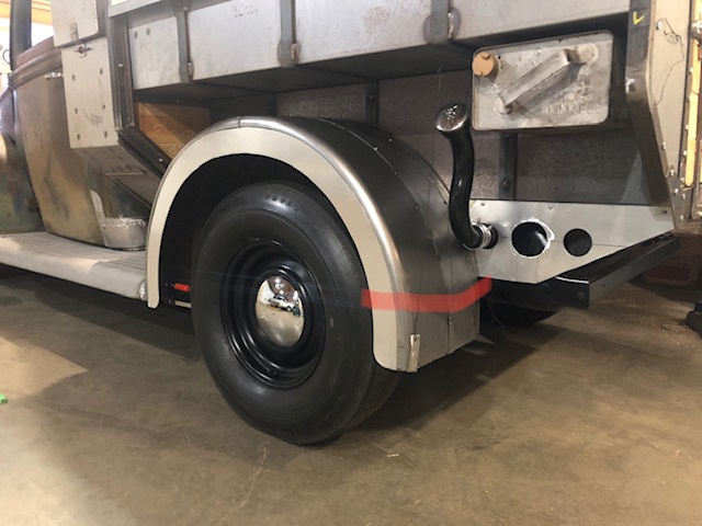

Now down on the ground, my cheapo rear fenders need major work, sliced them apart and added 5” so the fenders will match the running board width.
1A83B2F8-5220-47A2-8B92-0D89B6CAEE07.jpeg   CD34110A-2DD1-473D-BB1C-7424689324F8.jpeg   FD730E33-C96C-4D21-A3F5-780258F2A029.jpeg   21E88C03-E7F8-462F-A0EB-65E39234A6A2.jpeg   0AF19D40-FB43-43CE-91C4-3E4A86A2FDCD.jpeg

Fenders mounted, need to shorten the rear of the fender to match the frame.
BADDB439-A13A-4ECD-8FA0-F547AA047876.jpeg   DA7DBAC7-72B0-48ED-BF22-B6220BEA1B67.jpeg   B0EE49A7-B854-44F7-9F1D-38FCB865EE90.jpeg

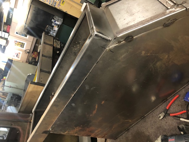

Made the frame to hold the tool boxes, probably overkill, but did not want any bending with the weight of the boxes bouncing down the road. Filler panels under the box are made. More welding and grinding are on the agenda.
E6D0ED68-E681-4736-A562-4ABBC5FED1B8.jpeg   3A391B25-C3BD-4C86-BC7B-3C63EA7E07F3.jpeg   4228E339-6F37-488D-96D2-2185F14F9615.jpeg

Built the fender for the passenger side, this is also the side that holds the spare tire.

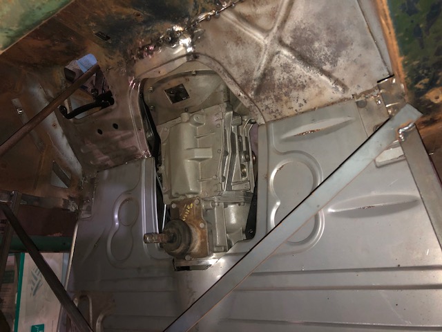

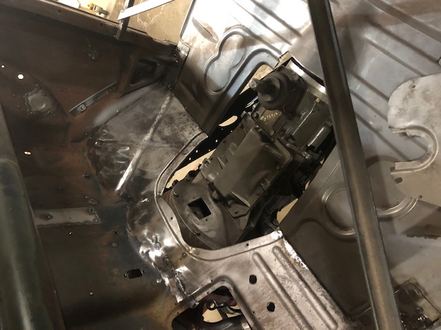

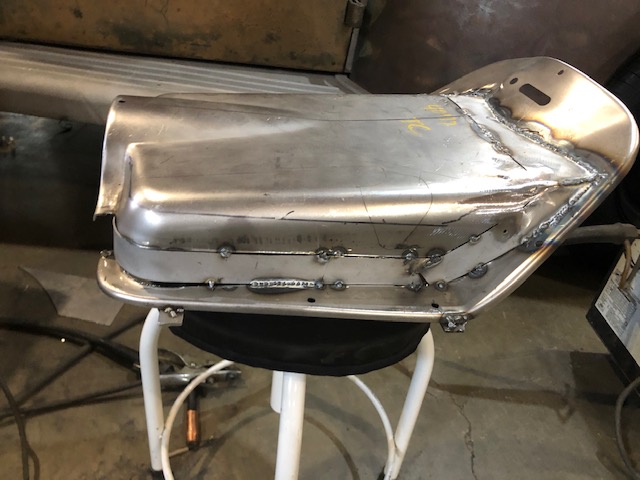

With the T5 transmission the stock cover was too shallow, with a lot of grinding and welding I raised it up 1”. Still need to figure a nice way to do the transition at the back of the cover to the floor.
58E5FAD1-AC48-4A80-90D0-32A1AF429F7A.jpeg   D6B45D18-6EDC-4012-8379-6366181BD378.jpeg   59932A38-A807-477F-8F7F-74C147726309.jpeg   B4945DE0-22E4-49DE-A949-E6FCFE720704.jpeg   6A306533-A5BD-4ED9-9384-8836F3569C9E.jpeg
