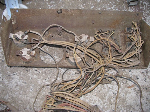

Good Day,
I’ve decided to re-do my 25 year old wiring harnesses on my F15-A.
A number of reasons:
Basically back in the mid-nineties I copied non-original harnesses that were on my first truck. At that time I did not even have a Repair Manual for a wiring diagram so I copied the colours and wire gauges as best as I could estimate from the existing harnesses. A bad call in hindsight.
Interestingly, those harnesses I copied used plastic covered wires but they were in original looking woven cotton shrouds. I am surprised they weren’t cotton braid covered wires, but perhaps someone went to a lot of trouble to run wires through the original shrouds even if wrong colours were used.
Another consideration was adding turn signal wires. I know it isn’t original but I believe it is essential in modern traffic to have them. The wires are less obvious inside the new original style harnesses. I made them slightly longer to differentiate them from the original wiring and give a bit more clearance at the solenoid.
I also wanted to add the Autopulse wire to the harnesses. Although not used on Australian vehicles it could come in handy to add an electric fuel pump, if required, at a later date. The wire was fitted originally even if not used but I left it off my first version.
I had hoped to use cotton braid covered wire but I opted for modern automotive wire instead. In reality, very little of the wire is visible so I couldn’t justify the high cost of a commercially made harness. I would not be able to reproduce the woven cotton shrouds anyway so it made even more sense to go with modern wire. I used vintage style bitumen impregnated conduit for the shrouds instead which, although not original, looks in keeping with the era of the truck. I spent about $175 for all the materials.

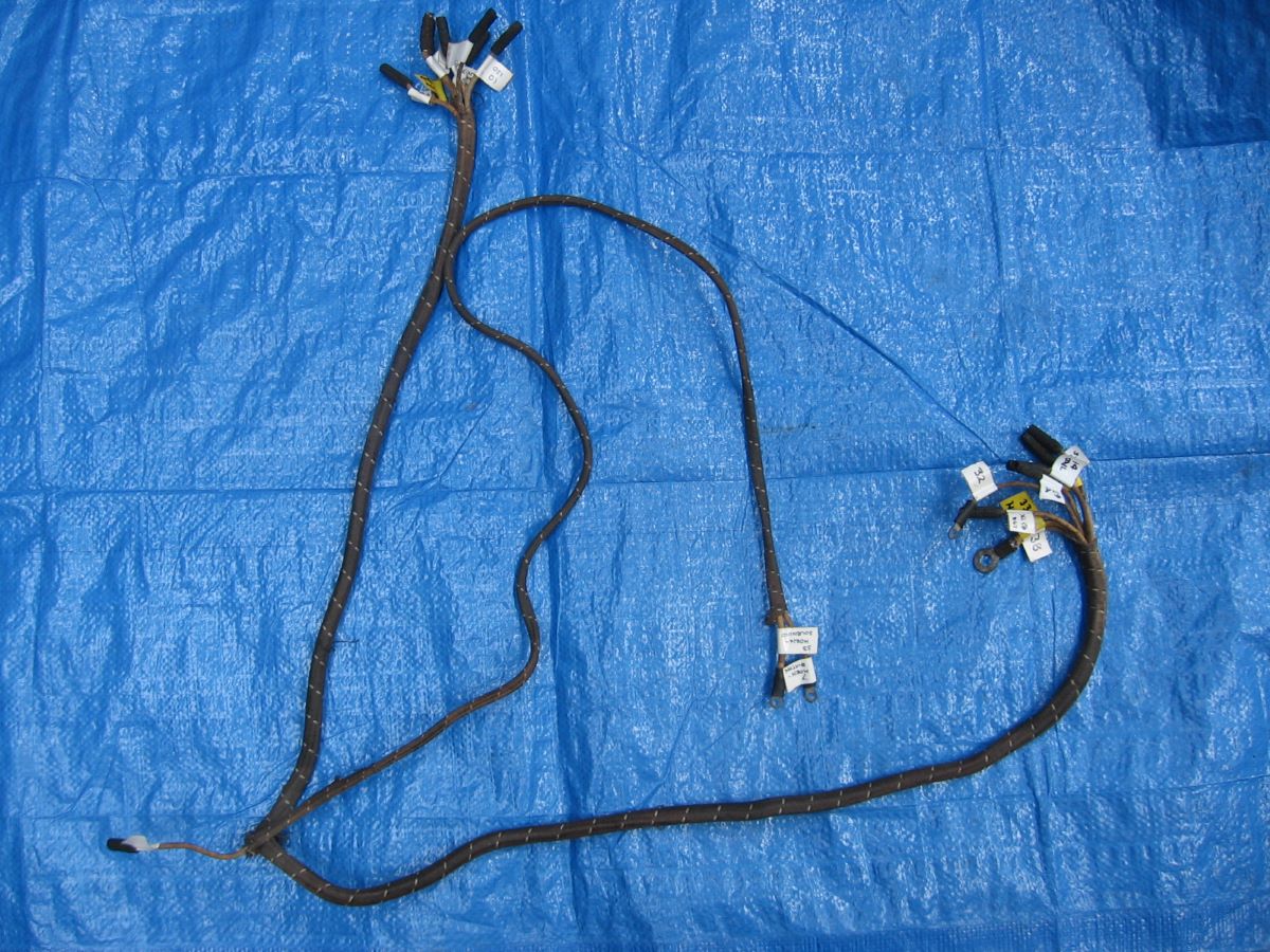

I obtained a rough, but complete, main harness a while back and a NOS horn (lower chassis) harness for patterns. Over time, I have measured all the lengths of wire and tabulated what I needed in colours and wire gauge.
I used Tycab Australian made automotive wire throughout. I tried to use trace wires wherever possible to identify the wires similar to the original colour coding. In some cases the wire/trace colour combinations were just not available however. In those cases I added a length of heat shrink tubing of the appropriate trace colour to identify it.
I made one exception to the original colour codes. I made the horn wire from the solenoid orange/green band to avoid confusion with the left fuel sender. Both are normally yellow/green x 2. Only a few inches of the horn wire at the solenoid is visible so I can live with that.
So the instrument panel is done, the horn harness is done, so just the main harness to finish off. All wires for it have been cut and run so a just bit of soldering to finish it off.
Hope this is of some interest.

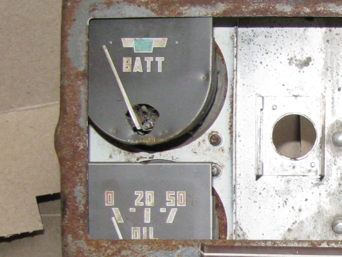

1939-40 Fords, Mercs, and Lincolns, and early war CMP’s used a gauge with “BATT” displayed on the face which is really a voltmeter. Ammeters display “DIS-CHG” on the face. Later in the war, the Ford commercial instruments, used in the CMP’s, were changed from battery indicators to ammeters. This was prior to the military round gauge instrument panel being adopted. As of the May 1943 F15-A Spare Parts List. however, only “Battery Indicators” are listed, and not ammeters.
On indicators with “BATT” displayed the current flows from the starter solenoid first to the voltage regulator battery terminal, then to the ignition switch, and then to one terminal on the Battery Indicator. The other terminal on the indicator goes to earth. This is shown on all the early wiring diagrams and is correct. I must admit I thought in the past that was wrong but I was looking at my ammeter’s wiring and not that of a voltmeter.
When the Ford commercial ammeters replaced the battery indicators on CMP’s the wiring could be the same for both the Ford gauges and the military round gauges. The current flows from the starter solenoid to the ammeter first, and then to the voltage regulator battery terminal. If an early BATT gauge harness is used on an ammeter equipped truck or an ammeter harness used with a battery indicator equipped truck it could cause serious electrical problems.
Things to keep in mind if repairing, making or buying a wiring harness, or changing gauges.
And yes, the battery indicator and oil pressure gauges are on the wrong side in the photo and “BATT” should be on the bottom. That’s how I bought it.
I have been told the gauges are the same and can be used if you change the faces, but you can only swap a BATT, not an ammeter, with the fuel gauge, and the temp with the oil pressure gauges due to the mounting hole positions.

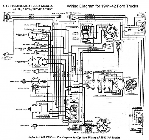

Added a 1941-42 Truck wiring diagram showing the ammeter in series.

Name:	wiring diagram 41-42 truck V8 only.jpg

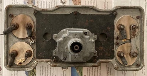

I'm not sure of the significance, but in Australian carriers, If they were fitted with the battery gauge (volt meter), then they usually had a three brush generator. If they had an amp meter, they were usually fitted with the two brush generator. Hopefully I have this the right way around, without looking in a book.

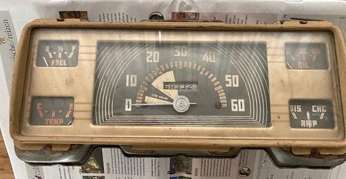

Here’s a photo of my spare instrument cluster. It has an Ampere meter but it is wired separately from the oil pressure meter - there is no bridge.
Now I need to study the various wiring diagrams to see if it can be wired in in my 1943 F15A which has the BATT meter (last photo).

.....even lowly Chevrolet have a Amp meter.....but really does not tell you much except your system is charging....or an even keel or running on the battery and discharging.......
Neat idea with the solid brass bridge as it must eliminate a whole bunch of wires.
On the Chev, along with the builtin bypass, all my power wiring has to be first connected to the Amp meter which makes for a very cumbersome nest of wires on one bolt connection....... which forever needs tightening!!!....my dash lights are not working now...guess why???
A volt meter, or engine oil temperature gauge, and vacuum gauge would be much more useful......

Hi Hanno,
Just had a look again at the back of the Ford Cluster. I think the brass bridge between the ammeter and the Oil pressure gauge should not be there. That is used with a battery indicator type gauge to supply power to all the gauges when the ignition switch is thrown.
Will have a look at the wiring again later today and make up a revised Ammeter equipped wiring diagram at the instrument panel using Mariano Paz's great information on the late war wiring plate.

Name:	CMP wiring 1943 schematic.jpg
F15-A 1942 Battery Staff
Jacques Reed
Last edited by Jacques Reed; 05-09-22 at 04:25. Reason: swapped wires 38 and 38A on diagram
Thanks Jacques. I've always thought that my BATT meter did not do much, I now found it has a live feed (bridged to the oil pressure gauge), but no wire to ground - see photo. This makes me wonder why it was moving at all? Will add a ground wire and see how it behaves.
PS: the white terminal block will be removed. I noted this loose yellow & red wire dangling under the dash and it turned out to be live. Using the diagrams on here I found this is the feed to the inspection lamp socket. This socket was removed in the past to make way for a traffic indicator switch.
Will look at that in detail later. I am trying to get a better understanding of my F15A's wiring, making it work better and meanwhile draft the specs for the new loom I want to order.
I may switch from the BATT to AMP meter, though I plan to use an electronic regulator. I've just replaced the indicator/ flasher relay by an electronic one, and it is a huge improvement because it uses far less power and it is independent of load. I am becoming a fan of modern electronics. I recently fitted an electronic distributor, quite an improvement so I plan to add more in an effort to improve drivability and reliability.

Hi Hanno,
Just looking at your picture there should be a wire, 30A, a jump from the oil pressure gauge brass bus to the Temperature gauge brass bus to supply current to the Battery and Oil Pressure gauges when the ignition switch is thrown.
There should be wire, 30, from the ignition switch to the Temperature gauge brass bus to supply current to the Temperature and Fuel gauges and then to the other gauges via 30A.
The wire into the Battery indicator is my concern. If it shows voltage only when the ignition switch is thrown then it is wire 30 and can be connected to the brass bus at any gauge to supply them with current. Diagram shows the Temp gauge but any brass bus is the same electrically.
If for some reason that wire into the Battery indicator shows voltage continuously it could be coming directly from the Battery via the regulator and therefore your wiring is setup for an ammeter. If that is the case it could cause a serious problem to the wiring and gauges if the Battery indicator is sent to earth. A quick check will determine if that wire is "hot" only when the ignition switch is on and therefore set up for a Battery indicator.
I have found with numerous owners over the years and many jury rigged wires on these vehicles it is best to check and double check. My first truck had many disconnected wires and even house wiring used in some places!
