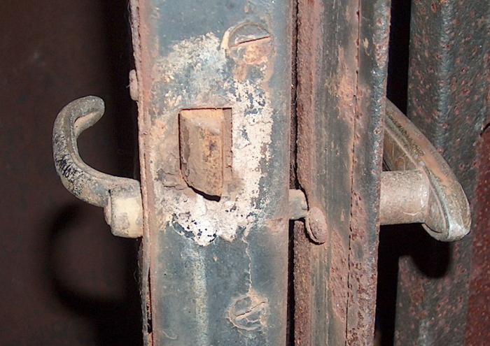

See pictures below.....
The good one is from the cab 11....the bad one from a cab 12......
These Wedge parts are available from Mac Auto Ford......
The next Photo is where the wedge fits in the door.... in most cases the sagging of the door has caused some extreme wear of broken parts....
...and the resulting damage to the wedge,,,,,
Now inside the door frame is this ..Ford again... latch which is usually broken...
Now for the latch removed..... in a number of cases at least one of the rubbing blocks willme missing ... having fallen off when the tab broke.
on to the next part....

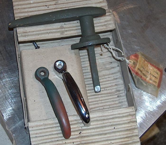

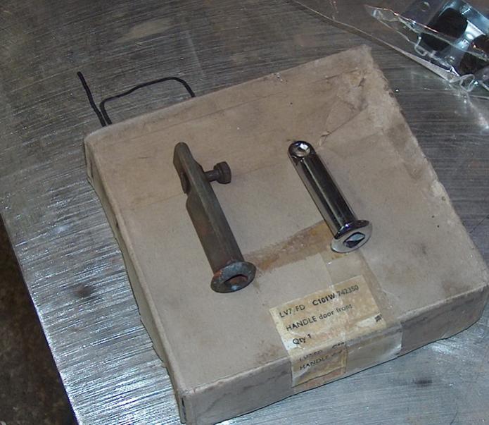

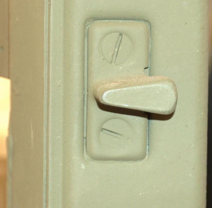

The following are pcitures of the replacement latch mechanism
... the actual lock mechanism and NOS cab 11 door handles both inside and outside.... you will notice the chromed repro from MAc Auto... again made in China butr very close to the original.... see back side for difference in casting... once sandblasted they will take OD paint quite well....
One more photo showing the replacement pot metal tubes for the side curtains.... they are slightly shorter but will be made to fit... tweo are needed per doors.....
Last is profile look at inner and outer handles....

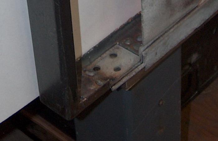

Removing the door skin at first appeared fairly easy since some doors were so rusted that we did not detect any spot weld..... has we progressed to areas not so rusted we found that the folded over outer skin had in deed been spot welded...... spot weld cutters.... very sharp samll chisel and the typical abuse of a good screw driver had them popping in no time......
soem doors were so corroded and thenetal so fatigue form years of door slamming that the skin and part of the frame was coming apart.. ley me show you.....

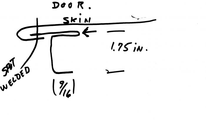

Here is a crude sketched of the profile of the door frame and its weak areas...
the frame is folded back onto itself to provide an area for the door skin to be folded and spot welded to...... with rust and constant door slamming the over folded area breaks loose at the arrow. Far too complex to reproduced we have opted for a simple U bent frame and we will cut out an exact duplicate of the folded over part except ours will be spot welded to the frame and we hpe more solid. The oly part that is different on the frame is the top part which is covered by the external door skin and is actually 1.75 inch wide plus the tickness of a 14 guage sheet.... in the case of the top part the metal is actually folded inside the U shape of the frame.
So we got our courage and cut off the bottom of the door.... you can see the repro part Grant and I fabricated. We simply made a pattern out of old 2x6 lumber and heated and bent the U shape frame by hand.... once hot enough it bacme very plastic..... yeah the wood charred but that is Ok....
We made the cut up to the good metal on the curve side..... and just below the hinge position so as to maintain dimensions. Grant measured everything 3 times beofre cutting and we still had some complete doors to fall back on in case of dimentia....

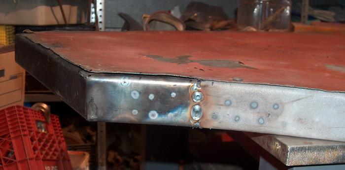

The semi finished product..... still some touch up grinding... don't want ot make it too perfect or it will not look original.....
Concerned with getting the door the exact size it was before.... Grant had the excellent idea of bolting the inner skin back on as a jig for positioning the replacement bottom part..... sure made things easier....
Of course being Public servants and overly cautious we opted for a re-enforcement plate on the inside the frame to give more strength to the door frame.... we also had no wartime metal shortage.... I predrilled the inside plate and welded from the inside.... with proper penetration it almost looks like spot welding work.....
The other side was also re-enforced from the back side but we had to cut out the space for the hinge...... we had to cut out other wise the hinge would have been 14 gauge out of alignment,,,,,
Final picture....... no bad for a bunch of government paper pushers.... of course we still have to replace the large plate at the bottom.... half was cut away as being too rusted.... but it was supper time and it was time to go!!!

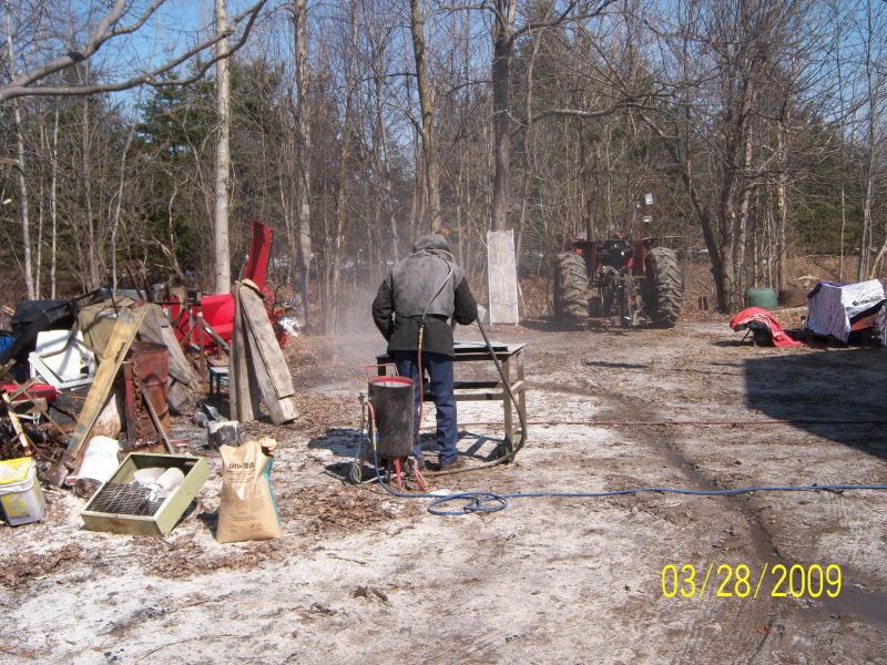

The Hammond Quartet was in fine fettle on Saturday - we all behaved ourselves (more or less) at Gracies last night, so there were no major complaints in the morning.
Myke from Wyndsor joined us for a day of slave labour. He and Grant took a tour of the wagon lines (wading thru the mud was fun) upon arrival. Nothing like the sight and smell of CMPs in the mid morning mist...smells like...obsession! Bob joined them thereafter.
Just after the two entrepid ones took to the mud, Guy arrived with the morning coffee and tea (for Bob). Guy lent a hand fixing my fender pans onto the front clip - much appreciated, amigo.
When the tour ended, the entourage made its way back to the barn and coffee. Bob and Guy chatted about the excitment in their lives - CMPs of course...

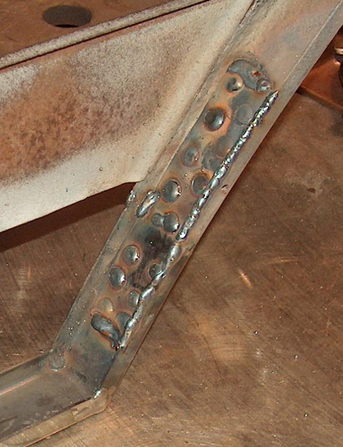

Myke and Grant took on the task of welding up the holes in my Chev grill.
The master at work:
They used common nails pounded flat and welded them in. They also joined the broken off pieces of the expanded steel grid.
After some time with a file, it was difficult to pick out where the repairs were made. After sandblasting and painting, it was impossible to find the welded in spots. Good job lads! The grill was temporarily fitted to the clip and sure makes the front end look great!

Sunday morning's calm was interrupted by the sound of an air wrench as I followed Bob's lead and swapped the winter tires for the usual all season tires. I expect snow this week...

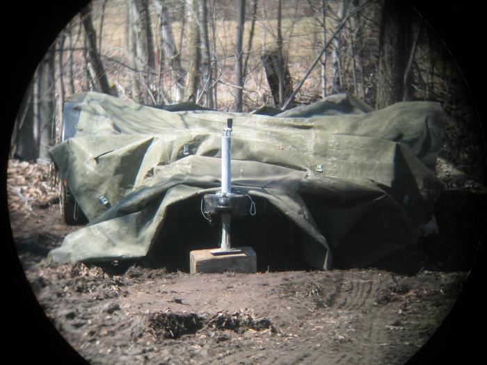

After that task, I started to set up a new shelter for the storage of the Prototype. Grant arrived on the scene as I was putting together the skeleton frame of the shelter. Guy arrived shortly thereafter. Both were press ganged into shelter duties. The outer skin was put on and secured to the frame.
Right on cue, Bob made his way slowly to the barn. It seems our chum isn't feeling just right these days. But that did not stop him from standing in and walk-marching the shelter over the Prototype. After nailing together some footing boards, Bob and Grant bent up some rebar as anchors. Four lengths were heated near the tip and bent over forming a hook at the end. These were set into the ground and tied off to the shelter frame. It should hold -eventhough this is a temporary location, these shelters tend to take flight if not properly secured. Seems to me sightings of a flying shelter were made near Kars recently...
I of course took some photos to commemorate this event, and Grant came upon the realization, that while I was taking the photos, the subjects of the photos were doing work...busted! Arguments about recording the history of the barn were met with the expected replies...Guy laughed it up a bit then left to help some other deserving souls.
After a lunch in Hammond, Bob took a siesta. Grant and I restocked the inside wood supply and then we worked on the Prototype - and gave thanks that the mosquitoes have yet to make their bloody appearances. I decided that I would like to see what damage was inflicted on the roof by mother nature. Both the front small and rear large sliding hatches were gummed shut with more than a lot of tar. The front hatch cover came away without too much of fight and I was pleasantly surprised of the good shape it was in.
The rear hatch opening hardware was rusted into place and would not rotate. So, we soaked it with penetrating fluid and will wait until it does its magic. Initial assessment - the roof has to come off and it seems that it should, being bolted to the upper vertical panels. There are a lot of rust holes along the front edge and along the rain channels. It may take a lot of time and spot welding to replace the rotted away metal, but it will be worth the effort.
Grant gave the interior a blast with the air hose and I think the Prototype lost about 25 pounds...We decided to let the dust settle and have a go at the truck next week. Thanks for the help Grant, Guy and Bob. It was appreciated.
