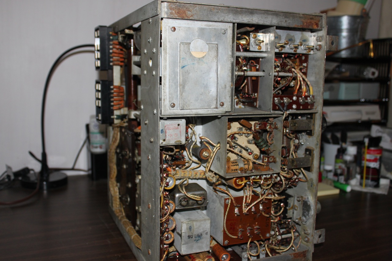

I had my fingers crossed there was logic behind the layout of the three sets of resistance tests (there are no guarantees with electronics design) and I was happy to discover the testing sequences in each test indeed follow the Sender Block Diagram, starting at the front end with the Master Oscillator Tuning Circuit built around V5A, a 6V6G. They then added in V6A (the VR 150 Voltage Regulator) following into the Amplifiers V5B and V5C and arriving at V7A (the impressive 813 Power Amplifier). Testing then moved to the Audio Input Circuit V1J (ARP-3) and V5D, which ultimately end up at V7A as well.
Starting with the first test set, the first thing I noticed was I had good results through the first four blocks of the Sender (V5A, V6A, V5B and V5C) with the exception of Pin 1 on V5A, V5B and V5C.
A quick look at results on the third test set showed good results across all these valves as well. The problem showing up with the results on Pin 1 was that each test to ground should have produced a reading of 1 meg worth of Ohms. My readings were 1.50 meg taken from the top of the sockets; a little too high for my liking. From the bottom side of the chassis, access to the V5A socket is completely blocked and parts of the other three are tricky to get at as well. The real annoyance, however, was that Pin 1 on all of these valves is an open pin, never used by the valves and the designers take advantage of this feature to use the Pin 1 terminal on the socket as a connection tag to solder leads and wires from other components to, in order to complete other, often unrelated circuits. The issue with this is that when you look at the circuit schematics for any one of these valves, connections to Pin 1 do not show up. They are blank. The only way to find out what is connected to them is to actually look very carefully at the actual terminals on the sockets and hope the connections can be easily traced to identifiable components.
So before being able to dig any deeper into the resistance test results, I needed to get a better look at what was going on underneath the V5A socket. The attached photo shows what this section of the chassis looks like from the bottom, covered with a heavy metal plate with the Modification Card Holder mounted to it.

I tend to be very careful when taking on something new, that I know nothing about and gaining access to the metal box hiding this circuit is a prime example of that action. I had no idea at all what was inside, or where and how it was mounted. I could see an access hole in the lower rear chassis wall for purposes of tuning the coil, the V5A Holder (socket) on top of the lower chassis and that was about it There also had to be a switch lurking inside somewhere for purposes of selecting Crystals.
The first discovery was this piece of metal did not exist in the Illustrated Parts List at all, first or second Issue. It was not a cover, a plate or a shield. Not an encouraging start. I then thought about the existence of the Modification Card Holder fitted to the bottom and wondered if the installation instruction for the holder might shed some light on things. It did. It was called a ‘Plate’, four screws held it in place (2 top and bottom in the photo in the previous Post), and the Plate was to be removed carefully.
After looking closely at how the Plate was installed in the Sender chassis, I could see the outside end was slipped in behind the lower left rear side of the Sender chassis rail, in behind the heavy reinforced rail the Sender slides in and out of the Carriers No. 4 on. The inside end of the Plate just slipped in beside an adjoining chassis compartment wall. So, with the Sender resting on its right side, putting the heavy rail at the top, I removed the four retaining screws and lock washers. The plate was a snug fit. I had to very carefully insert a slot head screw driver blade just into the open slot either side of the Plate at each lower side and ease the Plate out enough to be able to grab the lower edge with my fingers and pull it free, but not out. While holding it in place, I then slid the screwdriver blade carefully up the slot to the top of the Plate to keep it flush with the chassis rail. If this end of the Plate slipped inwards, it hung up on something unknown. Once you can clear the inside end of the Plate from the partition wall it attaches to, you can move the lip of the Plate inwards enough to allow the upper end tucked behind the chassis rail to drop free, and remove the Plate.
The four photos here illustrate the location of the four screws the Plate is mounted to the Sender Chassis with, what the bottom of the Plate looks like once removed and what the inner (top) of the Plate looks like, full of dirt and dust bunnies.

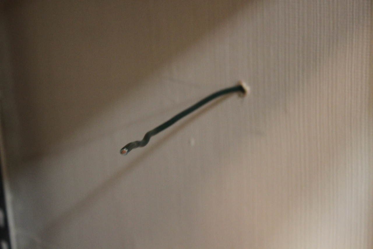

The real surprise in this exercise was the discovery of the hole, roughly centered in the Plate, which is effectively blocked by the Modification Card Holder. My initial though was it being another access hole for tuning something. NOPE! Turns out it is a ‘finger hole’ thoughtfully designed into this Plate by Canadian Marconi to make removing and installing this Plate an easy task to accomplish. My guess is that any surviving Senders in the UK will still have an easy time working with this Plate. Canadian owners, not so much.

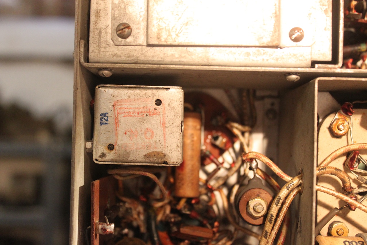

Finally, my first look inside this section of the Sender chassis. What struck me was how clean everything was, with little or no dirt and most important, no sign if heat discolouration or burnt smells lingering about.
The most notable thing was the pristine looking L31A COILS, RF sitting front and centre, complete with its CMC Part Number stamped on the side of it – CMC 119-209. I am not sure what prompted me to do it, but I decided to run that number against the Parts List at the back of the Operators Manual. Did that ever turn up the excitement!
According to said Parts List, L31A had Part Number CMC 119-107. The number stamped on the assembly in my Sender was nowhere to be found. So next stop was the 1945 Illustrated Parts List. It showed L31A as being, COILS, RF, 1.75-4-mc, MO, No. C1. It had a 1-1/32 inch diameter with two riveted 6-32 mounting screws at one end and no sign of a central, adjustable core. The ZA-Number reference given was ZA/CAN 4355.
A pail of tea later, I decided to check the 1948 Issue of the Illustrated Parts List for a possible explanation. Bingo! The same reference for ZA/CAN 4355 was found, but this time, directly below it was a second item, ZA/CAN 4221. It was a stink smaller diameter and was fitted to its mounting Bracket, that also held the central, adjustable iron dust core. So this complete assembly bears the CMC 119-209 Part Number.
My thought is the original design, in theory, allowed for replacement of either the coil, or the core, but the amount of work required to do either, was more than making the Coil and Bracket a single item replacement. Interestingly, the Bracket itself does not show up at all in either the 1945 or 1948 Illustrated Parts Lists. Having confirmed at this point that all the components in the Master Oscillator Tuning Circuit were replaced during the Senders last overhaul when in service, I then traced the connections to Pin 1 on the V5A Holder (socket) and found nothing worth a red flag. To be on the safe side, I retested the resistance of this Pin circuit to ground after getting a good clean contact point on the pin and now found the reading to be a steady 1.25 meg. I liked that reading and took the time to recheck Pin 1 on V5B and V5C in the same way. They both now showed 1.25 meg as well. So I was glad in the end to have opened up the shielding plate for this circuit and had a closer look.

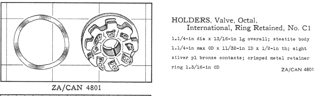

While rechecking the Pin 1 terminal on the underside of the V5A Socket, I had noticed the two rivets securing the retaining ring on the socket to the Sender chassis floor. There was something odd about that, so I decided to look up what the Illustrated Parts List had to say. It would be an easy item to find because the Holders (sockets) for the 813 and this particular 6V6G are the only Holders in the entire 52-Set that are made of porcelain (Steatite).
As expected, it was easily found but the one in my Sender was now clearly confirmed to be a replacement item as well during the 1966 Overhaul. The attached illustration from the 1948 Issue of the Parts List shows this Holder as being of the Ring Retained style, not the riveted retaining plate as per mine. So perhaps the originals were discontinued for some reason, or got too expensive by 1966.
The last photo in this Post is of the Plate after all the dirt and dust bunnies were cleaned off the inside face.
To reinstall this Plate, at least on a Canadian Sender with the Modification Card Holder fitted, the best way is to let gravity help you.
Turn the Sender onto its left side so the heavy side rail of the chassis is on your bench. Slip the end of the Plate with the two tabs carefully down behind the rail and tip the other end in towards the bottom of the chassis. Then press down gently on the long tab at this end until it slips past the partition it fastens to and push it home until you can see the screw holes in the partition holes. Use a small nail, or similar item to centre the two screw holes and install the two screws half way home. Flip the Sender to its right side to put the two chassis rail holed to the top, do the same centering trick and install these two screws carefully home. Make certain, however, that the left hand screw in Photo 1 of Post #854, just clears the chassis rail lip it near. if not, it will hang up on the lip and dig into your bench top when you least expect it. don't ask how I know. You can then tighten the other two all the way.
If you are lucky enough to have a UK Service 52-Set Sender, you will have much better control of the Plate with a finger in the hole intended for this purpose.

Not only is this the smallest of these three PANELS, it is the most miserably hidden on the Sender Chassis.
As noted in my earlier post of the illustrations of the three PANELS, if looked at right side up, the left side Screw Terminal has a white ‘5’ stamped into the panel to the upper right of the terminal. The right side Screw Terminal has the white ‘4’ stamped into the panel at the lower left of the terminal. Are you confused yet?
This small panel is located in the bottom front left corner of the Sender Chassis, just above the bank of three coils, L35A, L33B and L36A. You will first notice the wafers of the R.F. Driver Band Change Switch, S13A, and then catch sight of this panel tucked well in behind it.
According to the Sender Circuit Diagram, Terminal 4 links between C27E, the V5B Plate Coupling Capacitor and Switch S13A. In turn, Terminal 5 joins Switch S13A to C8E, the V5C Grid Coupling Capacitor, R10B the V5C Grid Parasitic Suppressor and Pin 5 Grid 1 Circuit of V5C (6V6G) the Intermediate Power Amplifier. I can make out R10B coming off Pin 5 of the V5C socket and going to Pin 1, which is being used as a connection tag, and that is pretty much it for certain, without a major disassembly being undertaken. Once again, I am assuming all is correct and OK with these circuits as I am getting good, normal test results from V5B and V5C so far.
The attached photo gives you an idea of how nicely hidden this panel is on the Sender chassis. You can see the screw of Terminal 5 to the left, the two smaller, round head mounting screws, one above the other in the middle of the panel and just make out part of the Terminal 4 screw peeking out on the right.

This last photo of the underside of the Sender chassis actually covers where all three of the just discussed screw terminal panels are located.
As you can see, the 4-Terminal panel jumps right out at you when you know what you are looking for, but the 2-Terminal panel in the section just below it is a lot harder to find and recognize. And in between these two in terms of ease of recognition, is the 3-Terminal panel tucked down in the lower right corner, behind the L33A coil.
Why Canadian Marconi Company used these three panels where they did, I still do not understand. I like the idea Chris put forward that it may have provided advantages on various parts of the assembly line for subcomponent assembly and testing, before these items were delivered to the main assembly line for actual installation into the Sender chassis units. There does not seem to be much advantage to them for subsequent maintenance or servicing at the moment. As Jacques Fortin said when I brought them to his attention, if no further information turns up, they shall be added to the CMC List of Secrets for the 52-Set.
