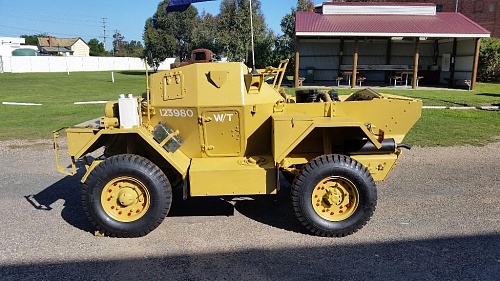

Old 25-04-20, 01:00
Unless there's some really odd explanation it's almost certain your Lynx had the W/T. It was factory applied and visible on every wartime 'repaint' I've ever seen.
Originally Posted by Alastair Thomas View Post
I see that some vehicles have a marking "W/T" on them. Somewhere I believe I have read that all vehicles fitted with a radio transmitter were so marked. My Lynx has a Mk19 set but is not marked in this way. It is true that it has been completely restored in the past so the markings may just have been missed. However, I would like to confirm that my vehicle should have them as the restorer, Mike Ebeling, was most meticulous in all other respects.
Secondly, I have seen in one photograph, a sign "SLING HERE" alongside a lifting eye on the vehicle. This was a picture of a prototype Lynx in the factory. Did this continue into production and would it have been stencilled alongside each of the four eyes?
Alastair
F60S LAAT
Lynx I MkIII*
Old 25-04-20, 01:29
lynx42 lynx42 is online now

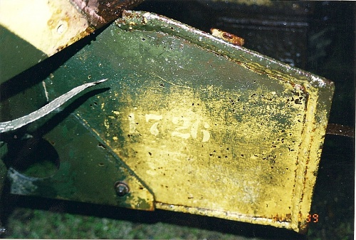

Alistair, before stripping down my Lynx for restoration, I took photos of everything I saw.
The hull number was painted on the leading edge of the petrol tank armour. It was protected by the mud flap.
Name:	Lynx Start to Finish 017.jpg
W/T was on both doors as you can see here.

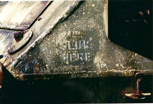

Sling here was painted close to the lifting rings.

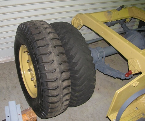

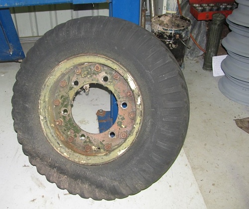

Old 06-09-20, 02:50
Originally Posted by Andrew Rowe View Post
The Mk 1 is 12 spline and the Mk 2 Lynx axle is 16 splines. Lynx 1 is of a smaller diameter than Mk2. The axles from a C8A (maybe F8 as well ?)are the right length but are 10 spline. They have the correct flange thickness and 8 hole bolt up pattern.
Andrew, Lynx 1 Mk's 1,11,111, and 111* all have 6 stud bolt set up not 8. The wheels are like those on the Chev HUP's. The tyre size is also unusual at 9.25" x 16. I am running 9.00X16 tyres as the others are not available.
Name:	Lynx continues 072.JPG
A bit of a difference in rolling circumference, but that shouldn't cause me too many problems.
Name:	Lynx Continues Tyres 025.JPG

Hi Rick, with regards to the axles, I was talking about the axle flange that bolts to the inner hub is 8 bolts on ALL models.
You are talking about the wheel rims, that use 6 stud Wheel nuts on Lynx 1 and
8 stud Wheel nuts on Lynx 2. The 6 stud wheel rims are of lighter construction than the 8 stud wheel rims, which use the standard heavier CMP 9.00 x 16 rim on the Lynx 2. With regards to my gearboxes, I have to find a friendly guy ( meaning cheap !) with a CNC centre mill/lathe? to program the line- boring of the holes and the facing off of the surfaces. All hole and face dimensions are that of the standard Ford 4 speed "crash" gearbox. They are excellent quality castings ready for machining, Calling anybody out there with the skill and equipment! , Cheers Andrew
Valentine MkV
Covenanter MkIV
Lynx MKI and MKII

Posts: 576
Default Lynx Differential
I probably went off on a tangent talking about axles....too much covid lockdown! , I guess if you were talking differentials, there were 3 types for the Lynx, serial 0 to 201 was a 5.83 ratio with 14 &7/8" across the width of the flange housing , serial 201 to 3000 is 5.83ratio and is 12&1/4" across the width of the flange housing, from serial number 3000 the ratio is 6.66 and is 14 &7/8" across the flange housing. This last diff is basically looks like the same
dimensions as the standard Ford 3 ton axle, similar to Bren Carriers, except they use C8A backing plates and the axles are different lengths., Cheers A.
Valentine MkV
Covenanter MkIV
Lynx MKI and MKII
M3 Stuart

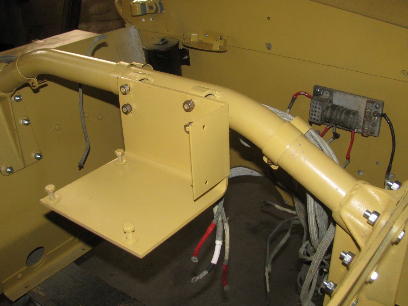

Well this COVID business is a bind. I cannot get to my Lynx nor can I collect the chore horse I bought recently, because of the lock down.
However, I am puzzled.
It is my understanding that the Lynx I carried a chore horse because the dynamo was not up to keeping the battery topped up when the Mk19 set was being used. This explains the uprated dynamo fitted to the Lynx II (and the two speed dynamo fitted to the Dingo).
My question is: where should the chore horse be stowed? The stowage diagram does not mention it and I have not found any Footman loops or otherwise to give me a clue.
Alastair
F60S
Lynx I MkIII*
