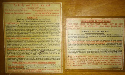

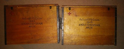

All the quotes I had back to accurately repro these boxes have made it a better bet for me to simply get originals... I only need 4...
Here are two I picked up recently... both are empty, bar the pair of labels inside the lids.
