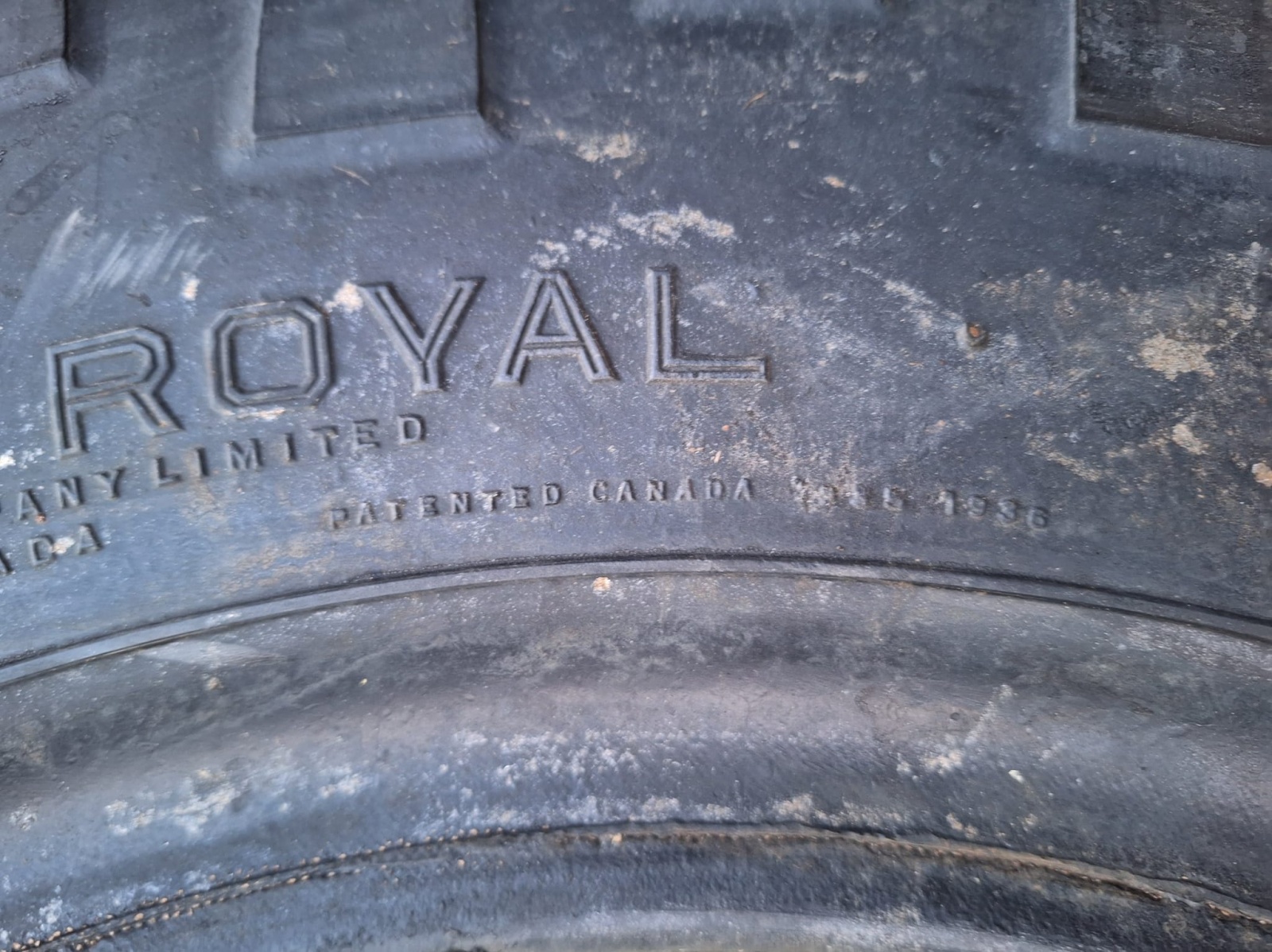

Old 26-07-24, 14:48
Default Dominion Royal Trak Master (#1/2)
Originally Posted by Owen Evans View Post
For reference, An old Dominion Royal 'Trak Master' off my C15. Not so easy to read, so here goes:
Part 1/2: "Lukáš Lukáš" in the Czech Republic found a set of Dominion Royal Trak Master tyres recently. They are still in excellent condition showing many interesting details:
ID:	138095 Click image for larger version
"DOMINION ROYAL
DOMINION RUBBER COMPANY
MADE IN CANADA
PATENTED CANADA"
"TRAK MASTER"
Old 26-07-24, 14:51
Default Dominion Royal Trak Master (#2/2)
Part 2/2:
"FOR BRITISH WHEELS
9.00 - 16
10 PLY-PLUS
2 SHOCK PADS"
And this I have never seen before:
"FOR 1 1/2 [degree] TAPER RIM"
"S2"
Old 26-07-24, 16:09
Posts: 6,017
I've not seen that marking myself. Interesting it is 1 and 1/2 degrees. When looking at the British divided rims, the two halves have a pretty flat or level appearance, but apparently there is a 1 and 1/2 degree slope there.
The American system has tires that have the steeper bead angle , I believe this follows on from the normal commercial tire designs of that period.
Some people have reported as having no trouble with fitting the newer recently made ( Chinese ) tyres onto the British or CMP rims so it may be the case that some of the individual brands are allowing for the different tolerances. I spotted a CMP at Corowa with the Chinese tyres on it and spoke to the guy at length about tyres , he made no mention of having trouble with the fitting. He drove the truck across the Nullabor all the way from Geraldton.
Apparently the CMP C8A six stud rims will accept anything - US or British.
Old 26-07-24, 21:30
Posts: 567
I wonder what "Shock Pads" are ?
Old 26-07-24, 22:20
This is a guess, maybe a bad one....
Possibly a reinforcing layer under the tread, either extra rubber or belts of cord (keeping in mind that most of the (high profile) tires of that era didn't need belts as part of their structure to remain in shape).

Old 25-11-24, 03:56
Posts: 6,017
Default 900-13 tyres
Wartime 900 13 tyres
