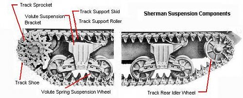

The road wheel rubber is actually solid rubber bonded to a steel rim, this is then pressed on the steel road wheel. AFAIK, the solid rubber rim is a standardized size and would have been available to anyone building e.g. heavy machinery. In other words, the solid rubber rims may fit a Medium Tank road wheel, but the wheel itself is not related to the Medium Tank series.

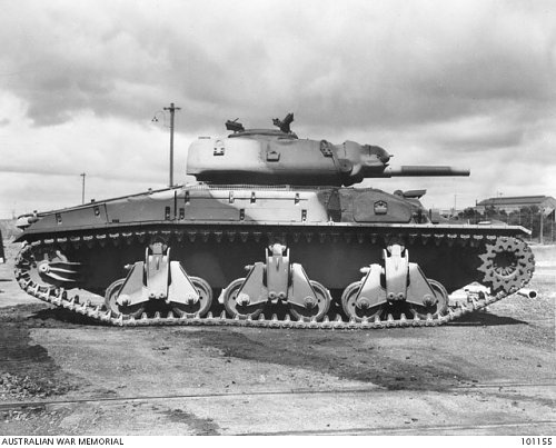

Message from Coldsteel/Michael on tank net regarding this thread.
Message: "Those are Australian cruiser tank road wheels, the outer face will most likely have 4 holes and a grease nipple, the inner face on that type have 6 holes and no greasing point, as seen in the listing photo. The nut and washer match the AC mounting too."

Old 14-06-15, 21:15
Ah yes, that could well be it
