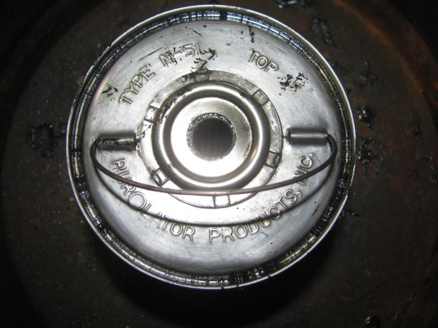

Old 24-01-14, 21:02
Default N-51
Rick,
Here is what you are after. Check the number again on your filter
photos with acknowledgement to G-503 forum where they were found

Default Ok back to the orginal request
Hi All
Rick in your original request yous said "It has a PUROLATOR N-15 cartridge" but the last two post are showing photos of N-51. So would you confirm the number?
Going back to my 1990 Catalog I don't find a N-51 listed but do find a P-51 listed which has a NAPA number of FIL 1100 which should be WIX 51100 here is the link to the NAPA site to the FIL 1100 see if these are closer to what you need. http://www.napaonline.com/Catalog/Ca...100_0297032254 these numbers look closer to your measurements.

Default Closer than I thought.
Looks like the problem is solved Richard.
The number on Rick's old element appears to be N-51.
Bingo!

lynx42 lynx42 is online now
Looks like I need new glasses. I will say that I originally transposed the number in the workshop when it was covered in Black, Black oil. It is N-51 as you can see in the cleaned up photo., Thanks Richard for pointing that out. Seems that we might be able to source one a bit more easily using the correct number.
