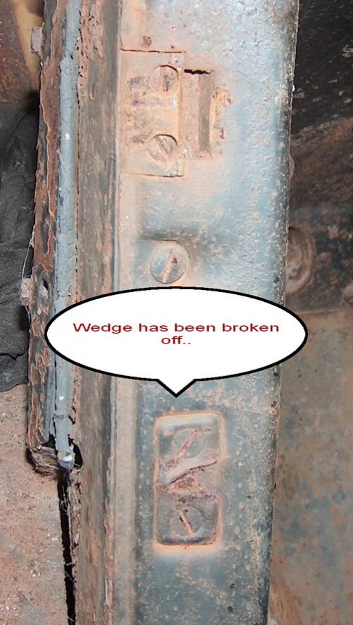

See pictures below.....
The good one is from the cab 11....the bad one from a cab 12......
These Wedge parts are available from Mac Auto Ford......

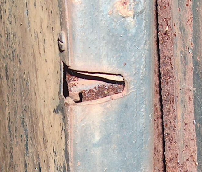

The next Photo is where the wedge fits in the door.... in most cases the sagging of the door has caused some extreme wear of broken parts....
...and the resulting damage to the wedge,,,,,
Now inside the door frame is this ..Ford again... latch which is usually broken...
Now for the latch removed..... in a number of cases at least one of the rubbing blocks willme missing ... having fallen off when the tab broke.
