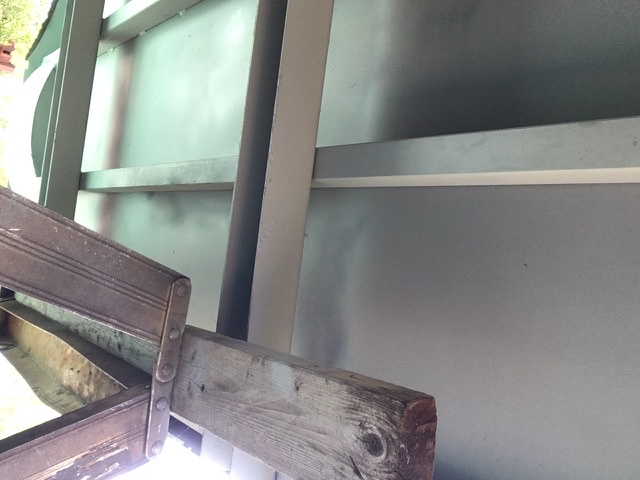

Default hooks
There are 14 hooks total , 7 each side attached to the aluminium roof . They serve as anchors to hold up the penthouse tent . Logicaly that tent goes on the left ( passenger ) side where the map table hooks up on the outside wall . Why they would have hooks on the generator compartment side is beyound me , mere restorer .
44 U.C. No-2 MKII* /

Default More hooks
Hooks on the cypher clerk side of the box . A lot of hooks . Originaly they were set with flimsy rivets and all of mine were gone. I went with 1/4” bolts after enlarging slightly the original holes along the roof .I will be using an awning instead of a tent .
