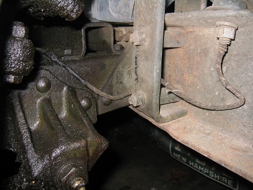

Hi Bruce is this what you are looking for, this picture is of the end of the channel I think you are talking about, on my 1945 HUP pre-overhaul so this has never been taken a part for the any spacers to be lost.
Yes!!! That's the part and the answer I'm looking for....no spacers. This makes sense because first, the HUP engine sits lower at the front so it follows the channel and even the crank guide are lower. Second, had there been spacers I would have attached them (as I generally do) to the part they should be attached to (but strange things happen).
Thank you!!!
