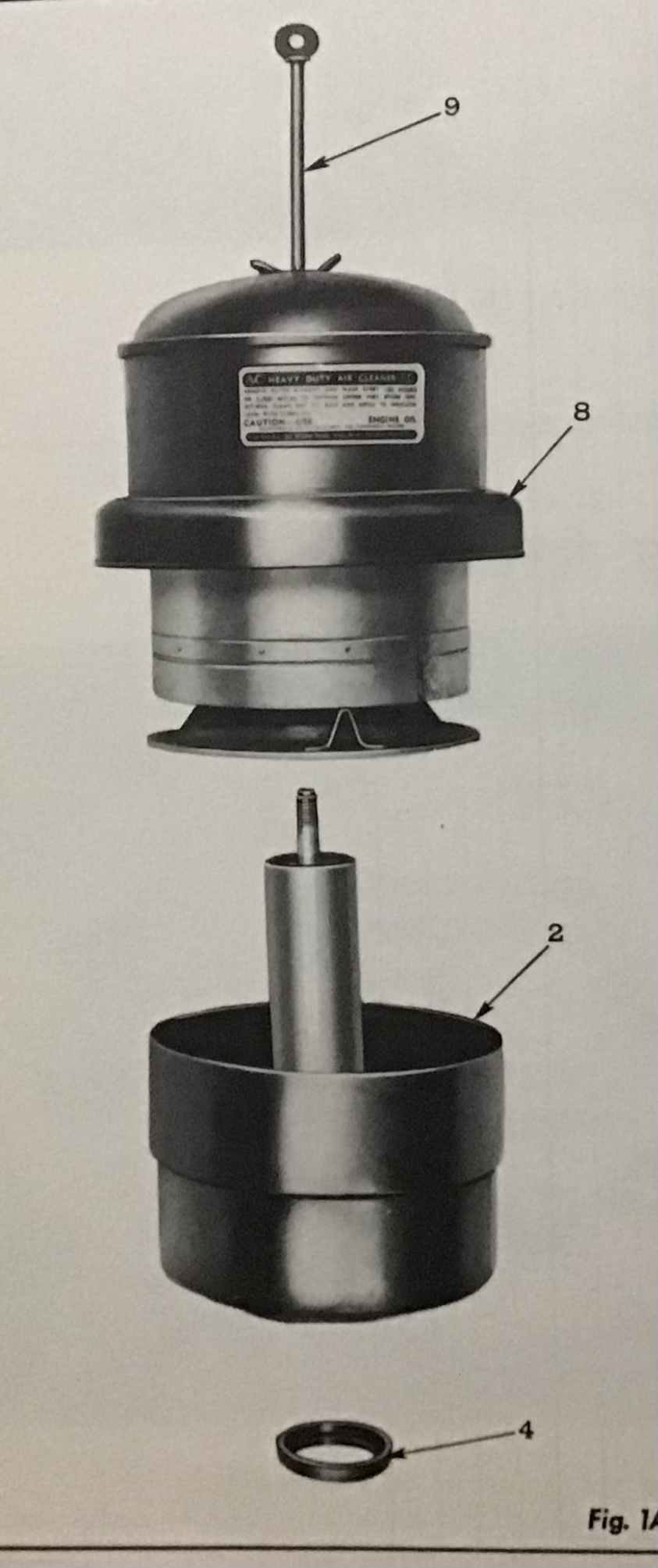

GM Diesel used a few different styles of oil-bath air cleaners, but those used for commercial engines with single or dual air-intakes generally have a protruding flange which interferes with their fit on the military triple air-intakes.
Attached are some images from a couple of GM 6046 manuals with the early (small) and later AC, and Donaldson types.
The last image is a GM 6046 engine which I believe is displayed in a French museum ( images was copied from the internet a couple of years ago, proper credit unknown). It shows the interference issue with a mix of military and commercial air cleaners on a triple air-intake.
A4D2E5E4-1EB0-4C2B-8CFB-66BF100A4AFA.jpeg   BDA772CE-9BAB-4914-9220-8C2AADE0E080.jpg   9AF6175F-245B-4967-AB46-37845B05D37C.jpeg   931953B5-FC9C-40E0-B154-78EB3D705F0B.jpeg

Very interesting! I had not attempted to put this style on a triple air intake as the proud flange looked like it would cause a problem. Does this mean that the body is a smaller diameter? I have access to most, if not all, of the types under discussion and I intended to get to them this afternoon to take some comparison images, but my day did not go as planned (hopefully tomorrow).
Here are some images from 1947 and 1949 GM Diesel Industrial model parts books, and a 1957 Detroit Diesel parts book, showing various evolutions of air cleaners. I note that for both the AC and Donaldson types, the holes moved from the lower housing/shell in the wartime parts books to the upper element assembly in the post-war parts books (that I can access).
9AC7711A-02CD-411A-8A9E-E86B0DC7F94B.jpg   B8566F27-30EB-4A1F-981C-1E7AF590673B.jpeg   7C7A4925-BB4A-4A92-B984-9D9B256965E9.jpeg

Here are some images of two air cleaners which I believe are military for the GM 6046 twin diesels with triple air-intakes, and two which I believe are for Commercial/industrial GM diesels with single our double air intakes.
The ones with flanges pose a definite compatibility problem with the triple air-intakes.
My conclusions: The air-cleaners with flanges could be used with the GM 6046 engines if the flanges are removed and a set of six is available (the military manuals are very explicit that all air-cleaners on a unit must be of the same type).
5BF53A96-2B1A-4B23-9145-B0BC5AC01CD2.jpeg   87C8BC6A-9FEB-49F0-8E31-A1B4AF6BB5D0.jpeg   E74C0DE8-A76F-47F8-B684-41645EB3B0B6.jpeg
