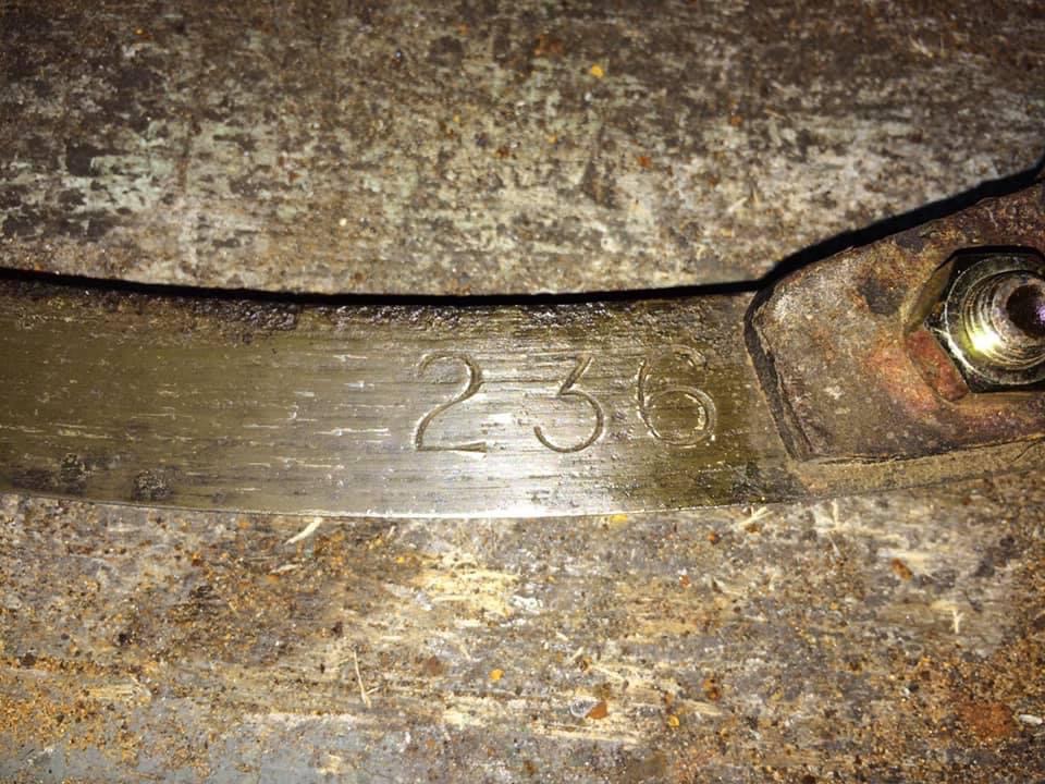

Lastly some interesting stampings found on the turret lower bearing race.
The -010 I’m wondering if it would be a shim size. When I removed the bearing race there were a pile of shims that came out with it. I’ve saved them all. I didn’t measure them but they did look to be about 10 thou thick.
850826E3-7FFF-43EA-A5DE-EACB993CE58D.jpeg   41C6127F-8D79-4149-89F6-86B407FAE34A.jpeg   491394FC-D3B2-45FB-855A-EBF973157573.jpeg   9B15C887-03E1-4D4B-AFBD-D799A978F4A9.jpeg   AA1A9885-4973-4029-91CA-2A4EF1AADC0E.jpeg
