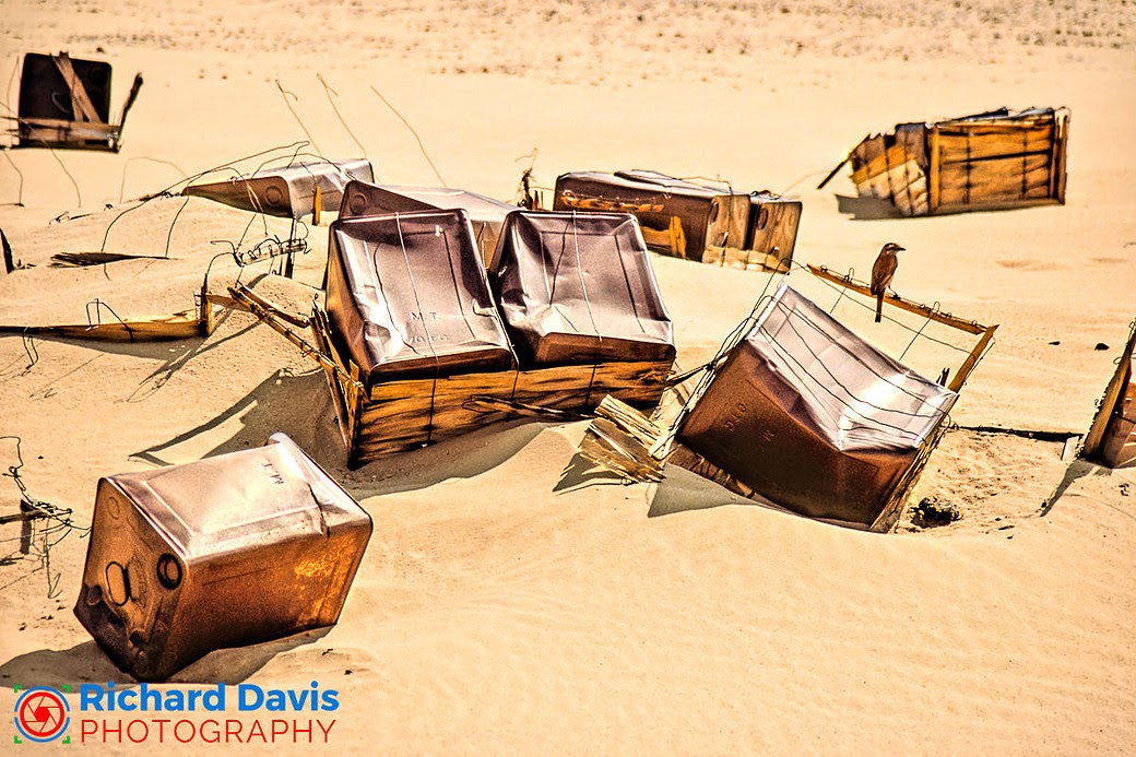

Some additional pictures. It seems that some projection to the Flimsy was to put them in wooden crates. Ron

The other end of the row of Flimsy's left rotting in the desert. I'd like to know the story of what they are pointing to or at. Ron
