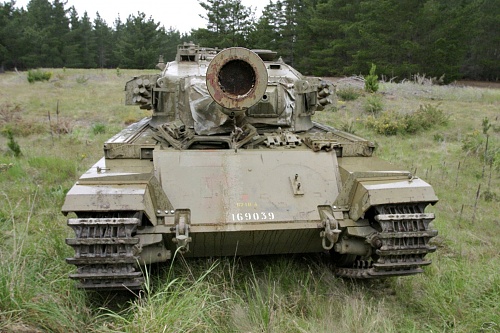

Old 28-11-19, 20:59
jdmcm's Avatar
jdmcm jdmcm is offline
Join Date: Dec 2010
Location: Surrey, BC, CDN
Posts: 672
Mike this is the info on the Christchurch tank that I have:
The tank is now called Maximus I believe but in Vietnam it was "Cromwell" C/S 2 was ARN 169039's last name prior to leaving SVN. 2 troop, C Sqn 1 Armd Reg.Tour date Dec 1970- Sept 1971.

Old 28-11-19, 22:30
Posts: 2,402
Thanks John, interesting to see where 169039 ended up.
I used that period image by Army PR photographer Bill Cuneen on page 301 of 'Mud and Dust'. The tank was named by the crew commander, 2Lt Ian Farrant, who told me during the interview I recorded with him that '...on taking command of 2 Troop, I discovered all four crew members of my tank were born in the UK and therefore thought it appropriate to give it an English name. As an avid military history student I was very much taken by Cromwell as a military leader and thus named my tank after him.'
More from that interview is presented on pages 146-147 of Mud & Dust. Nice bloke: very reasoned in his responses to my interview questions.

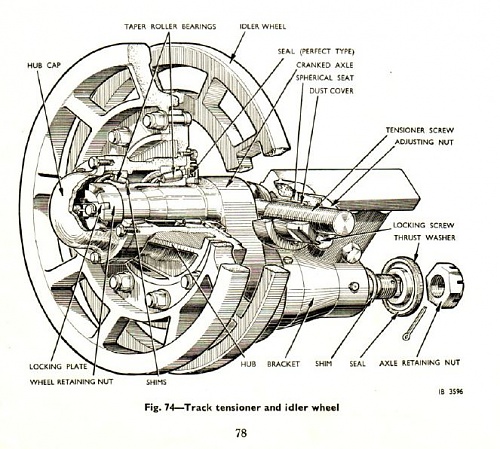

John,
The tracks came new with 108 links. The users manual says when you use up all the threads available on the tensioner trying to set the correct sag, you need to remove a link. When you are down to 102 links, get REME involved.
That's 6 links you can remove, which surprised me since that's about 2.5 feet of track!
We've got 102 links on one track and 103 links on the other, so we're still good, barely.
The problem is when I loosen the tensioner nut off to slacken the right hand track, which is way too tight, the tensioner doesn't back off, even when I drive the tank in reverse. So it's jammed. Looks like I'll need to get medieval.
Malcolm

Old 01-12-19, 04:50
Malcolm Towrie Malcolm Towrie is offline
Location: Whitby, Ontario, Canada
Posts: 306
We got medieval today. Heat, pounding and jacking were involved, but the key step was tightening the tensioning nut back up with a 3 ft pipe wrench and a 6 ft pipe extension. This actually cracked the tensioning screw loose from its spherical seat bushing and with some more heat and jacking the track off the top of a road wheel with a 20 ton jack, we got the tensioner loose enough in the seat that a quick application of right hand neutral steer would pull the tensioning screw back.
The pic below may make my description easier to understand.
Malcolm

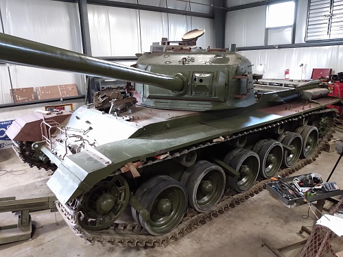

Default Centurion update.
We're restoring a Canadian Centurion at the Oshawa Regiment museum in Ontario, Canada.
I wanted to give an update because it's actually starting to feel like we're getting somewhere!
She's running and driving with the rebuilt Meteor we got from the States, although only inside so far due to my reluctance to get clay mud all over the undercarriage when we are in the process of cleaning and painting it.
The engine starts really well. The key is not to use that stupid choke plate (aka strangler). God knows why that is installed. All that happens is the full intake manifold vacuum acting on the carbs sucks huge amounts of fuel through the main jets and because it's an updraft carb, none of this fuel gets up into the intake manifolds because the choke restricts the air flow so much, and it all dumps down into the plenum and pours out of the automatic plenum drain tubes. Rolls Royce designers obviously weren't idiots so there must have been some logic behind the choke design but I don't know what it was.
Anyway, I have a electric priming pump installed to fill the carbs to save the hassle of using the rather inaccessible priming levers on the installed fuel pumps. After that, 3 or 4 pumps on the gas pedal (which does shoot gas up into the intake manifolds) and she fires right up.
The clutch rebuild showed the massive plain plates and friction plates were all still in spec, and only a couple of new bearings and seals were required. It works well and is much lighter in operation than I expected.
Steering, including neutral steering, also works very well, which is a relief as all I did with the transmission was remove the top covers to do a visual check of gears and shifter mechanism. All looked good and fishing around the bottom with a magnet picked up no worrying pieces, and oil was clean. The final test will be driving it around the arena to confirm that all gears are there and shifting is manageable.
One thing I noticed is that there is a shift lock-out mechanism (to prevent the selector mechanism from trying to select two gears at the same time) in the gear selector box up in the driver's compartment, and also in the transmission. So it is very important to synchronize the two lockout mechanisms so that the driver can easily select each gear. I don't think the manual mentioned this requirement.
Right now we are in external bodywork repair and painting mode. Some track guards were beyond repair so new ones were fabricated. All the side bins were really rough too so repair (cutting, patching, grinding, and painting) is in progress.
I should say at this point that, like most museums, money's a bit tight, so management encourages the use of free internal labour to fix stuff, rather that farming it out to a local fab shop. And when I say "encourages", I mean "insists". So we don't always achieve perfection, even though we aim for it.
The photo below shows our progress so far.
Even though this tank is nominally Mark 5/2, it came with the full gyro stabilizing power elevation and traverse (which I believe was a later Mark?). It looks quite intact so my personal dream is to get this working and have the only tank at the museum with functioning gun stabilizing. Time will tell.
Malcolm
