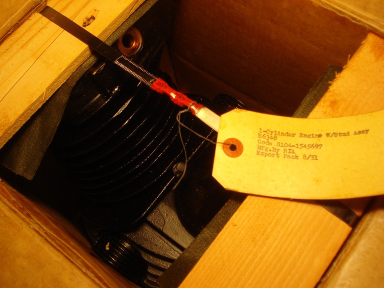

To follow up my last post on rear main bearings I offer a photo of the -46 version, as I have done for most of the other main parts. Note the much heavier flange area. For those not familiar with workings of these engines, the bearing flange sits flush in the crankcase but the projecting threaded portion supports the camshaft.
On another topic, a couple of photos of nine mystery boxes, dug out of storage after almost 70 years...what could they be??
All export packed in waxed cheesecloth over heavy cardboard cartons...
very nice indeed!

A beautiful sight for a Sherman enthusiast!

A beautiful sight, indeed! The military packing used back in the day was incredibly good quality.
We had a couple of visitors come by the museum from BAIV, a military restoration company in the Netherlands. When they saw our wrecked Sexton R975 on display, they said the cylinders are going for around 2000 euros each now! So good find.
Malcolm

Malcolm, your appreciation is very much appreciated! Also a very unique smell as they were packed with thick heavy grease inside and outside.
I want to share a few pictures with you, reminiscent of those showing your beat up Sexton engine. This was a motor I tore apart, it looked great on the outside but not so great inside. You can see half a fractured link rod that was laying inside the motor, the piston was smashed to bits, I took out a couple of handfuls of aluminium chunks and look at the smashed up crankcase and the hole/slot cut right through the cylinder base as the rod came out! I suspect this was hydro static lock up induced, as it was a bottom cylinder right beside the oil sump. Must have been noisy for a few minutes as it disintegrated!
B.P.
