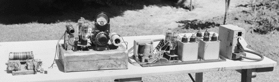

I was skeptical of glowing mercury vapor rectifier valves in the YouTube clip, thinking maybe Hollywood had intervened to make it look good
Then the remark of using a car generator also puzzled me as I suspect no man has the physical capabilities to drive a generator to produce any usable power
The photo from the war museum (thanks again Mike) has solved some of my questions
Name:	Winnie the war winner.jpg
On the left is the antenna tuning unit (which they were soldering in the clip) then the transmitter itself contains 2 (no less ) 807 Valves (quite a monster)
Then the power supply with the mercury valves producing around 700 or more volts, and the most significant part is the small metal can on the left end in the front "A vibrator" This explains quite a lot
On the right is a control box and possibly the Morse code key
The persons who built 'Winnie the war winner" certainly knew about radio
I salute them
In the movie there is a 6 volt battery, I would think the reference of a "car generator" was used to charge it. I still wonder how they turned that "car generator"
This is a TRANSMITTER, so where is the receiver?
cheers rod
