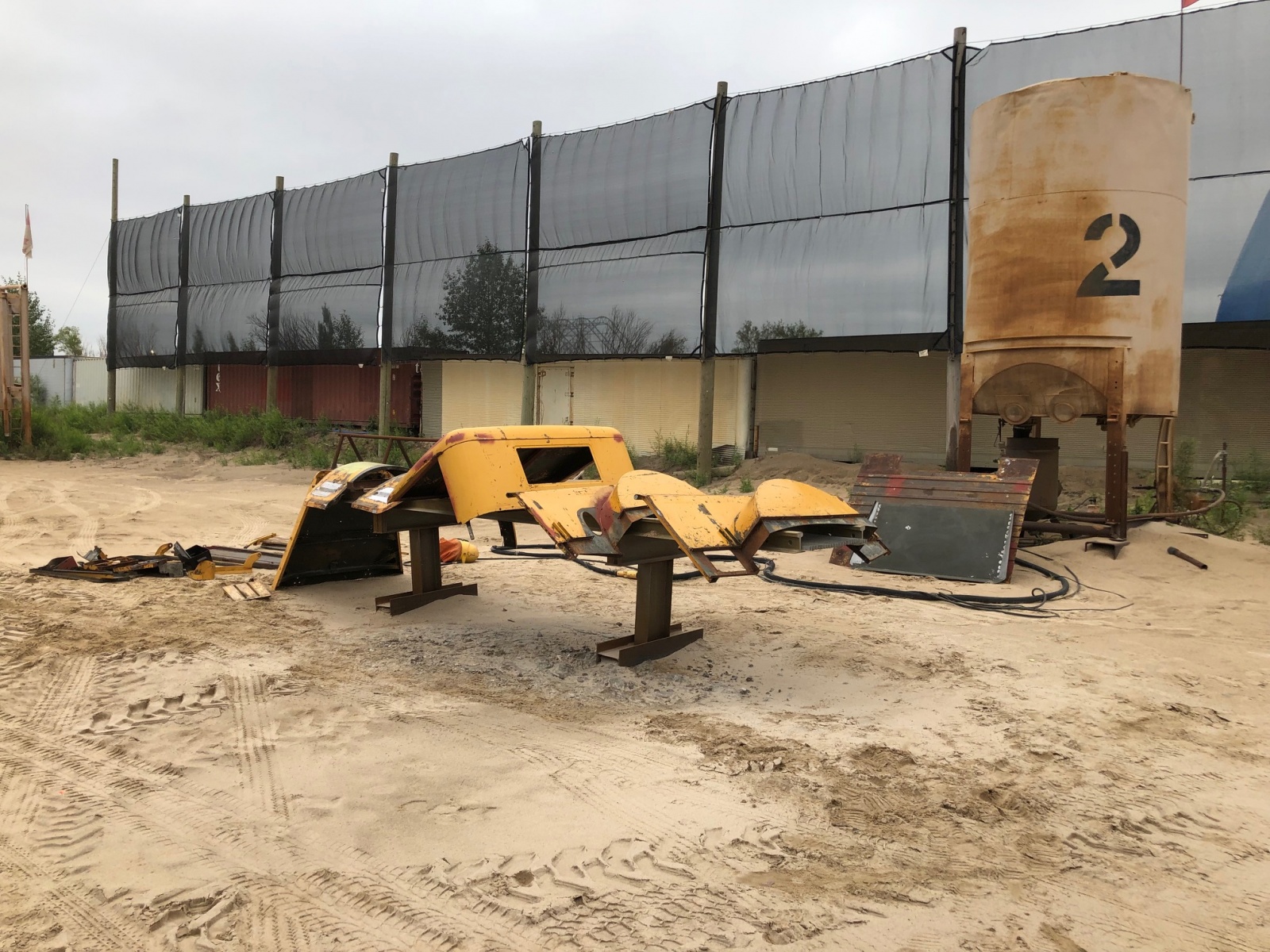

Old 09-08-19, 01:13
Wayne Hingley's Avatar
Wayne Hingley Wayne Hingley is online now
Posts: 743
Default Micky Mouse
Mice had built a nest in the insulation between the cab roof and the inner headliner. The mouse piss and moisture did quite a number on the metal in that specific area. I had considered cutting out a section of the cab roof and trying to match up and weld in a new piece of rounded sheet metal, but decided I’m not talented enough to do that without making a mess. The best option for me was to repair the area with fibreglass after a light sandblasting of the inner surface. It was a quick and easy repair, and turned out pretty good.
4B7A5BC3-2AA0-4848-B725-7EC3701B2AB6.jpg   6DAA4D6A-72F0-4A0D-B0BE-C4925C631D06.jpg
1953 M37 CDN
1953 M38A1 CDN W/WN
1967 M38A1 CDN2 W/WN
1968 M38A1 CDN2 W/WN
