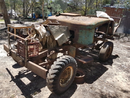

Default Cgt?
It's a C15A retrofitted with a winch.
Old 25-01-19, 12:35
Default You tell me
Could well be, though the owner notes "bigger diffs as its a gun tractor"?
Chev blitz gun tractor 101 inch wheel base$800
Has hi and lo 4x4 and bigger diffs as its a gun tractor
In pieces
Has pto winch
spare gearbox and engine in bits
Old 25-01-19, 22:09
Default Hmmm
He is incorrect. You can see the C15A type handbrake cables in the rear backing plates, and the CGTs we had here were built before the bigger steering ends were in production, the diffs are all the same size physically of course.
There's no evidence of fairleads front or rear. Of course it would have been refitted with a two speed transfer case to use the winch. This is not an uncommon conversion. The ultimate test is to ask for the chassis number and I bet it's 8444...
To quote a famous Australian movie: "Tell him he's dreaming!"
Old 26-01-19, 00:16
Thanks, so it is just another case of a 15-cwt retrofitted with a winch, as so many were post-war.
