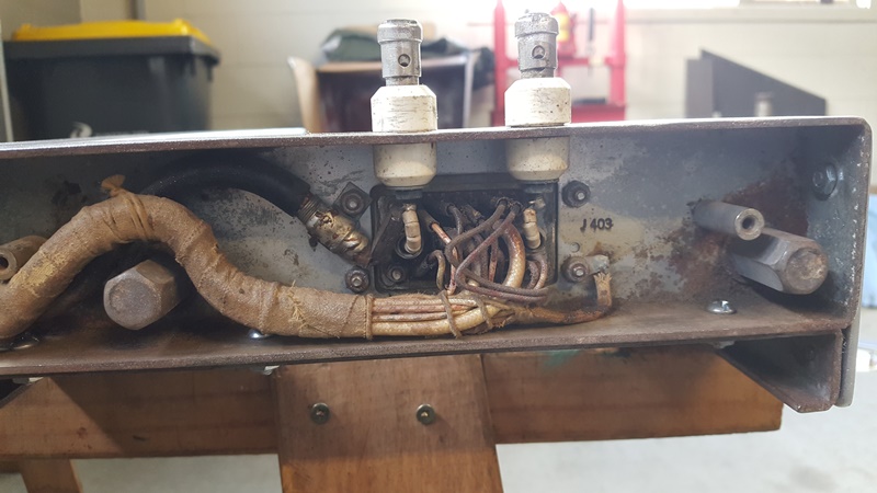

I’ve done a bit more work on the generator. Things were progressing nicely until I realised that the repair kit I had was for the Ford generator and not the Autolite generator I have. I am on the lookout for the correct kit now....
After a light brush down, the field coils look too be in good shape. They appear fine electrically but will let the auto electrician confirm that when I get it all to him. The armature and commutator also look fine at this stage. Apart from one new bearing which I need to fit, the enclosure and end caps are ready for the reassembly.
I still need to rebuild the ceramic plate that insulates the posts from the enclosure and find another stud to replace the broken post. I also need to confirm what exactly is in the breakerbox that is attached to the side of the generator. Does anyone have any photos of the inside of this? I have a circuit breaker and a thick short cable but that is it.

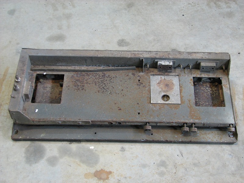

I started work on the FT-237 radio mount and the radio and interphone bits and pieces. The plan is to get all this working before it goes into the hull. I understand the radio mount should be unpainted and just retain its original zinc finish but the steel on mine was pretty corroded and rough in places though so I after I removed the remaining paint and cleaned everything up, I painted the metalwork a zinc colour. I don’t think it looks too bad.
A couple of the toggle clamps were a bit bent but I heated them and straightened them and they are pretty good now. Two of the wee springs that go on the clamps are broken so I am on the lookout for replacements.
The wiring on the mount actually looks reasonably good so I will just test it and confirm. I have some assembly instructions for the wiring of the interphones coming from a supplier in France. The TM manuals don’t show the colour coding for the interphone connections to the terminal block on the FT-237 and the old wiring was too far gone to work out the colours. I have cleaned up the terminal board and will reattach that now pending the connection of the cabling and testing.
Still to do is tidying up of the data plates and the two posts on the left of the mount. I painted the brass plates black and will scratch away the paint on the embossed lettering.

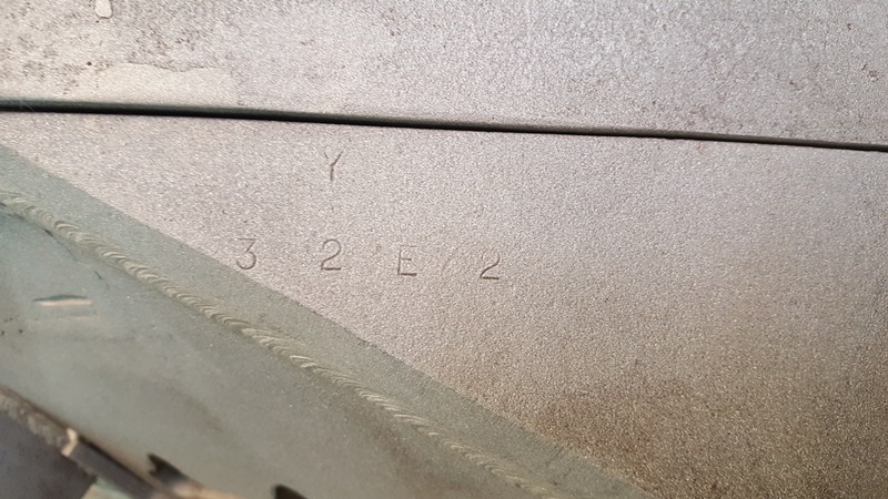

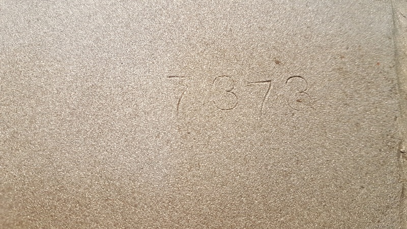

The sandblasters have started on the M8 so I took the opportunity to check for serial numbers before they put any paint on it, to see if I could learn a bit more about the hull.
As I previously mentioned, the ordnance serial numbers ‘7373’ are in each lower corner of the front hull. These were nice and clear. I was hoping to locate the other number on the front armour plate in the centre below the front hatches. The metal on the hull here is quite rough and I could not make out a lot out with any certainty. I thought I could see a ‘6’ but then again it could have been a ‘C’. I took some pictures of this area but even blowing the photos up didn’t reveal anything. Whatever was there was very hard to see and nothing like as clear as the ordnance serial numbers on the lower front corners.
There are a range of other numbers on the hull in various places. There is a series of numbers on the top of the hull at the rear above where the radiator is. There are other numbers in the front armour which I figure are plate drawing numbers. All in all, not a lot more learnt!
I’ll send through some more photos once they’ve got some paint on the hull.

Looks great, try shining a bright light at an oblique angle to see if the numbers come up better. Good lord you will have to remove your shoes before climbing in that M8 it is so well done.

I had another look at the hull today after they put the primer on it. As you can see, we dropped the turret ring down enough to blast between the surfaces, and get some paint in there.
Some of the other numbers on the vehicle became more apparent with the coat of primer on it. It’s amazing how a coat of paint transforms the vehicle!
After we looked closely at the front armour we can see that a grinder or similar has been used in a number of places on the front armour; the middle panel where that other serial number would be, and the top panel. You can actually see some of the dips in the surface from the grinding, and it appears that other number has been ground away. The lower panel where the Ordnance Numbers are shows no signs of any grinding.
I guess there could be a few reasons for the grinding but it was certainly done some time ago and prior to at least the last coat of paint it got in its service. Maybe the hull sustained some frontal damage at some point and the steel was repaired and grinded smooth. Who would know….

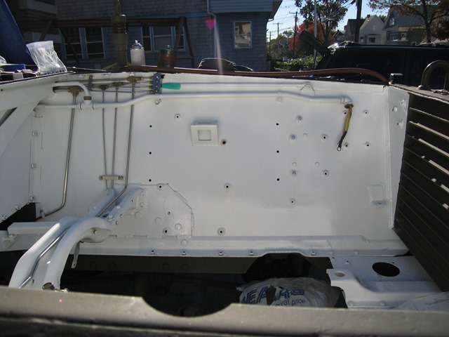

Hi all,
Just a few more progress photos along with a funny story.
The gloss white has been applied to the interior of the hull. The hull is being masked off now in preparation for the OD to go on. Unfortunately there is a problem with the OD paint and the finish is not matt! We are talking to the paint supplier now to see what has happened there. Hopefully we will have a resolution soon.
Back to the funny story. There was a major scrub fire last night in the suburb of Burnside (how ironic!) in Dunedin. It raged for about 6 hours and took out a few industrial buildings, pine trees, and damaged some homes leading to the evacuation of a number of residents.
The sandblasters where the M8 is being painted, are based right in the area where the fire was! The fire got to about 100 metres from their premises, but fortunately did not get any closer to the building. If it had reached the nearby LPG gas bottle plant, things might have been different.
The guys had to clean all the ash and soot off the hull this morning before starting the masking.
As you can expect, I was sweating on things for a while but it appears that on this occasion, the gods were smiling on me….
