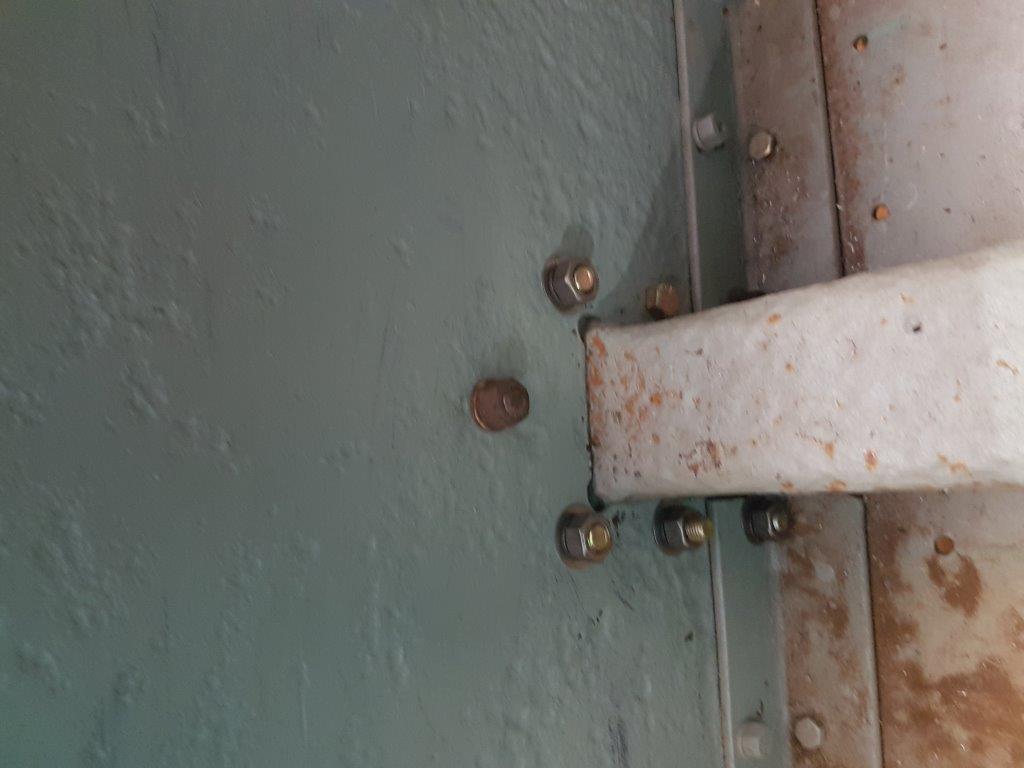

Originally Posted by Israel Berko View Post
long time since my last updates,. . .
Now my question is what are the Bolts (also length) and Nuts size for the engine mount? Thanks
TL 12119, Piece, engine bearer, two required
TL 152, Bolt - 5/16" B.S.F. x 1" hex. head, eight required
Page 102 of FUC-03.

Installed Drums and Shafts - rear axle, and rear BOGIE.
and some othe preperations for next parts to be install,
20171202_104824.jpg   20171202_104807.jpg   20171202_104430.jpg   20171202_104422.jpg
